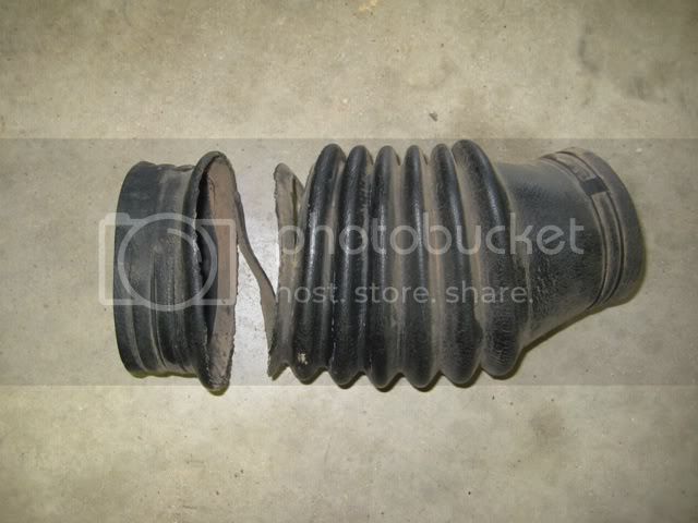

What have others used to replace missing air cleaner inlet (part# 17751)?
Looking for custom application ideas...
How about a piece cut from the end of a rusty air cleaner, at the other end of the hose, then turned around with a mounting tab welded to it? :idea:

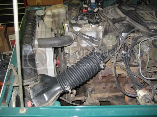

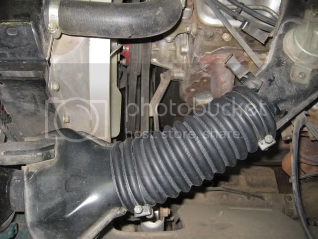

+1, here is mine installed on my 1980:
For comparison, here is the stock original that it replaced (minus the duct tape that was it holding together):
Well worth the money to me to have a nice bolt-on solution and not to have to shop for the right diameter and etc. Thanks BTUMAN.

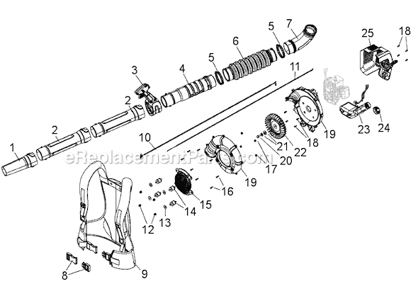

I was in Lowe's the other day and I saw a TroyBilt backpack blower on display. I was like, :idea:
I didn't get a chance to measure it, but check out #6, "Flex Tube":
$13.88
Troy-Bilt TB2BP Parts List and Diagram - (41AR2BPG966) : eReplacementParts.com
I bought a piece of tubing from BTUMAN and it's damn close, maybe a little long.
BTUMAN said:
I ordred twice the bulk commercial material and will make more sections. Taking orders now for shipping next Monday. My PayPal is d.todd.gatewood on the gmail site. $25 flat to lower 48 states PM me for other shipping cost . Still less than $10 more than that paper thin stuff at AutoZone or OReily and it looks as close to factory as I have ever seen. I will take better than phone pictures soon for those who need more info.
Still have some left for those who still may need it.
