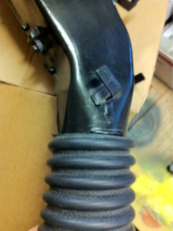

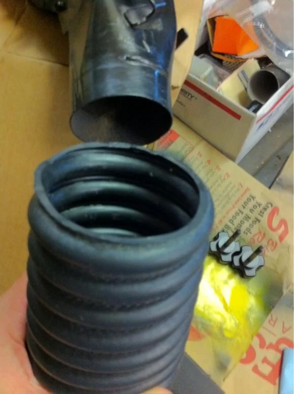

Great news, the material is in and it is a near perfect match to the look and specifications. Heavy Duty, Rubber, Crush Proof, Rated to 400F. The only way I belive you could tell the difference is that it is corregated to the end rather than smooth on both ends like the factory. I should have it installed this weekend and will post pics. I estimate these will cost $25 plus the ride. Much better than the $20 for the stuff from Autozone or dryer vent pipe. Here is just a first look.
