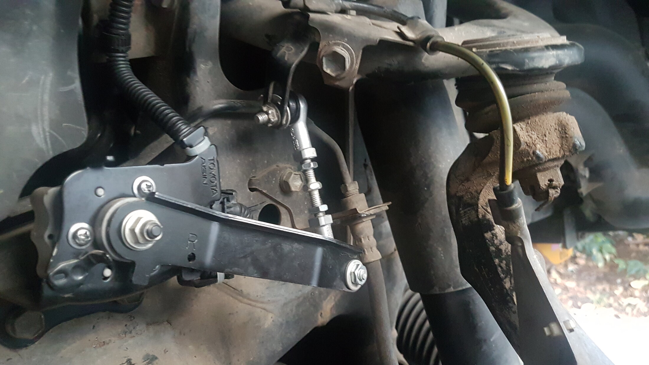

I jacked up the car and shortened each of the height sensor rods. And when I let the car back down off the jack and turned it on, the whole front end immediately dropped to the bump stops. Height showed as "N" and would not go into "H" or "L". Tech Stream, was getting a reading of FR +3.2 in and FL - 3.3 in (obviously not good). Prior to adjusting the rods, everything was reading normal (+/- a few tenths of an inch at "N" with about 19.25" b/w center hub and fender) and the car went up to H and down to L flawlessly.
So here's where I think I went wrong (kicking myself). When I adjusted the rods, I removed bolt circled in red in the screenshot below to more easily adjust the rods, and didn't realize that the sensor arm seats onto a rectangular piece. When I re-attached the arm, I did not seat the arm into the rectangular piece and simply tightened bolt. I'm assuming that once the car was lowered off the jacks caused mechanical damage to the sensor.
I realized my mistake and reseated the arms back onto the rectangle but the readings didn't change and car is stuck with the front end on the bumps.

The arm is keyed to the sensor and can only fit one way. I would test the sensor per FSM. Temporarily, you can try disconnecting that sensor alone and restarting the vehicle. It might just rise to normal height as it did for me.

Thank you! I will try disconnecting the sensor that seems off and see where the truck levels out to

This worked! Disconnected the front right and the vehicle raised back up.
Ordered an AISIN replacement.
Thanks again!

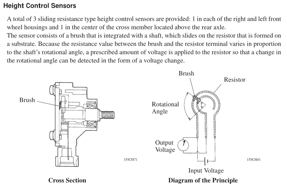

Attached is series of ten (10) too-much-information, all-in-one-place pictures describing Height Control Sensors in case they are of interest ....
As an aside, AISIN are a supplier to Toyota/Lexus -- and Toyota owns 24.8% of AISIN -- and so unsurprisingly Toyota/Lexus OEM Sensors often are stamped "TOYOTA AISIN" -- or at least the original Japanese factory-installed Sensors were marked this way on my 2006 vehicle, and so were the more recent replacements. As advised above by @hoser , if reliability and longevity are important, avoid the unhappiness that goes with other substitutes.
