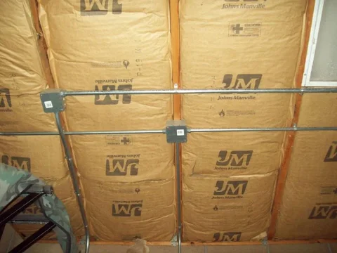

Tired of fixing fallen batts, what is this stuff and where can I find more (comes in 50" wide rolls). Looks like the ticket. Up for other suggestions as well.
Its the heat just baking the s*** out of it....Sheetrock it you friggin farmer and cut your losses....:lol:
what about using bird netting ? pretty cheap, wont hold moisture and you can see thru it if there's any problems .
Sheetrock would be a pita due to the conduit, I figure I could just remove the straps, loosen the boxes, and slide this stuff in and staple. No moisture problems here.:hillbilly:

I would put furring strips, bigger than the size of the conduit, and sheet rock it.
More work, but the best solution.

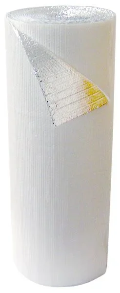

Or that foil stuff in the first pic. It is a heavy cardboard with a foil laminate on both sides, figure it would reflect heat both ways, which could be a plus..

Metal panels will sweat unless the underside is completely encapsulated, which yours is not and even the typical reinforced vinyl back metal building insulation only offer enough strength to keep it in place, since it does only marginally.
In this instance, almost need airflow to occur in the highs of the panels, or in the cavity that the insulation currently fills with eave and ridge ventilation.
I've pulled many professionally installed roof systems with intricate insulation systems below, to find mold and moisture on roofs that leaks aren't a possibility. Once it begins to accumulate, there's nowhere for it to go, so it builds up until the itch discolors or falls.
The right way to do metal decking in an instance similar, is using the vinyl back between the panel and substructure, since it allows for the most economical vapor barrier, then venting the highs of the panels at the eave and peak.
If further insulation is desired, drops or rock with an attic like, vented cavity are the norm.
I'm not a fan of the spray foam from a professional perspective, but in this scenario, as with most retros, it's probably the most cost effective option.
Until the underside of the metal panels propensity to condensate is addressed, there's little else that will be worth the effort, since it'll only be a matter of time before the water table rises in the cavity and similar results occur.

Consider "double bubble", if maintaining all as is.
Either that, or get 1" metal banding from a metal building supplier.
They make pointy pieces of spring steel that wedge between the joist and hold the insulation in place.
Quick and easy solution.
The electrician really f'ed the homeowner on that job...but my guess is, they are one in the same.
Why in the hell wouldn't you use romex and just drill the rafters/studs?...animals?
A lot of places, exposed romex is not allowed. It would not be much work to drop it all down to put up panels but the wire pieces work great. BTW, they are great drill bits for when you need to the hole like between floors when running wires.
Yup, vermin.
Job was back in the early 80's thought that paper would hold up longer that this.
