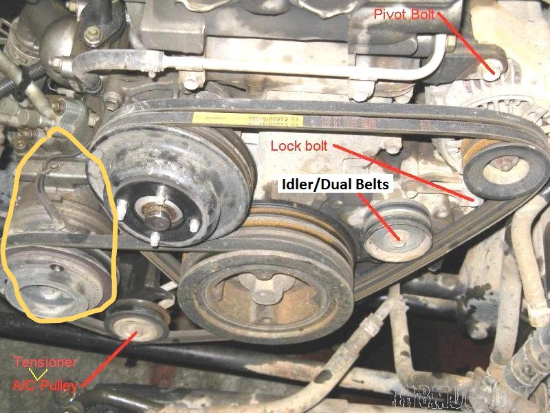

Is what's circled in yellow called the AC compressor? If I am to replace it with new OEM, are there any associated parts I should also be replacing while I'm in there?
