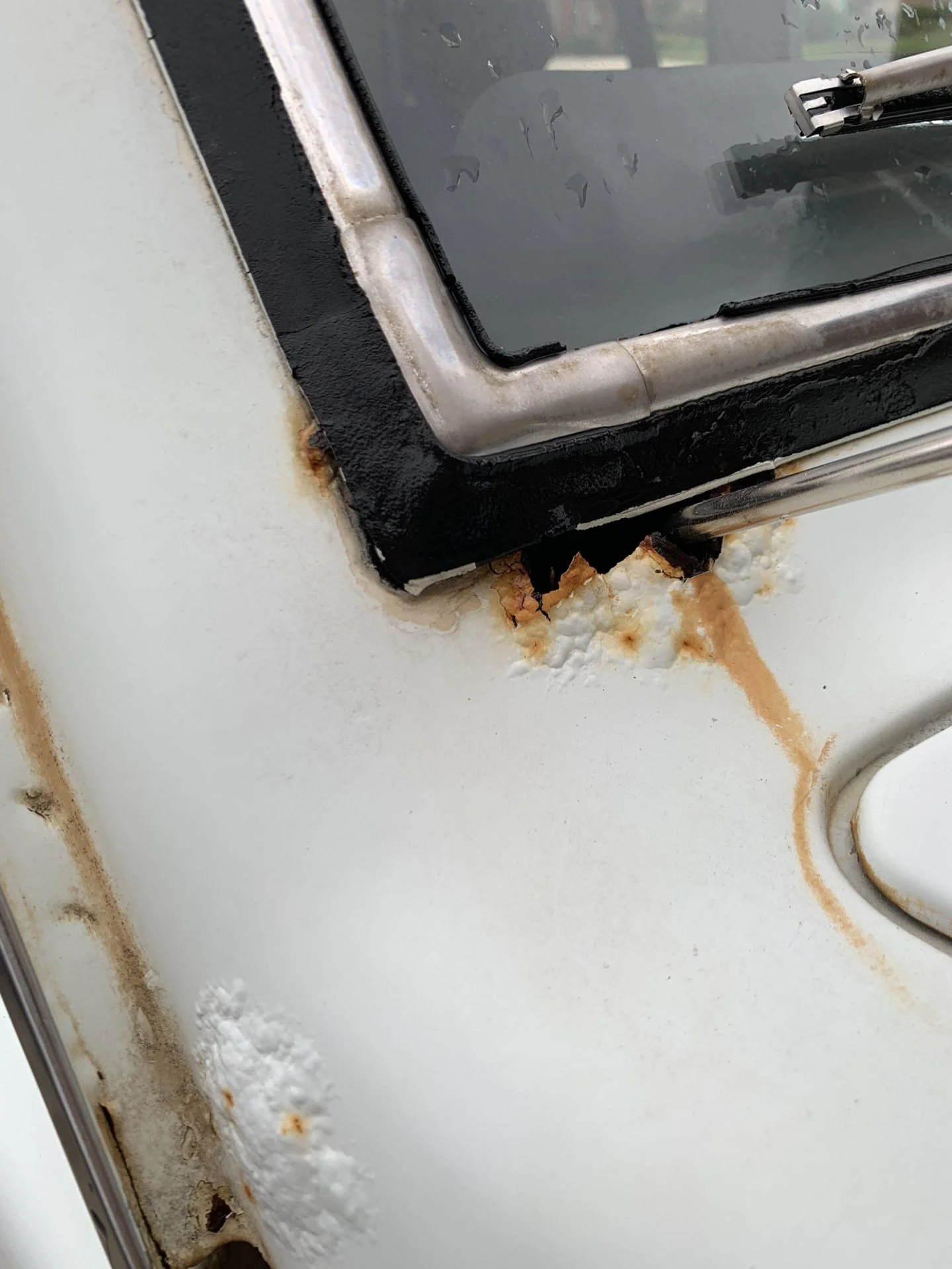

Thanks everyone for the positive comments. Now that I have seen the rust up close via FaceTime and close-up photos the body work will certainly be more involved than I had anticipated. I guess many of you guys have already been through that process though and came out the other side. I'm going to use a wire brush, gallon of Corroseal, and some rattle can paint on it for now. It will go into a 10 x 20 storage unit when we are gone. Hopefully that will slow things down a bit.

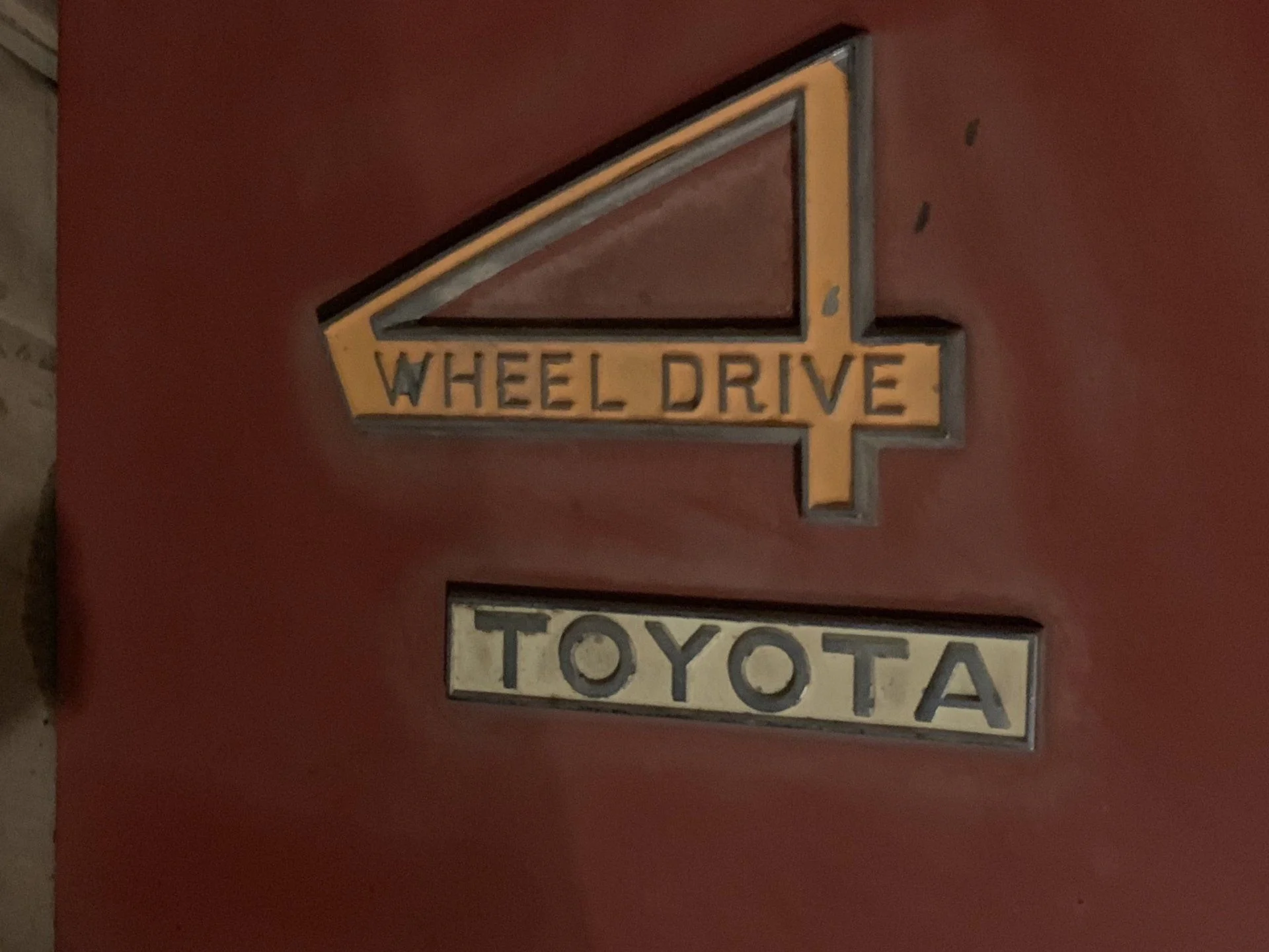

77 was the transition year for Pigs. You have the best year. All the right stuff. Stamped tailgate. Square windows. Small tail lights.

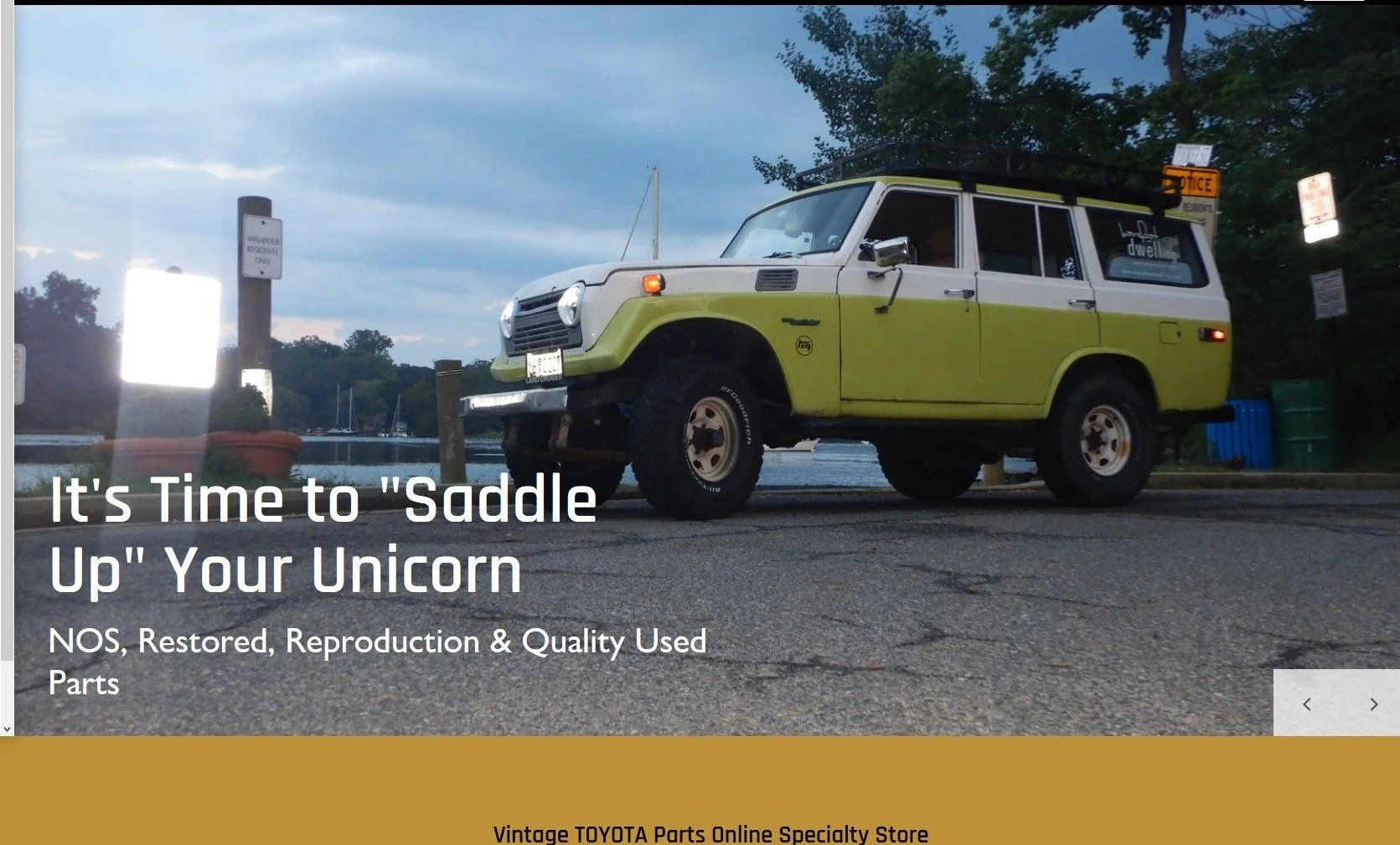

@WarDamnEagle it's Time to Put a Saddle on Her ............................ :)

I've got a late 77, and no TOYOTA stamped tailgate. I am sad about that.
A question about the TOYOTA stamp, were they ever painted the main color or were they always the color of the surrounding area (white for most pigs)?

Drove the pig this morning. Drives really well but manual steering is a bit of a pain in a tight parking lot. Mechanicals seem to be in really good shape but body will need some TLC. Frame has some surface rust but absolutely solid. There are half a dozen or so rust throughs but body is rock solid right up to the hole.

Glad you are happy I recommend highly that you treat and coat the body and leave it alone. You start digging and you are not going to like what you find.
I like patina on a late Georgian mahogany secretary as much as the next guy but I'm not really into the whole patina car thing. I'm leaning toward an E Coating process with, of course, all the metal repairs that are exposed after the initial stripping. Cut and paste from one shop's website:

I assume any metal repairs are done after the initial baking procedure? Plan to call this particular shop (in Louisiana) this week to get more information.
For now though, it will be treatment with Corroseal as it will be at least 3 years before I am ready to tear it down. I am extremely pleased with the frame, just a bit of surface rust and frankly the body looks almost rust free from underneath as well. I don't think the vehicle has seen much, if any, salt. It's also interesting when you examine the rust throughs. The metal is solid right up to the edge of the hole. It's almost like you used a torch to make the hole.
