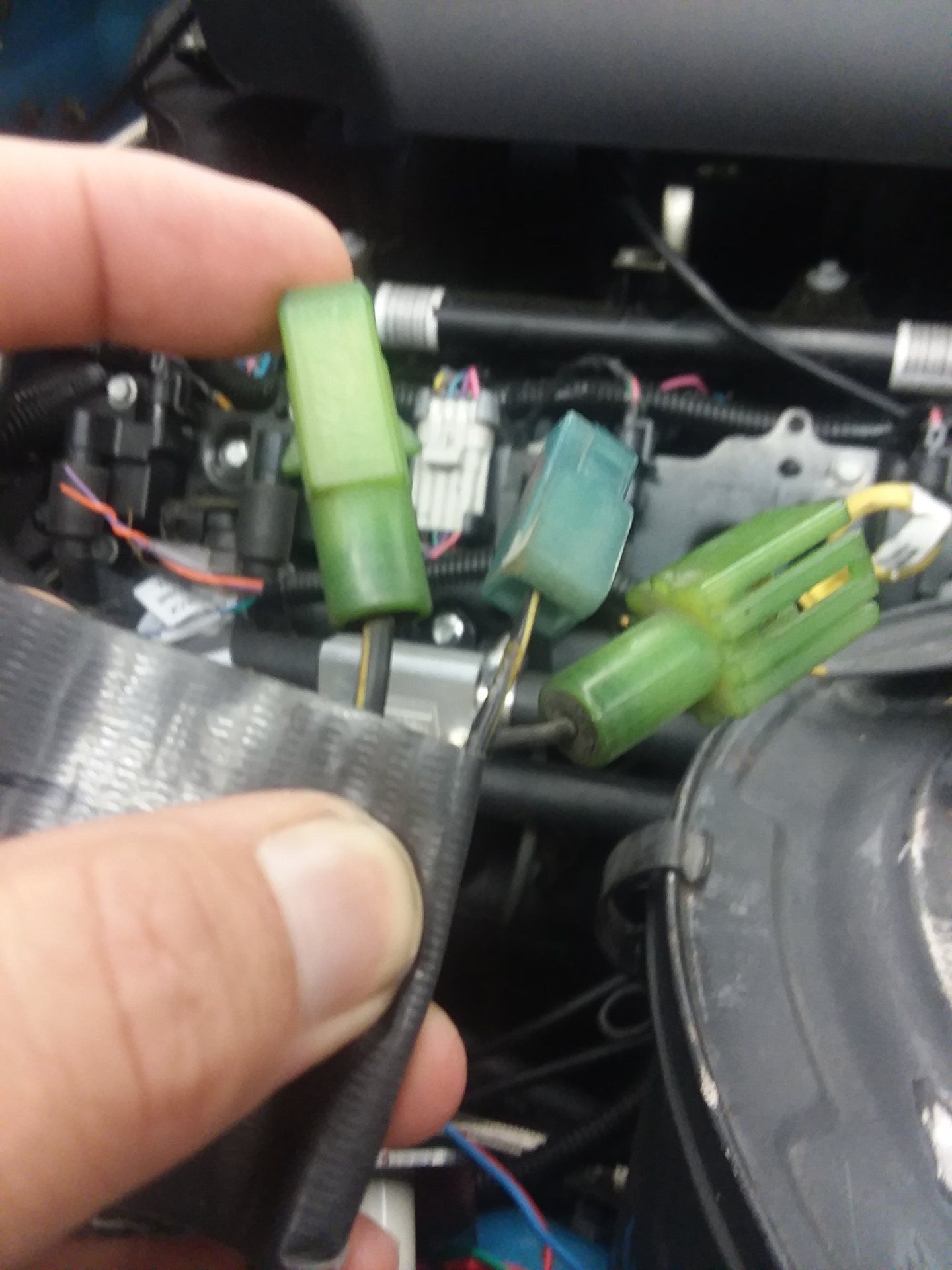

My buddy Jeremy helped me do the diesel swap. He wasn’t too excited about wiring and so we had a shop get the basics done. I’m sure they saw it was an adequate size wire for the ignition and robbed it instead of running a new one. If I’d of had more time I would have done it but that was last year and wanted it running but it Snowballed from there. It’s okay I’m learning now. It’s been a year and a half automotive shop class:rofl:
Thick black with a yellow stripe should be the ignition source it would have been feeding ignition to the factory 60 coil

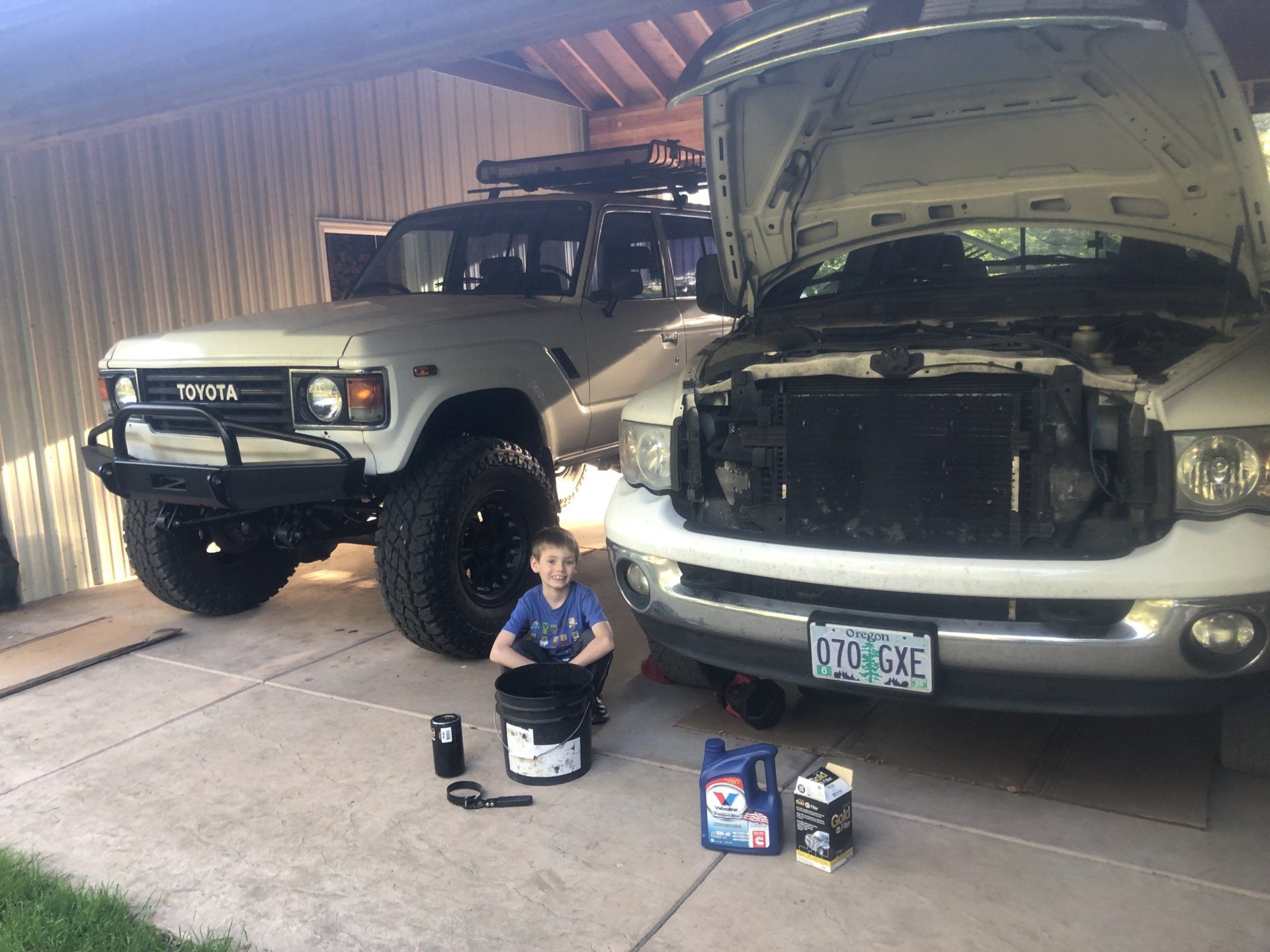

Teaching the boy how to change the oil. My dad taught me about wells and pumps. Didn’t ever get into vehicles until I got on my own and until I decided I wanted to do a diesel conversion on the 60.

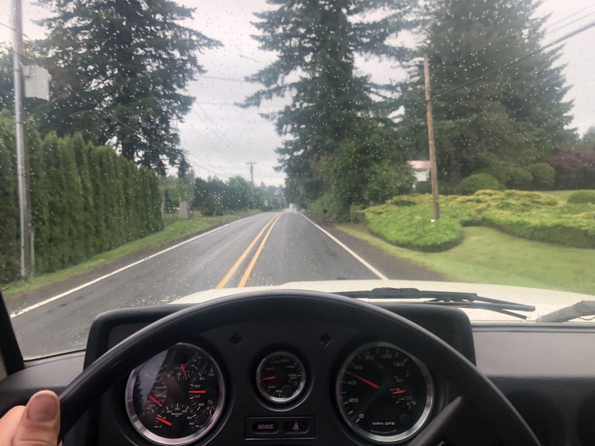

My steering wheel was about 90 degrees off when driving straight so loosened the jam nuts on the drag link and loosened until the steering wheel was where it should be. Retightened the jam nuts. I’ll take pictures of the threads of the tie rods to show how much is exposed. I believe the threads on them were about 3-4” long.

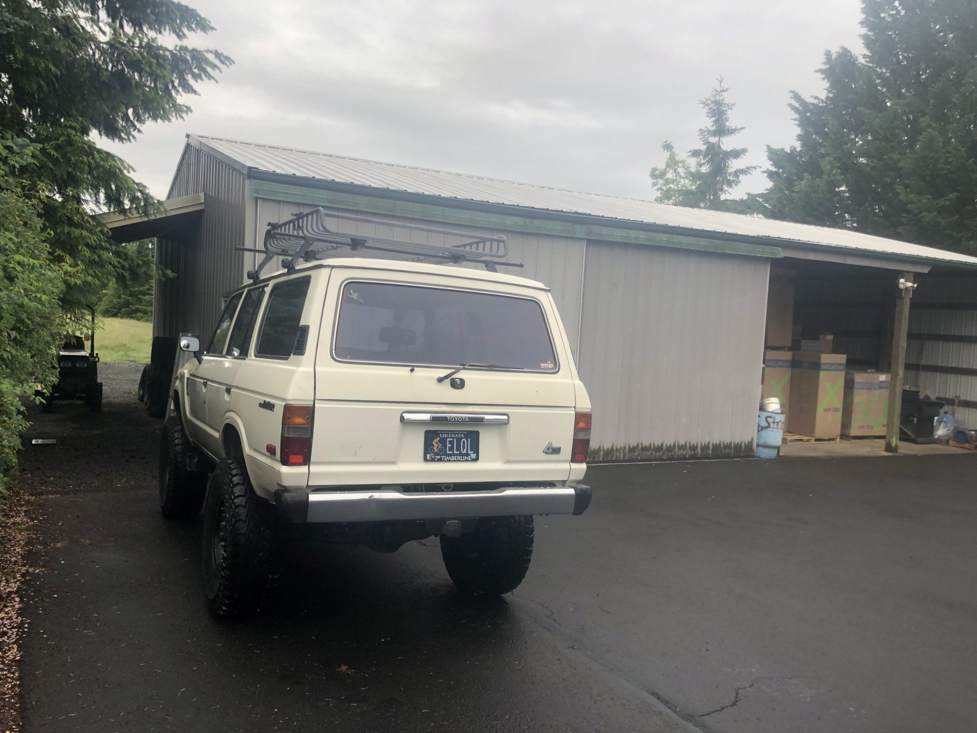

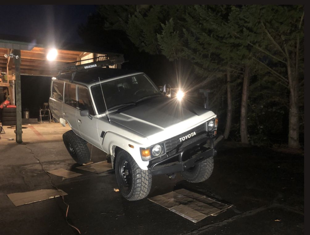

Looks like you moved the rear axle back a lot. That doesn't hit the rear 1/4? That's a pretty low rear shackle angle too, it's not too soft? Also what rear shocks are you running again?
It hasn’t moved since the SOA swap. Flexed it out and it only hit the rear 1/4 at max flex. It’s really a nice ride on the Bilstein 7100s.

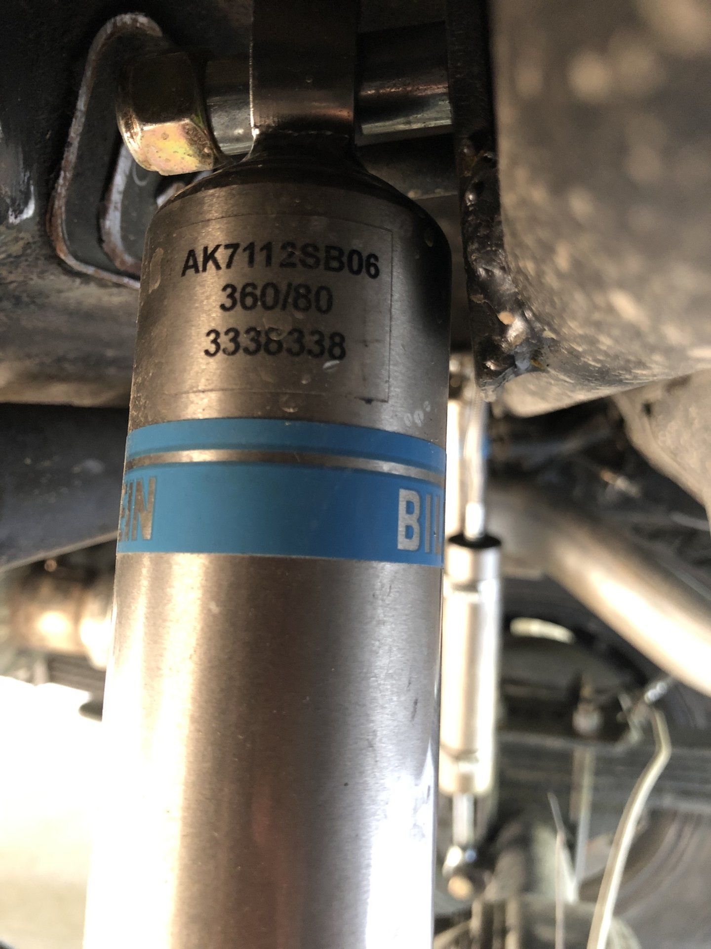

I meant that you moved the rear axle back when you did the SOA. That's right, I remember you had the Bilsteins. What is the travel on your rear shocks? My rear axle doesn't seem to want to drop down that far on the droop side.
Rear shocks
Perfect, thank you!
