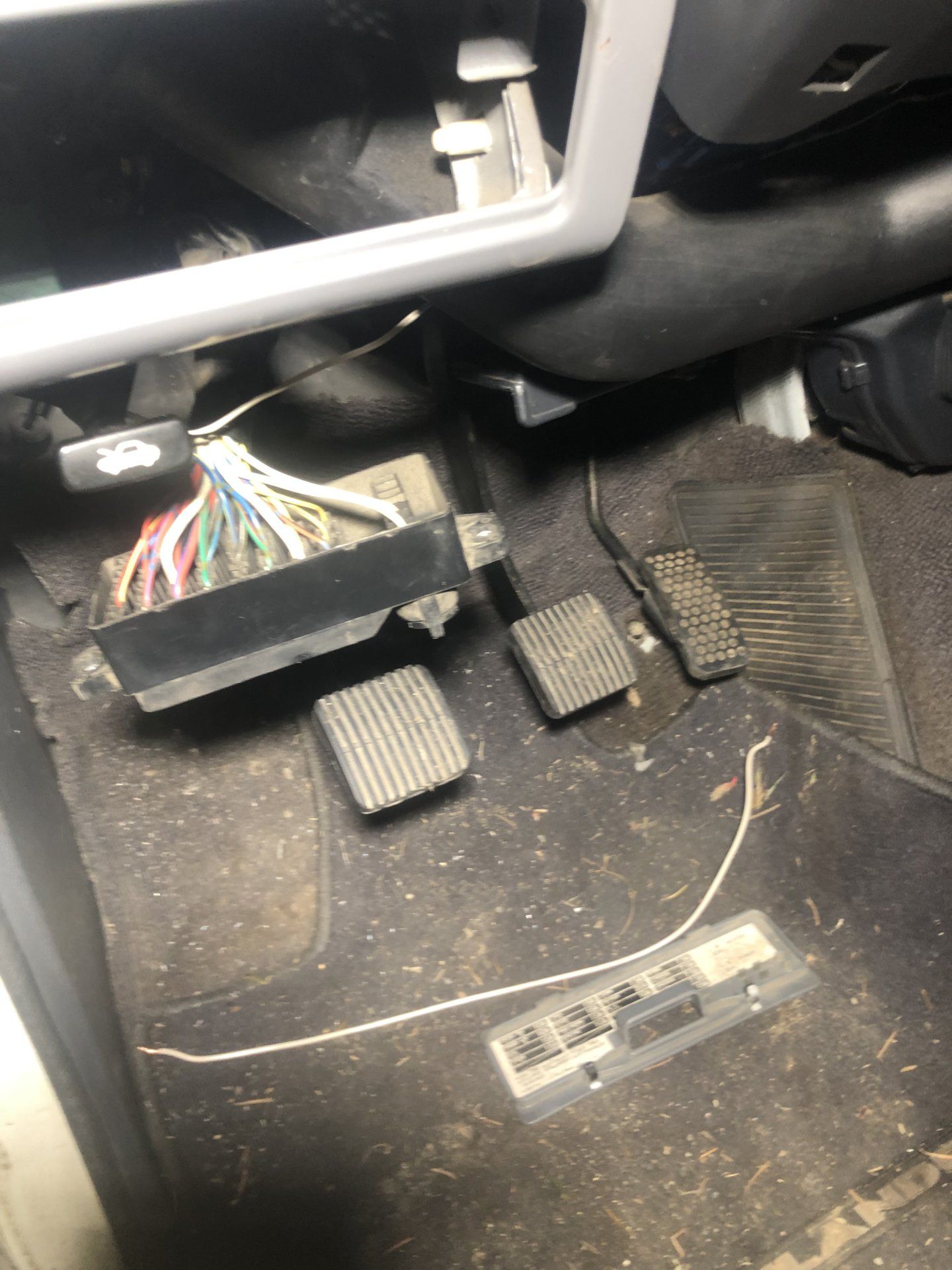

My radio hasn’t been working so it was a good time to figure it out. Found the battery wire to radio was cut. Tore the dash open.
Ran a jumper to the battery and when I turned the ignition it came on. Removed the fuse block and stuck there jumper into the fused side of the cig fuse. Turn on ignition and it worked. Pulled fuse and it turned off. How many amps is a radio typically on?
Wired in radio to the 7.5 amp dome light fuse.

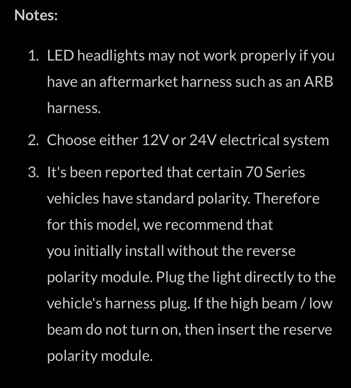

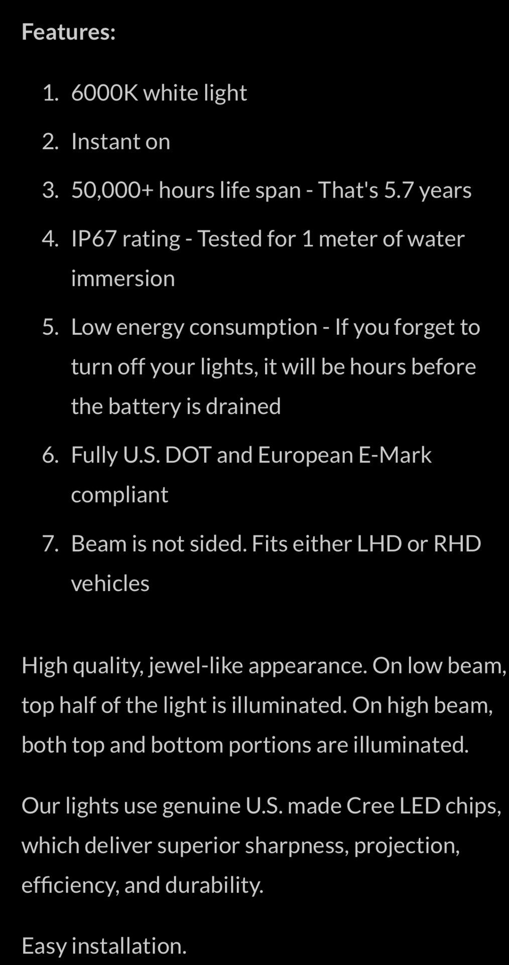

Anybody running these headlights? Mine are overdue for an upgrade.
