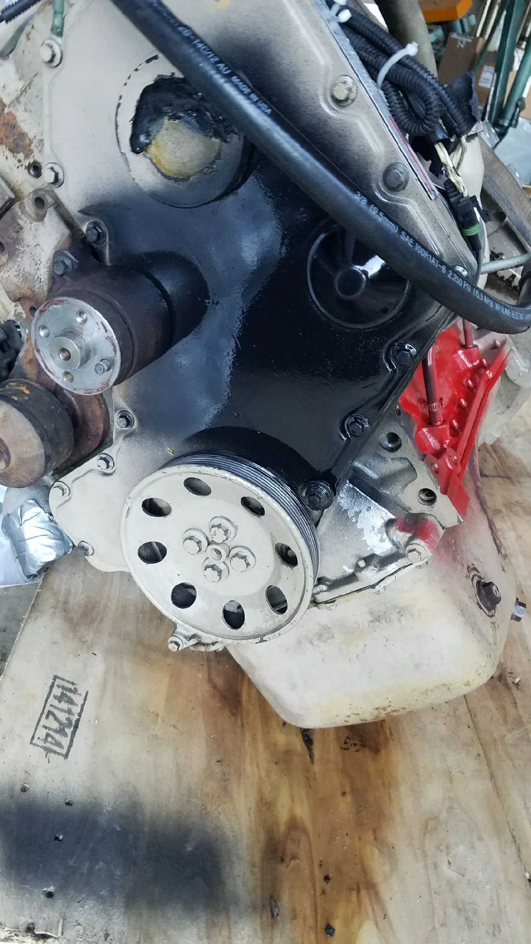

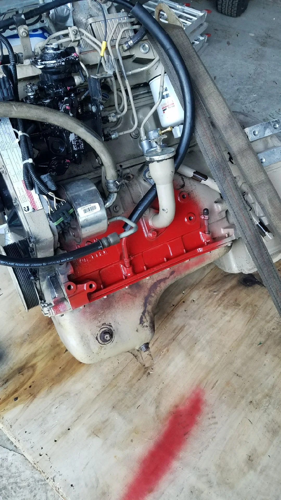

Been a rough week at work but the step van sold today so I got $500. My coworker at work is buying its Husky tool chest for $200. The 4BT is on the engine stand now as we're going through it. Painted a few spots to check color. Now I just need a 2F motor buyer. Had a buyer but his grandpa is the mechanic to install and thought they'd just rebuild their motor with 2 bad cylinders. He thought it would be less to rebuild their motor.Thought $1000 pulled was a great price.
I need to find a picture of mine when I first got it for comparison. It was grease and oil coated. I say yours looks like it just rolled off the factory floor.
I think it may have. The previous owner was a house framer and bought the step van for a mobile tool shep. It was an old FedEx truck so it was a safe spot for tools. When I drove it back to Oregon on the freeway I flew past Toyota Prius like they were sitting still:rofl:
Curious to know which turbo you have on there.
HX30? Your oil pan is in backwards than mine is. Make sure you can clear the diff, might have to bolt it on the other way.
