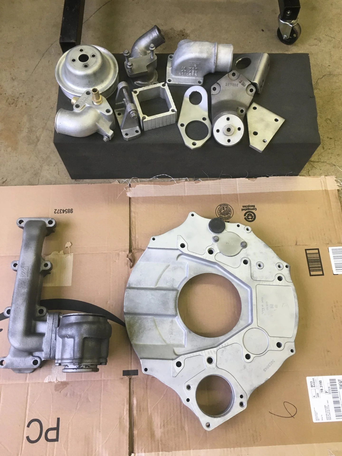

Had some spare time at work and started the sand blasting process. Can't wait to start posting the FJ60 portion of job but really need to sell my 2F motor.

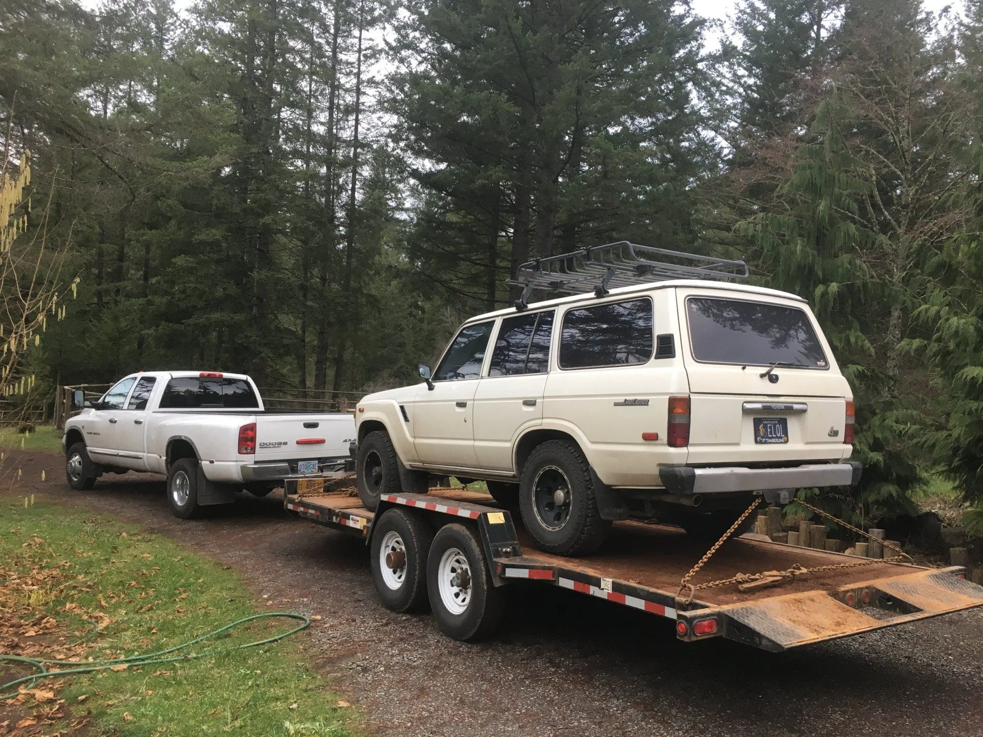

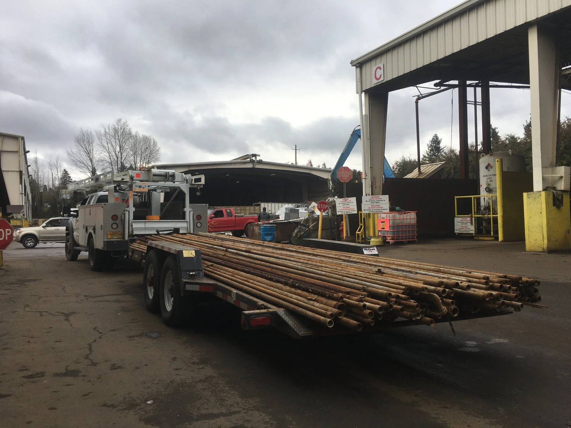

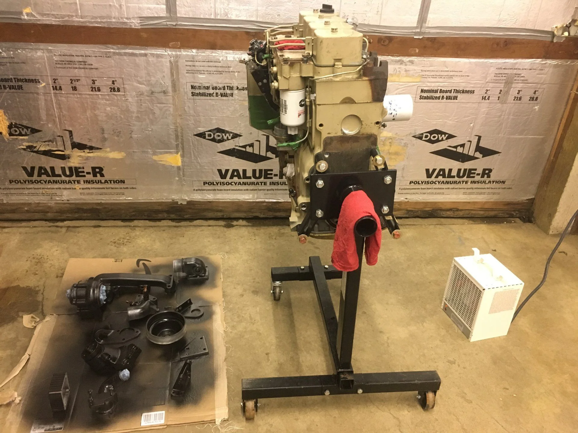

Busy day yesterday collecting more funds for swap. Took in 2 loads of pipe totaling almost 15,000 lbs. Hauled the cruiser into work this afternoon. Got it into shop bay ready for disassemble. Just got bill of sale from 2F motor buyer and 1/2 down payment. Should be starting on 2F motor and transmission removal after work this week. Transmission buyer should be down from Seattle this weekend to get transmission. 4BT has been above heater all weekend getting dry and prepaired for paint. Pictures on the cruiser build should be coming soon.

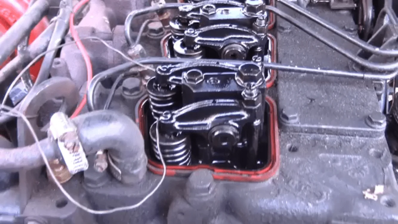

The framer who owned the stepvan prolly didn't change the oil too frequently. Driving the stepvan we checked out sound of motor and watched tailpipe emissions both at idle and freeway speed for areas of concern. Motor ran smooth and no black, blue or white smoke. I'm sure I'll be taking great care of the motor now. I found a picture of another dodge rocker assembly.

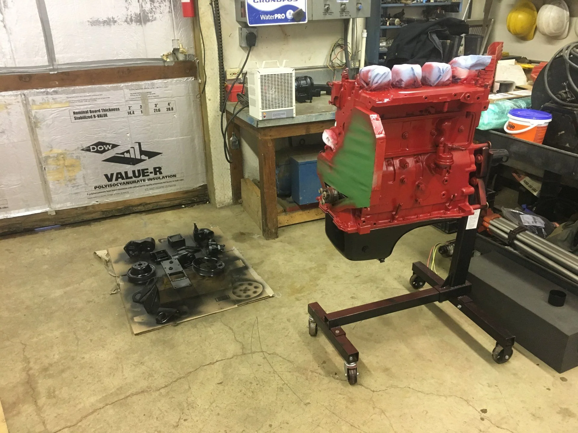

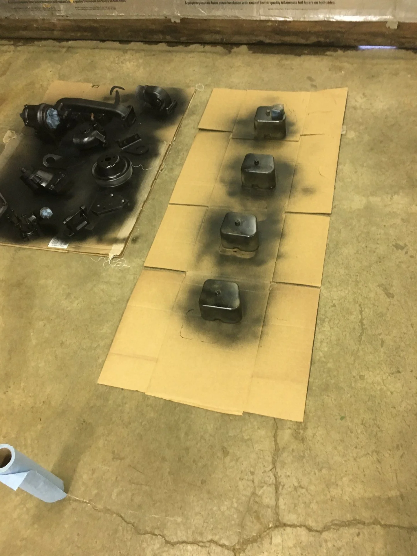

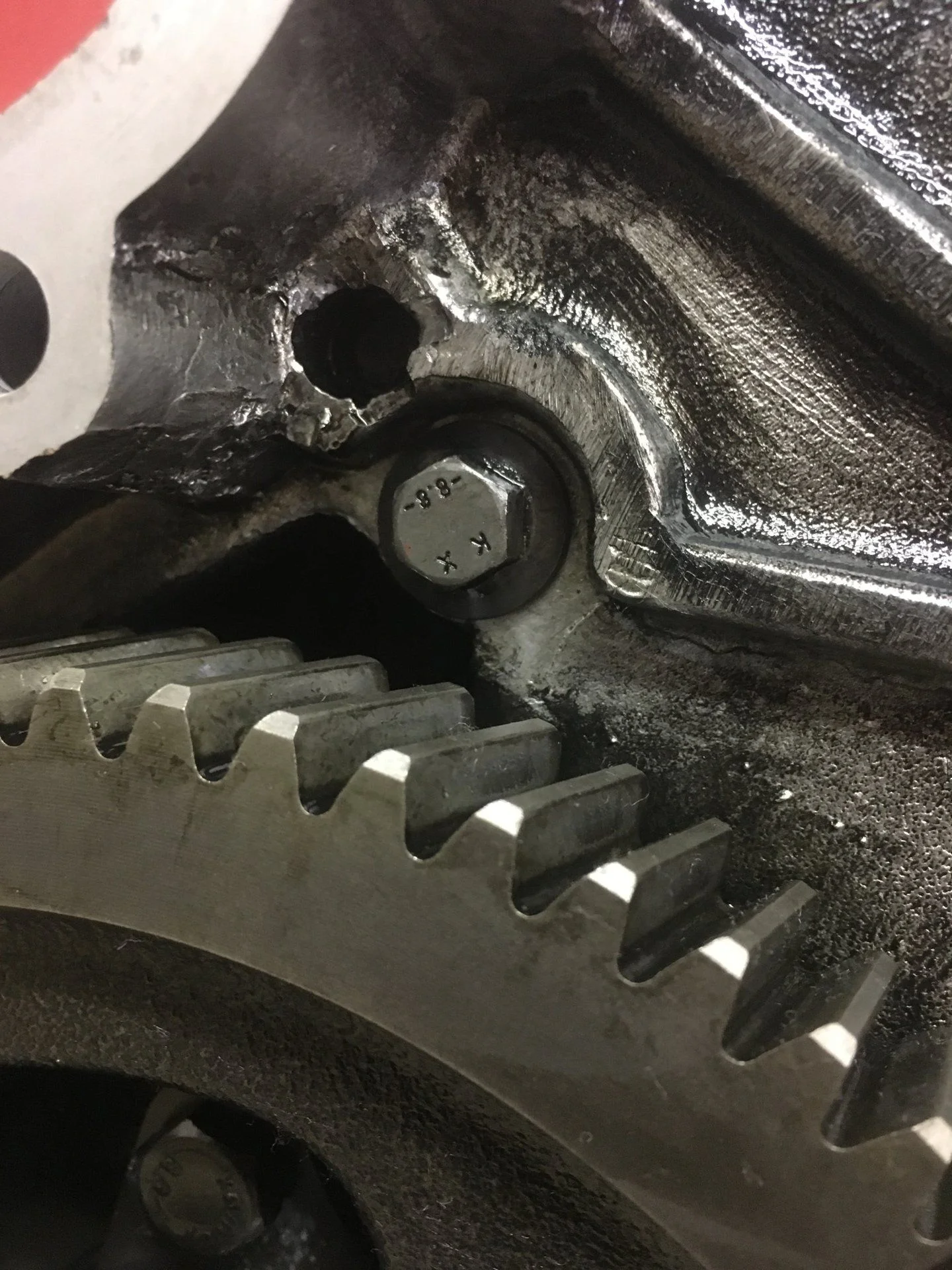

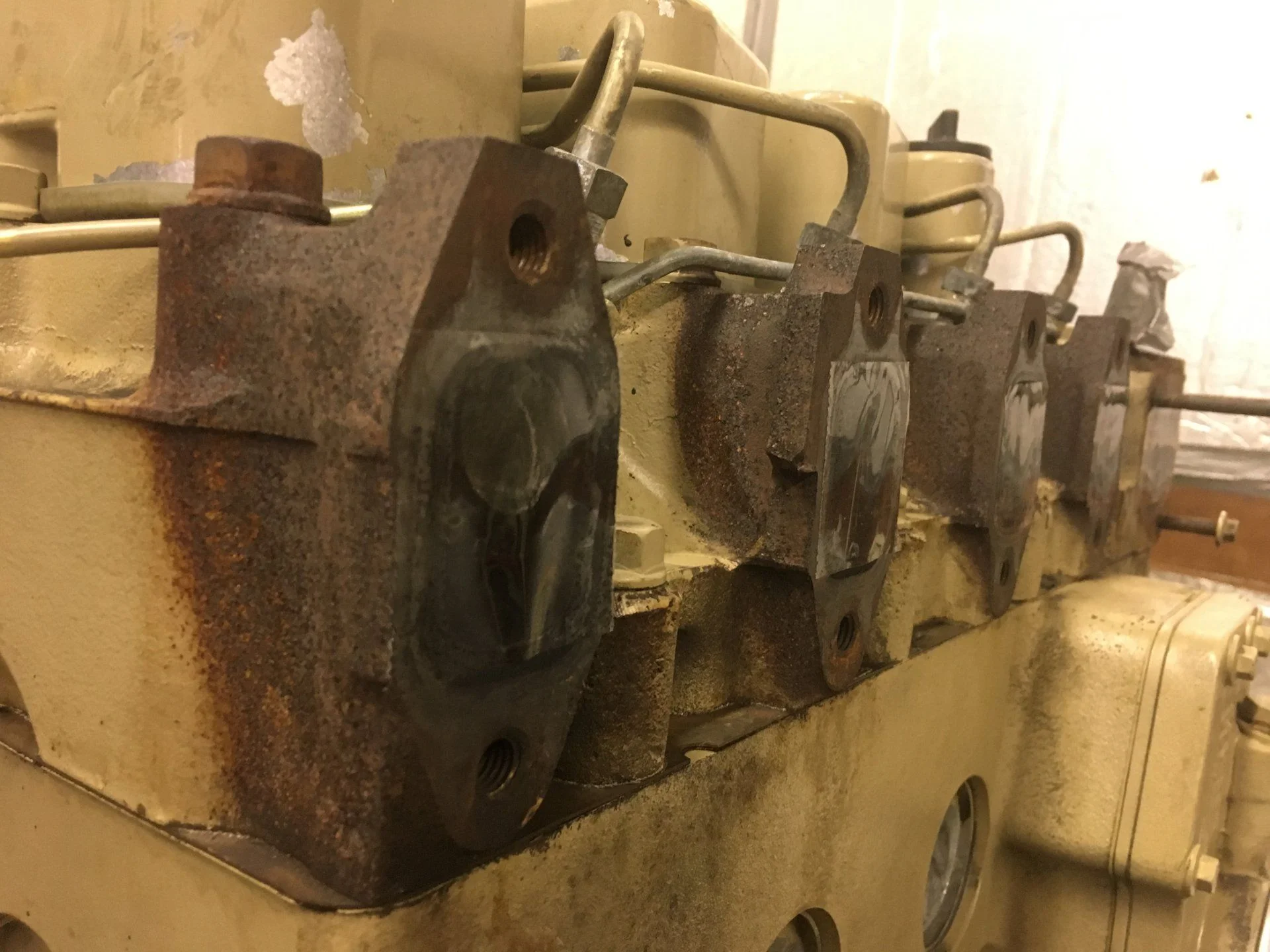

Motor is getting painted, sandblast and paint and clean turbo. The killer dowl pin looks as though Cummins just hammered a punch to crush the hole. Thinking I should purchase the killer dowl pin fix.
Mine was crushed too, I just added a bit of sealer to it. No issues going on 7 years.
Should I pay $15 for the fix? No rush and thought that I should do it right. What sealer did you use?
Can't remember what sealer, but peace of mind is worth way more than$15. I imagine any sealer that won't dissolve with heat and oil should do it.
I'm going to buy the plate and bolt fix. Cummins just used a punch to crush the aluminum to prevent blackout but fix seems best.
