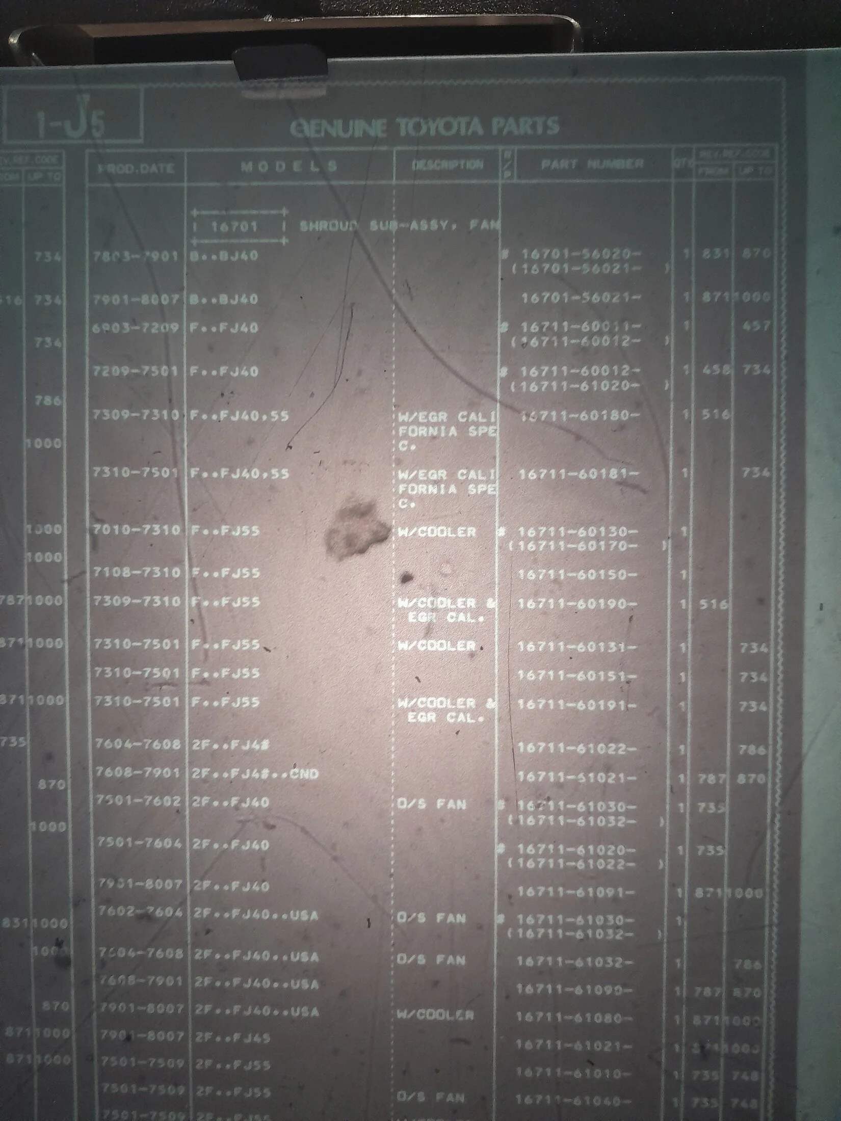

These are pics from my ancient microfiche set I got from a local Toyota dealer in the early '80's. This set covers the US and Canadian markets for the period 03/69 to 07/80. This concerns post #39, item#3 and the radiator shroud. Shown is the part numbers for the shroud through the years. The p/n's with the asterisk denotes an old p/n with super ceded p/n in parentheses. Maybe someone else can confirm, but it looks like you may be able to use a shroud well past your '69 build.

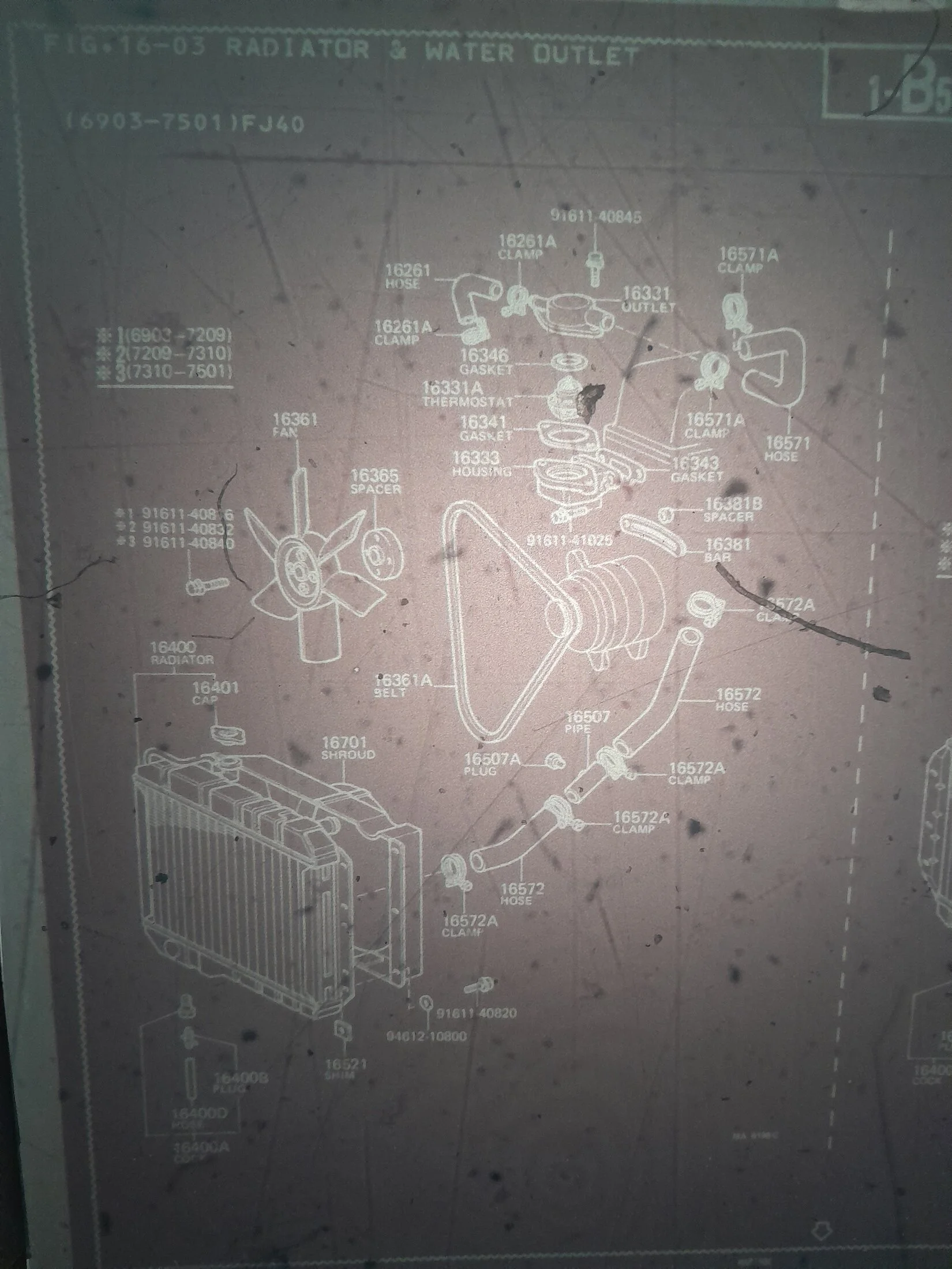

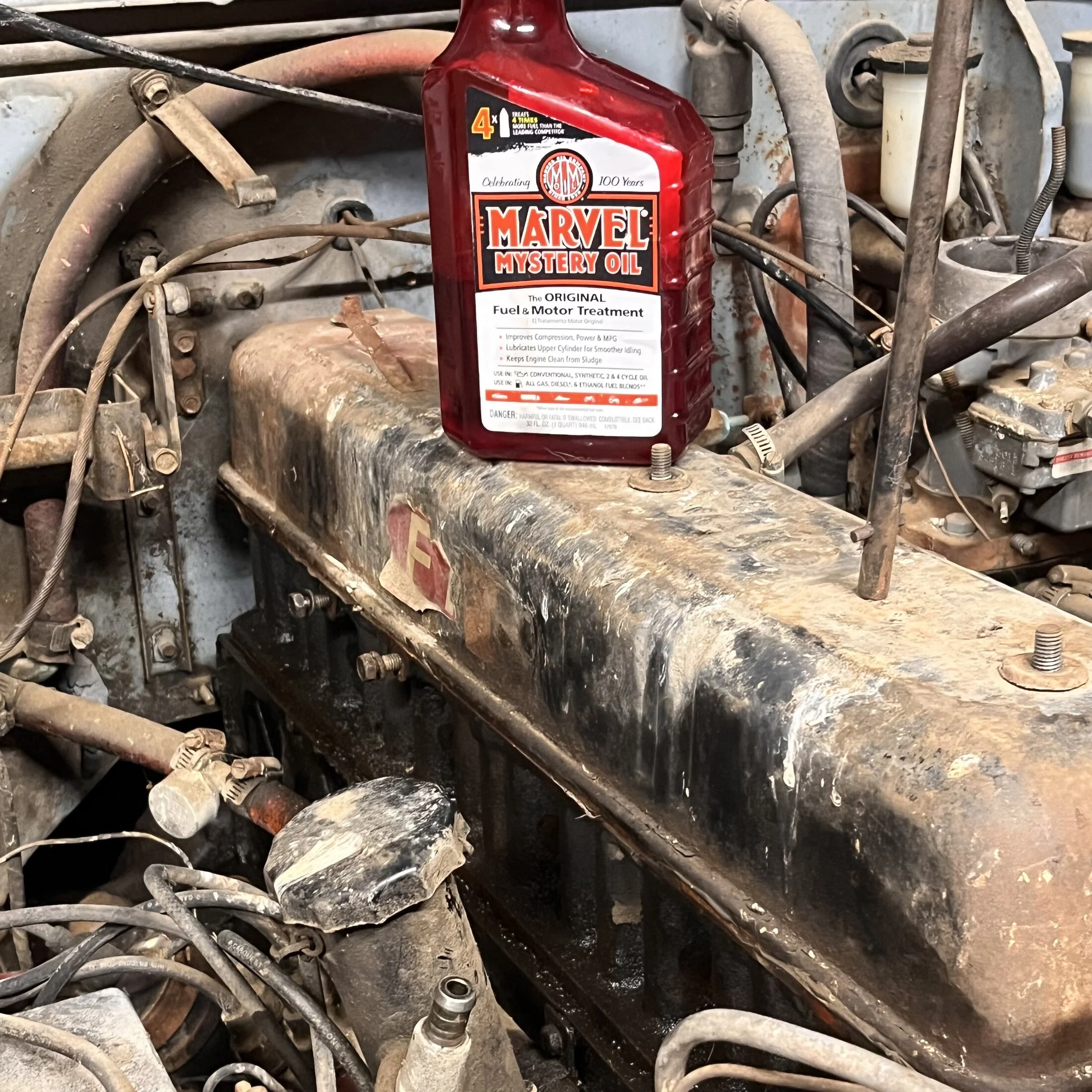

My plan was a little long and involved before running it, stuff like replacing all the hoses and vac lines. I think I’m going to remove the spark plugs, let some Marvel oil sit in the cylinders for a few weeks while I rebuild the carb, put it back together and fire it. If it goes, I’m driving it around the block. If it goes around the block, I’m gonna go to the DMV.

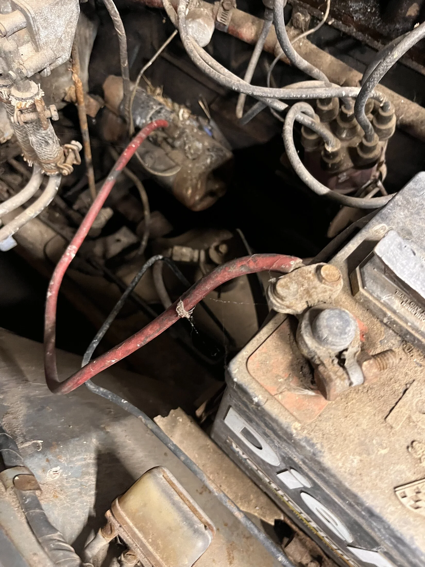

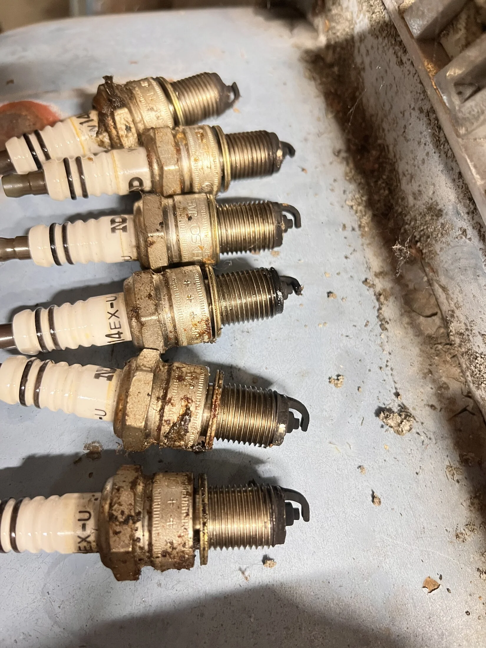

Wow big step today. Pulled the spark plugs and put some Marvel Mystery Oil in the cylinders to soak. Sparks plugs came out easy and don’t look half bad. I sat and stared at the engine bay for a while assessing its immediate needs: new battery, carb rebuild and throttle cable installed, fuel and vac advance lines connected, radiator installed and may as well put in new coolant hoses, belts. The largest glaring issue is the state of the wiring. It’s all so crunchy and missing behind the B-pillar. No fusible link. Big cable from battery to starter, and the rest of the harness is attached to the starter (as a junction point) via a really wimpy ring terminal. I’m convincing myself I need to scratch build a full harness. I should tally up what connectors I’ll need so I can start hunting for those - or suitable replacements. All in time…

The alternative is sourcing brand new connectors that are different than the old ones. For example just go through Sumitomo’s catalog and make choices. It wouldn’t look original, so I’m inclined to go with what OEM stuff that’s still available from Toyota, the rest from Coolerman, and use Sumitomo for whatever the first two sources can’t provide. Still an undertaking measuring all the wire runs and recreating the harness though. And then stuffing it through the firewall, etc. I’m good with electrical work, but this job just seems annoying.
To that end Coolerman sells partial wiring harnesses that I could use, but where’s the fun in that? I can order all new OEM Yazaki wiring from a source I have in Japan and roll my own. Save $250 and be really annoyed for a week - sounds like a blast!
My '69 wiring is all original (mostly, except where I fixed a couple things po did), so if you need references for how things go, reach out. No fusible link from factory on the old 40's! Coolerman sells a nice retrofit kit tho.
Thanks! Maybe I’ll make the drive to Iowa to visit some relatives graves and hop over to your place. Kidding. I will certainly take you up on the offer in the form of photos at some point. Interesting that there was no fusible link too. I’ll have to cook something up for that. Protection is good even if it doesn’t look stock.

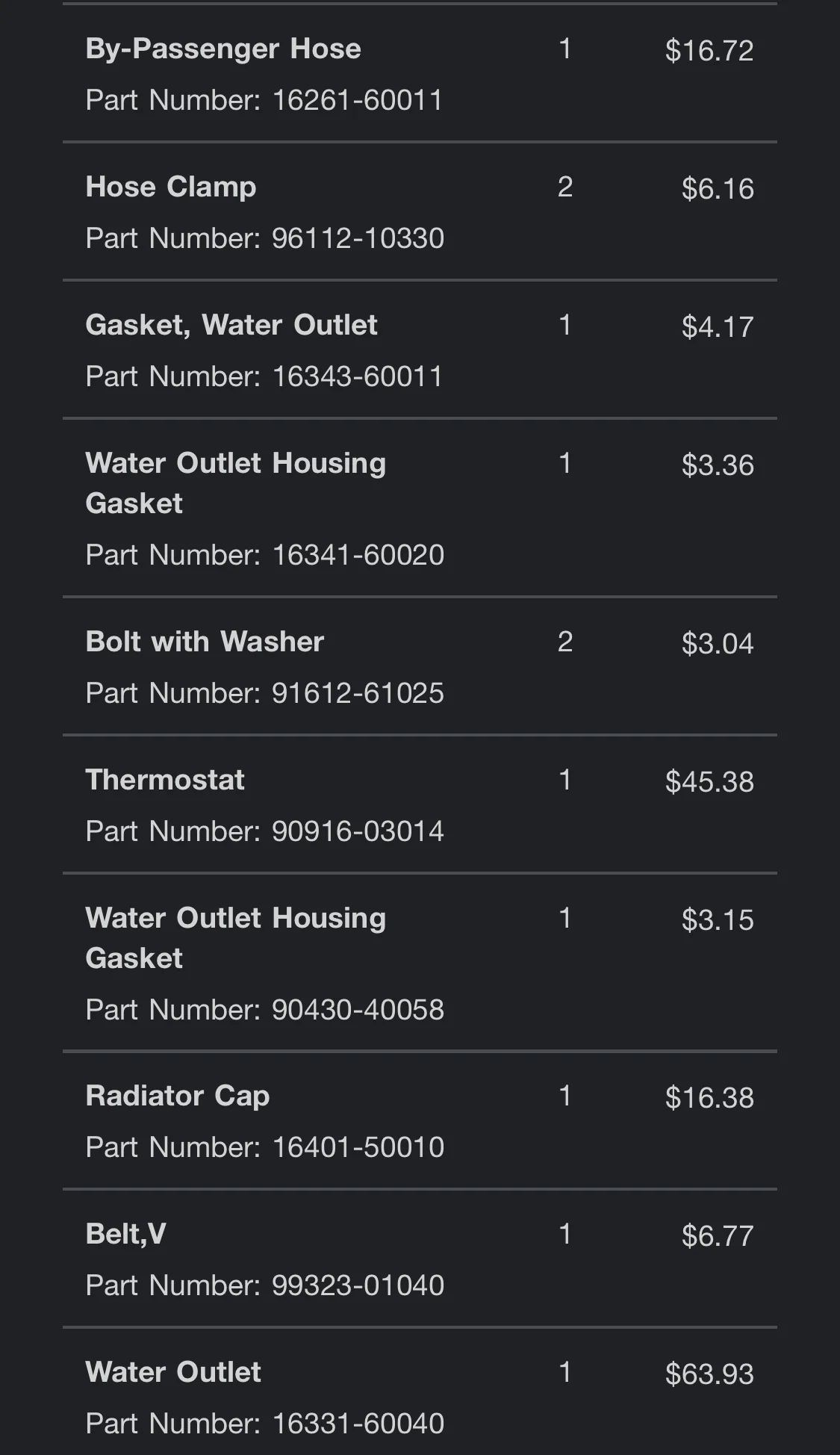

I’m going to put the cooling system back together. I saw this place rebuilds water pumps and was thinking that would be a good idea. I think I’m also going to splurge on some Coolerman harness sections to speed the process along.

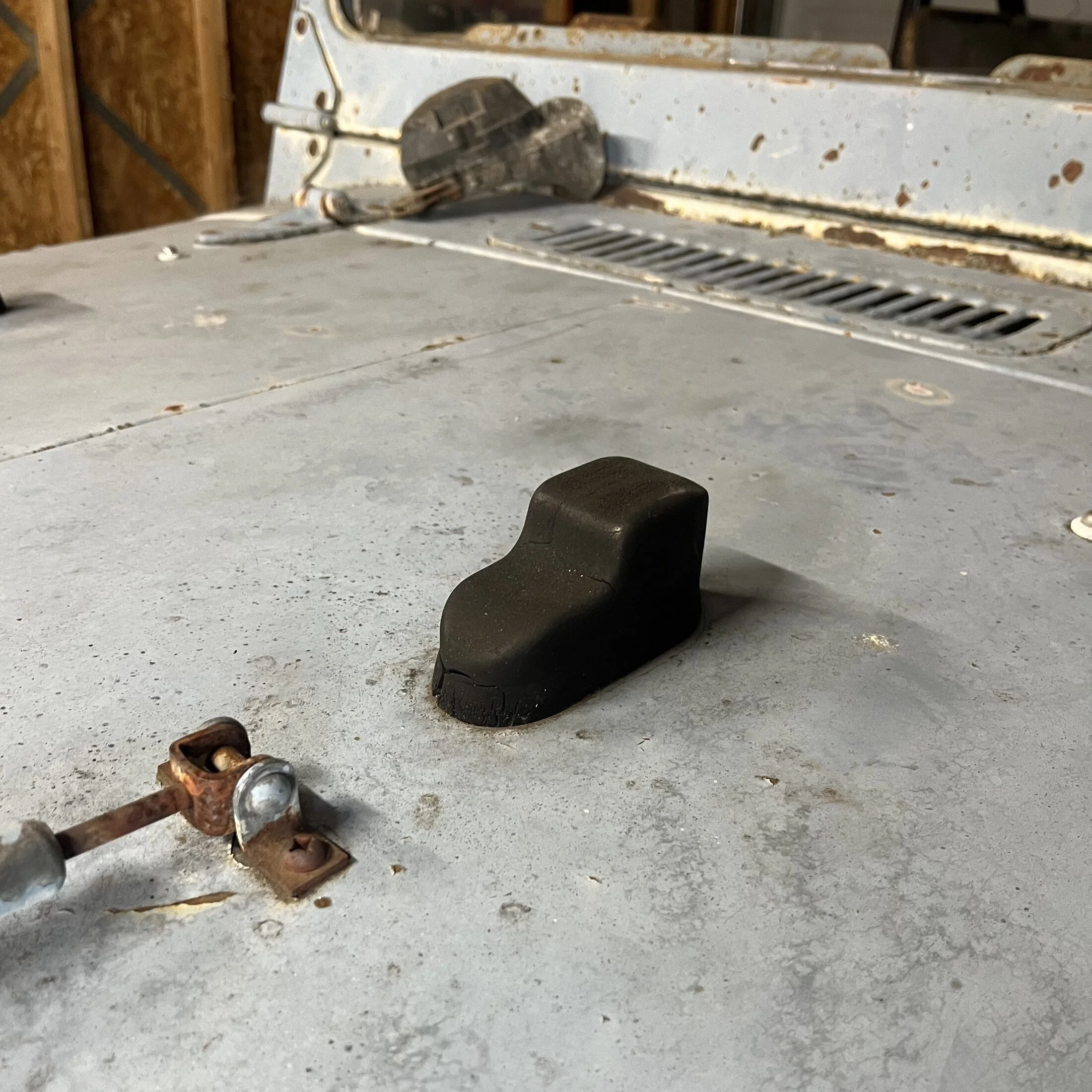

Here’s the hood bumper:
Hopefully that photo loads for you.

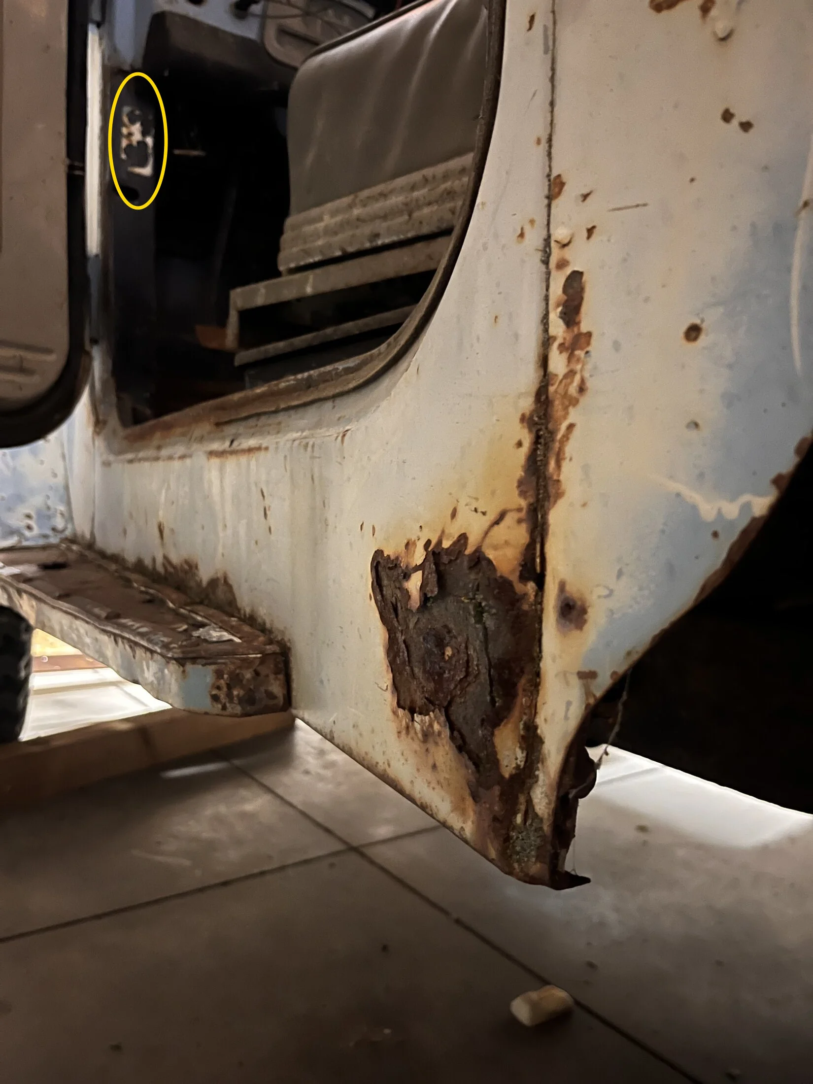

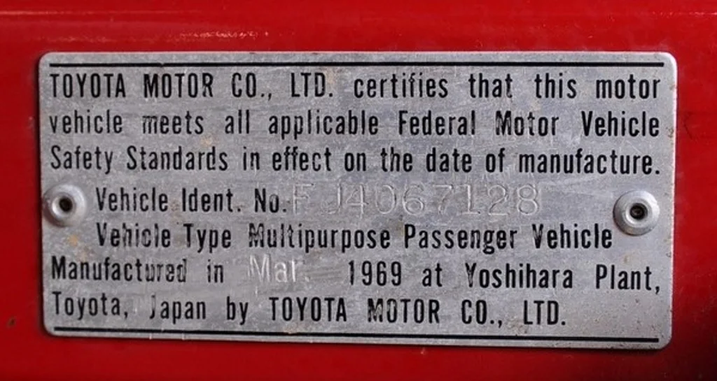

Looks like you may have an A-pillar plate. These started in 1969 and the month of manufacture is stamped on the plate along with the VIN.
The early 69 plates look like this.
Unfortunately I don’t have the door jamb plate. The area where it would be is suspiciously painted a different color, but there’s no sign of rivet holes. They weren’t even filled in, I got my had all the way around behind there and the metal has always been intact. That’s kind of a head scratcher for me - no rivet holes, but the exact size and shape of a VIN plate is painted differently.
So, since I only have the tag in the engine bay … no date.
