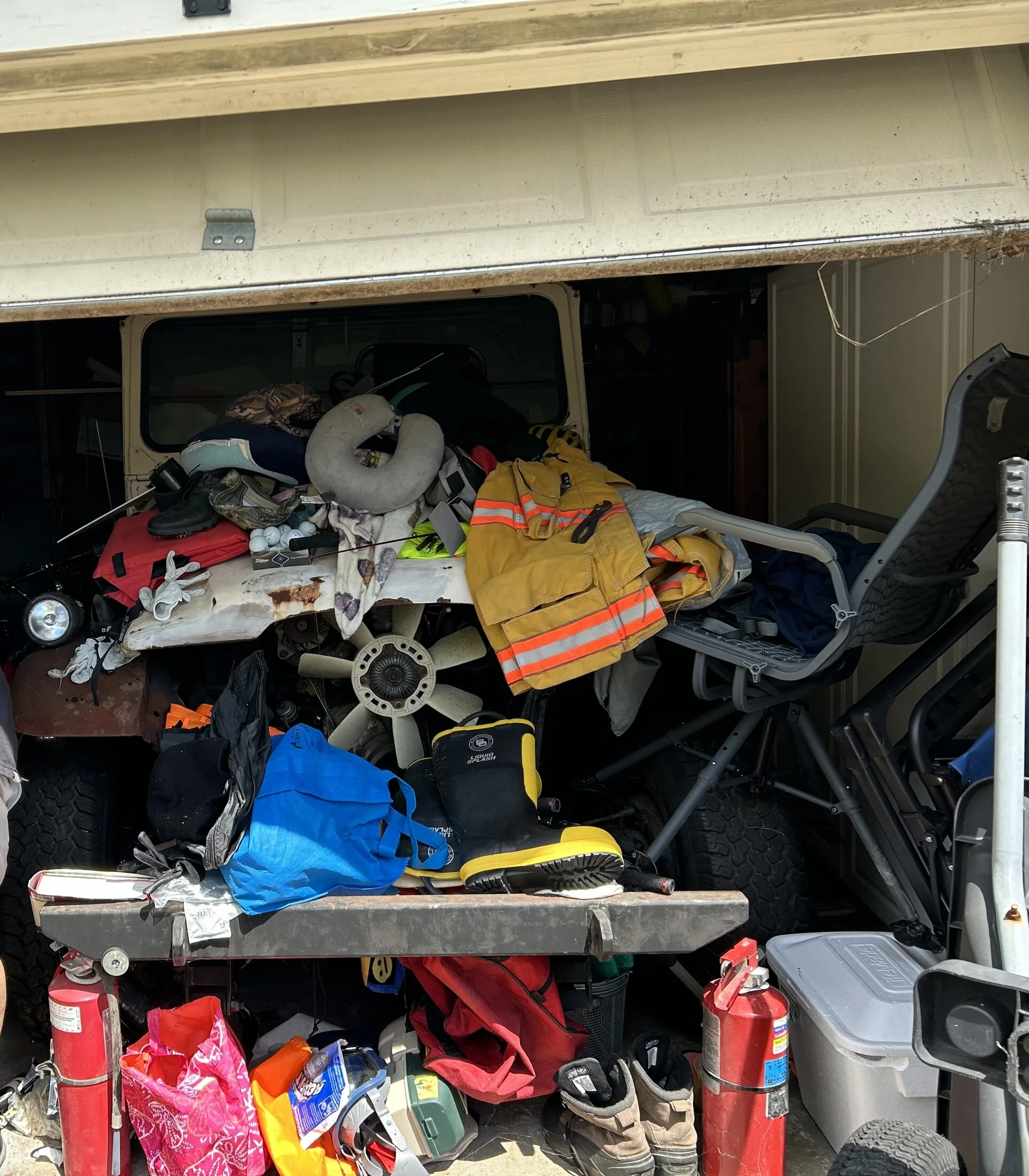

I am trying to talk the owner of this to let me do the same thing.
Been sitting 15 years, but at least inside.
Agree with that.
I am trying to talk the owner of this to let me do the same thing. View attachment 3647384
Keep leaving notes and knocking on the door. It'll happen for you. Heck, you could buy him a shelving unit and some organizer bins as part of the deal - it would serve the same function as the 40 currently serves.
Looks like a firefighter

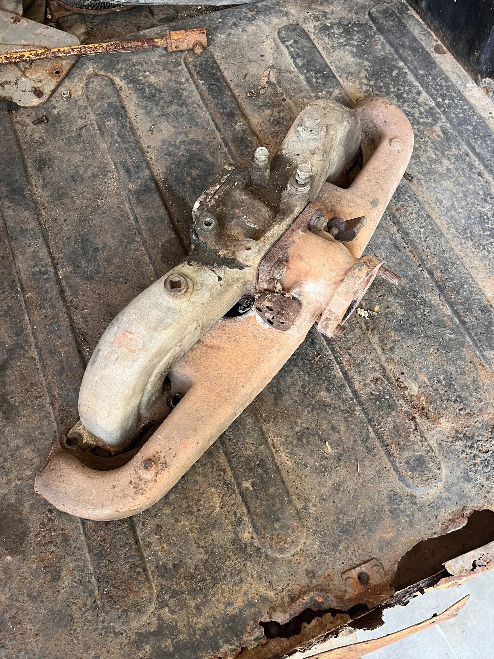

That’s good to know. I’m definitely in the market for the exhaust manifold to match my intake with the larger runners (69-only manifold setup for 2bbl carbs). I wanna pitch this rusty header and go back to stock. I also need the stock throttle linkage. Somebody had a Rochester or something on here and I have a stock Aisin going back on. The entire linkage is gone. Coolant overflow bottle and bracket are give as well. I’m sure there are other bits and bobs missing that I haven’t noticed yet too. Let’s take it to PM and hash it out when you’re ready.

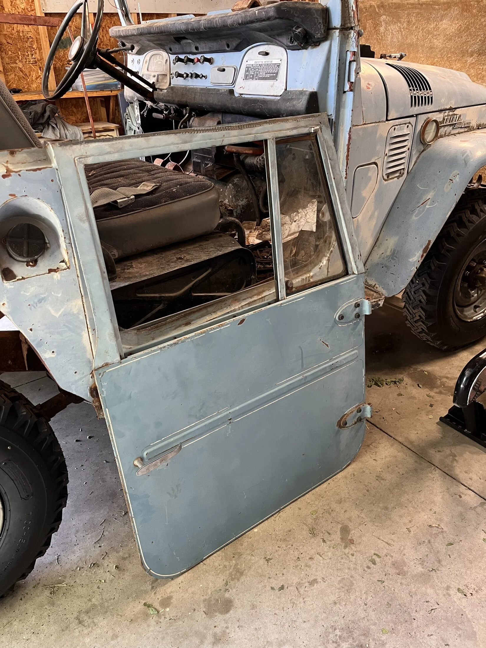

-Capri blue passenger door (to replace the dune beige doors, still on the hunt for a good driver’s door)

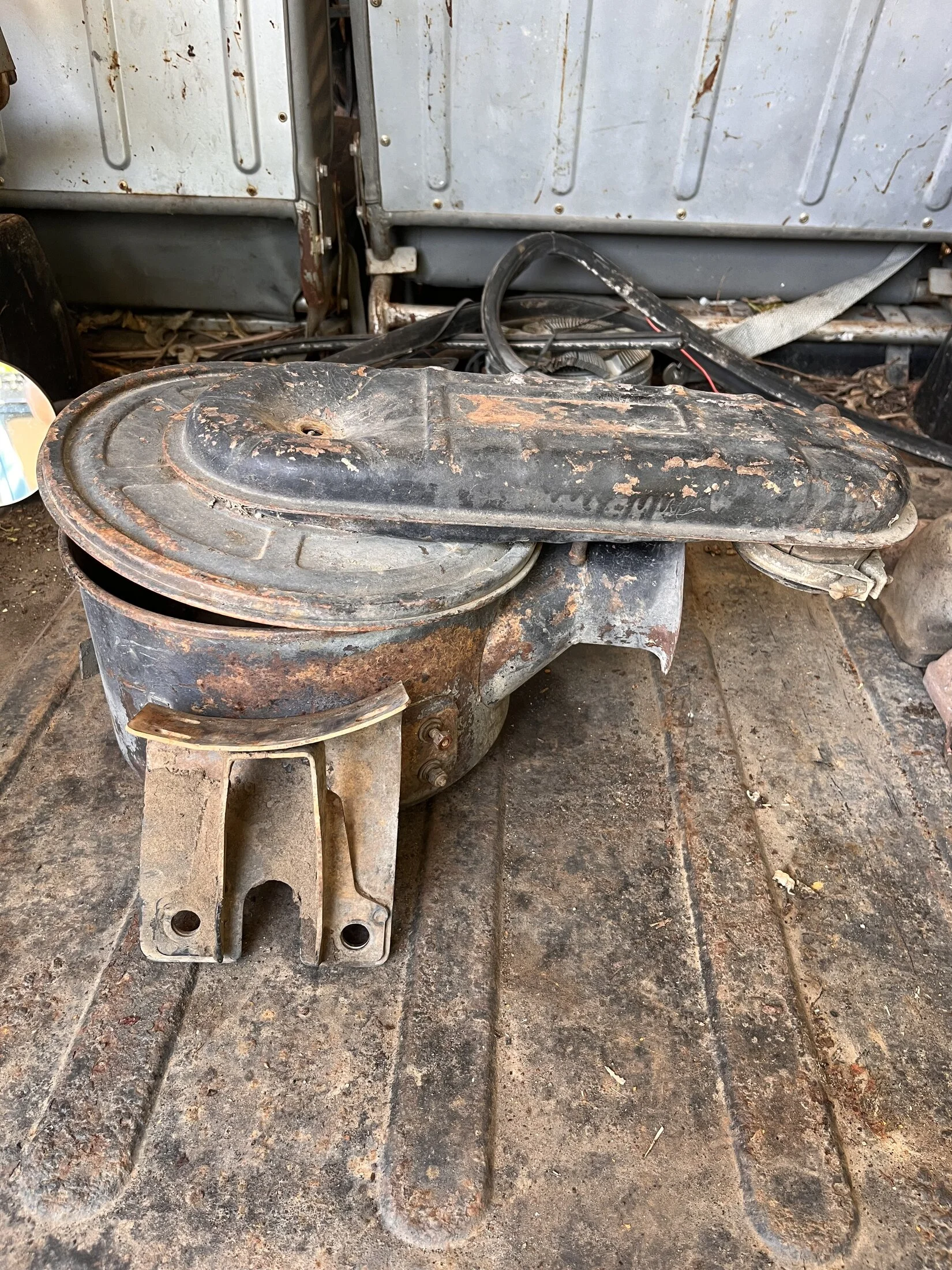

-the correct air cleaner for the late 69 carb I have
-69-only manifold set that I can snag the exhaust from

I think this air cleaner base and bracket are correct for 69, but I think the lid is earlier. I was looking through a pallet of them at Classic Cruisers and I think 69 had two ports on the lid, one of them possibly being for an air pump. I don’t have one and the holes in the head are plugged, and I won’t be running that anyway … so I picked up the lid with one air port. The top fits over the carb with the right amount of room for the gasket and the pinch strap thing was on it too.
I did not get this one
I got this one
Manifold set, broken studs included.
Cool pinstriping on the door, and I don’t mind that it doesn’t match.
