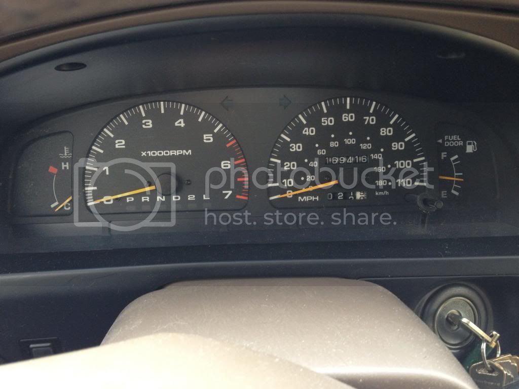

I drove it home and couldn't stop thinking about how I just bought a car twice as old as the one I had with twice as many miles!
Luckily there was a Toyota dealership literally around the corner from where I lived. Even though I was against stealerships I took it there being that it was the only place in town I knew that would have Yota knowledge (not much import car love where I was). Im anal about maintanaince and wanted to get it taken care of before I started the fun stuff.
In the first month I ownded her I baselined all the fluids, did the water pump and timing belt, new battery, fuel filter, pcv valve and air filter.

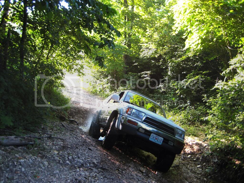

First time taking her "off road"
Which resulted in this...
Basically the front sway bar link broke which let the bar literally go into the CV boot and....ya. So while that was getting sorted out I had the LBJ's replaced with OEM naturally.

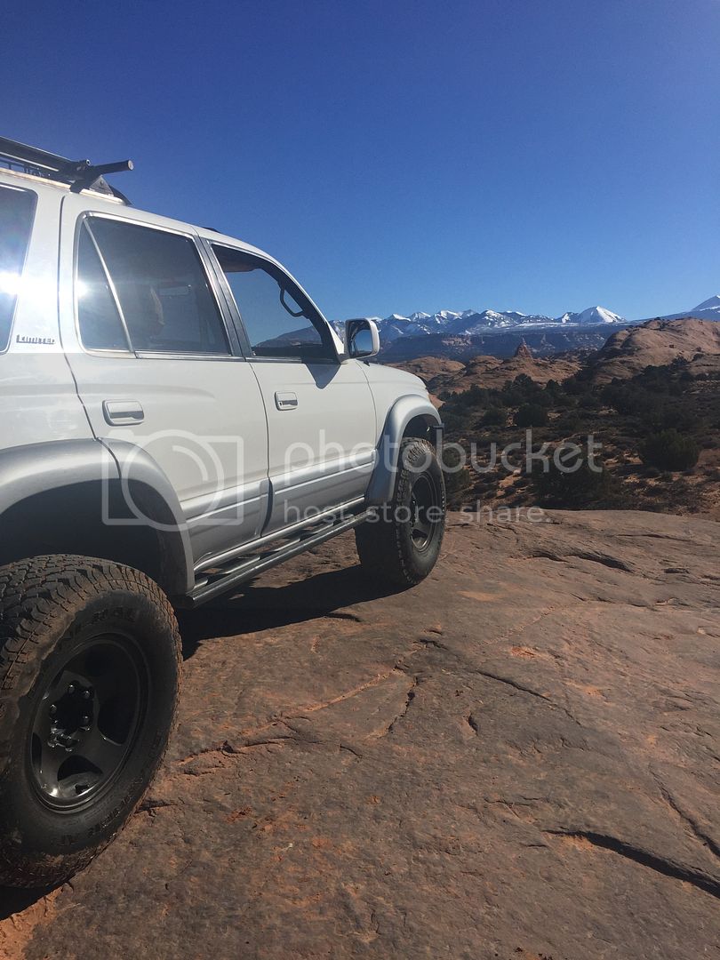

Exactly 1 year after buying the Runner (I just noticed in my records) It was time to finnally lift 3in and put on 33's.
I got a great deal on some LC wheels on TTORA and ordered up some OME 883 and 891s (after researching on here of course). For rubber I went with General Grabber AT2's, they were a good price and BrianSD_42 reccomended them so they must me good.:thumb:
A pic the night everything was installed
I went on some day trips here and there and met up the the guys from MO4WD (good dudes) but I NEEDED to do a UT/CO trip. I had been to Moab before but only mountain biked and i hed never been to Telluride. So I took off 2 weeks and hit the road. I ended up becoming good friends with the tech guys at the dealership and was lucky enough to get lots of "discounts" since I was always in there. Before I left I replaced the radiator with another OEM, changed all the belts AND the day before I left we noticed the driver side valve cover was cracked:lmao:. I left it over night and they cranked on it to get it done before I left the next day. While they were in there they replaced both valve cover gaskets and plug seals.
Somewhere in here I added Savage front skids, that I got off a guy selling his T4R
All poser shots naturally
