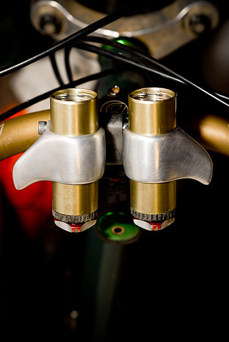

Fast forward 15 years and this Judy fork was still lurking around my garage along with 6 or 7 other forks that I can't seem to let go of. It needed a new life. It wanted to be put back in service. So I made it into a light. Yup. A light.
STP_0113 by Scott P., on Flickr

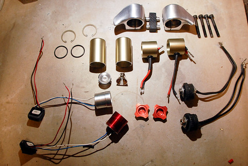

All in all I ended up using 16 individual parts from the Judy fork.
STP_0112 by Scott P., on Flickr

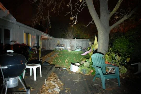

I'll try and dig up the "beam shots" and post them too.
Beam shots from my backyard
That is great! Particularly like the use of the compression and rebound knobs as switches. And the cross-section where the X-brace meets the lowers is gorgeous!
Good job. Two rings up, 9 cogs down, three snaps and a circlip!
