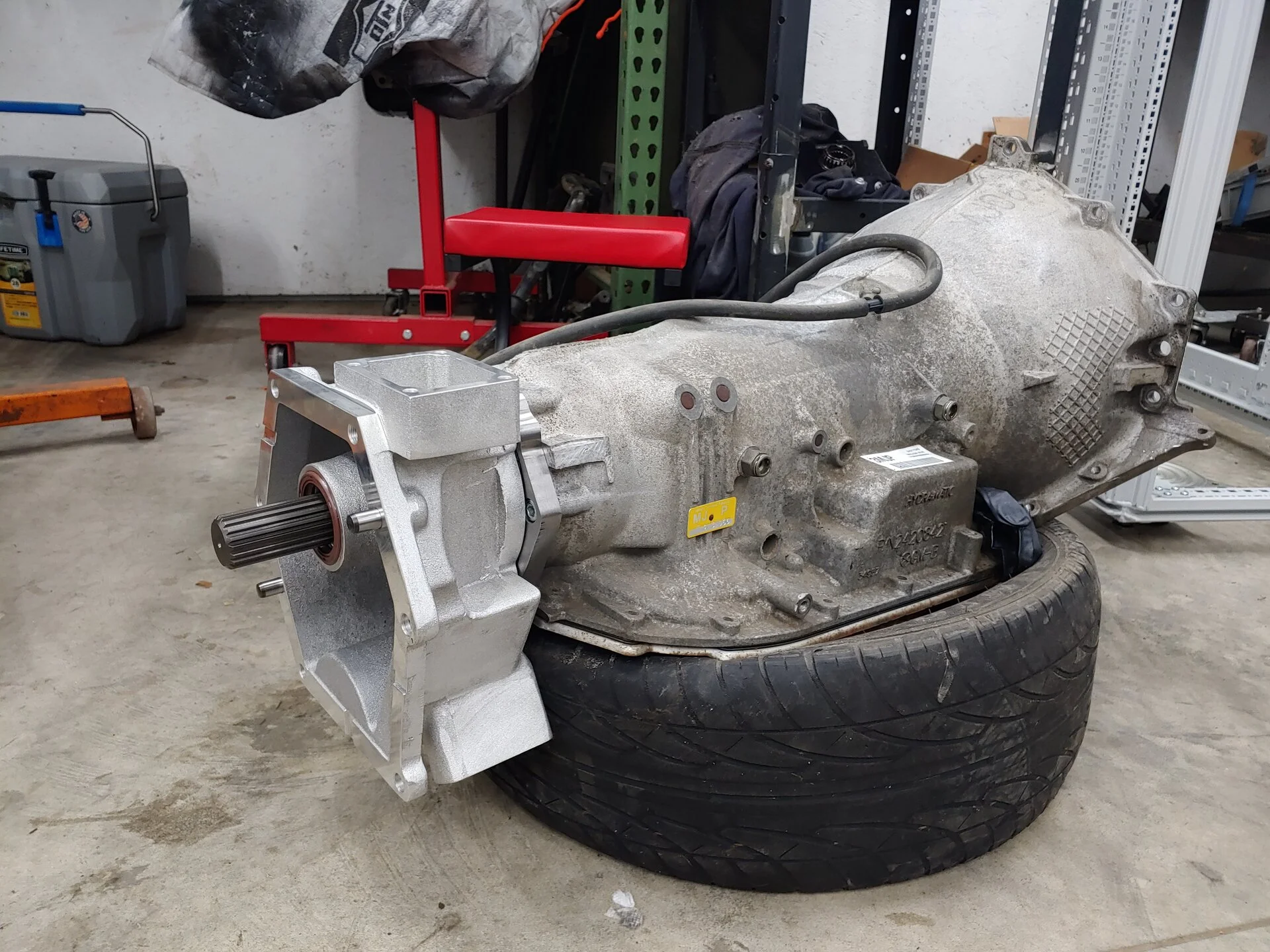

Tranny. The 6L90 is longer. Output shaft would have to be machined. ($200) ask me how I know.

I am actually as well. 😁 2020 L96/6L90e. I just pulled the 1FZ, and haven't tried fitting the L96 yet. Cost to have Moser re-spline with return shipping was $133. Shipping to them was $34. I would probably opt for the 6L80 as well.
