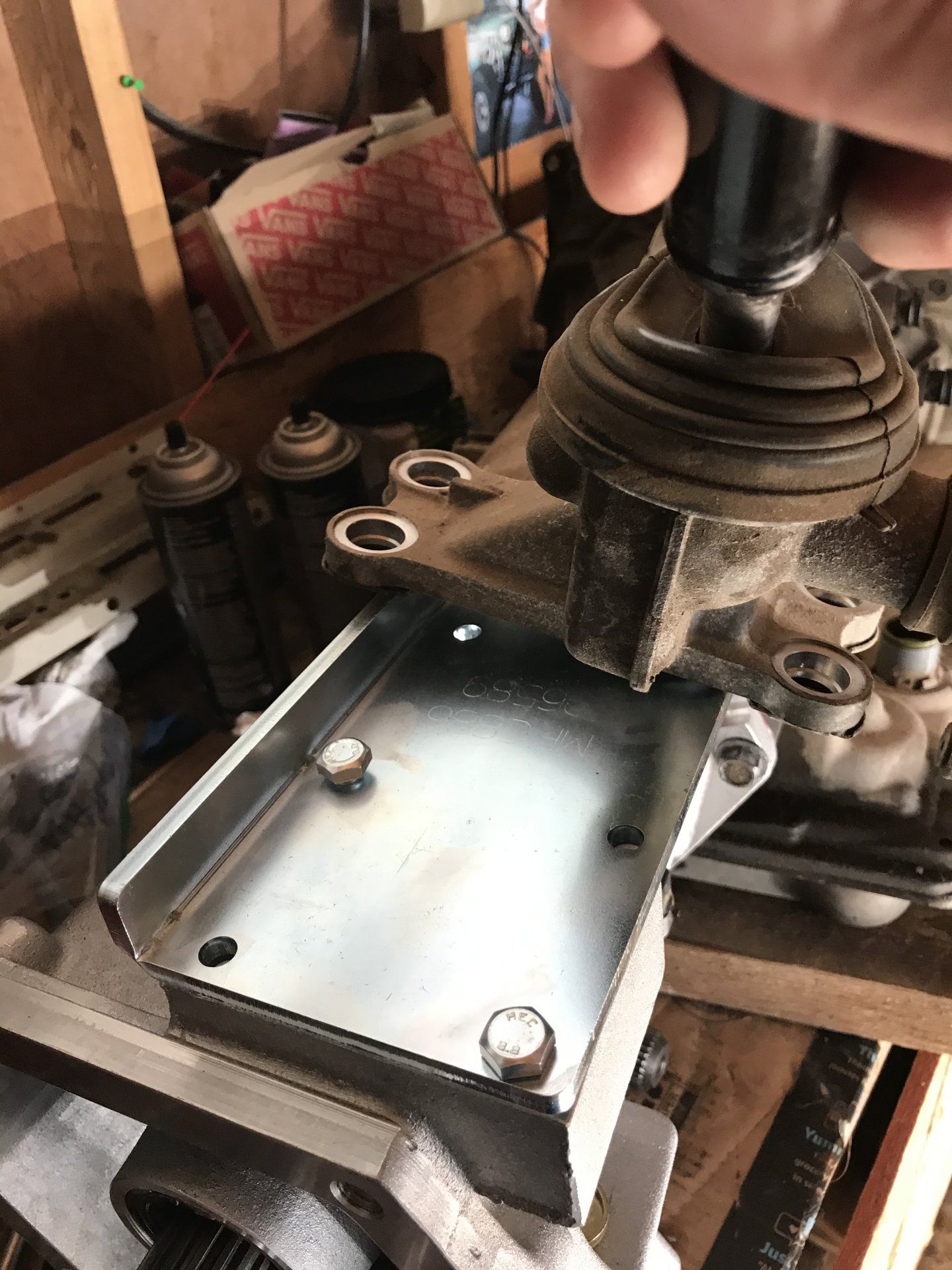

The Allen-head plug is on both sides. Not sure why it’s there. 🤷‍♂️
the directions are clear as mud to me.
did y’all have to fab your own transfer case shifter?
The plate that the tcase shifter is "superposed" to mount to isn't even wide enough for the shifter..... 🤦‍♂️

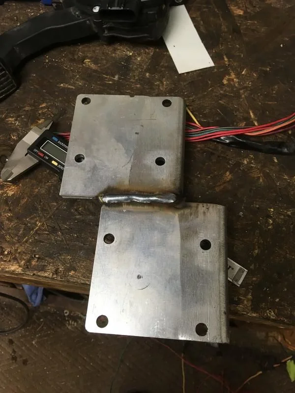

this is what i did and works perfect
There are two differ types of t-case shifters if I recall correctly. The bracket is for the earlier years.
This is what I got and my shifter.
May as well make what you have work since you will be cutting and welding even if you have the earlier shifter.
That’s actually a later model shifter. It’s much easier to use the early style. I picked mine up on Ebay. You might try Yoda Jim’s since you’re in the Denver area
That's what I mean. Even with the the early shifter like I have modification was neccessary, so he ought to just fab something for the one he has already.
