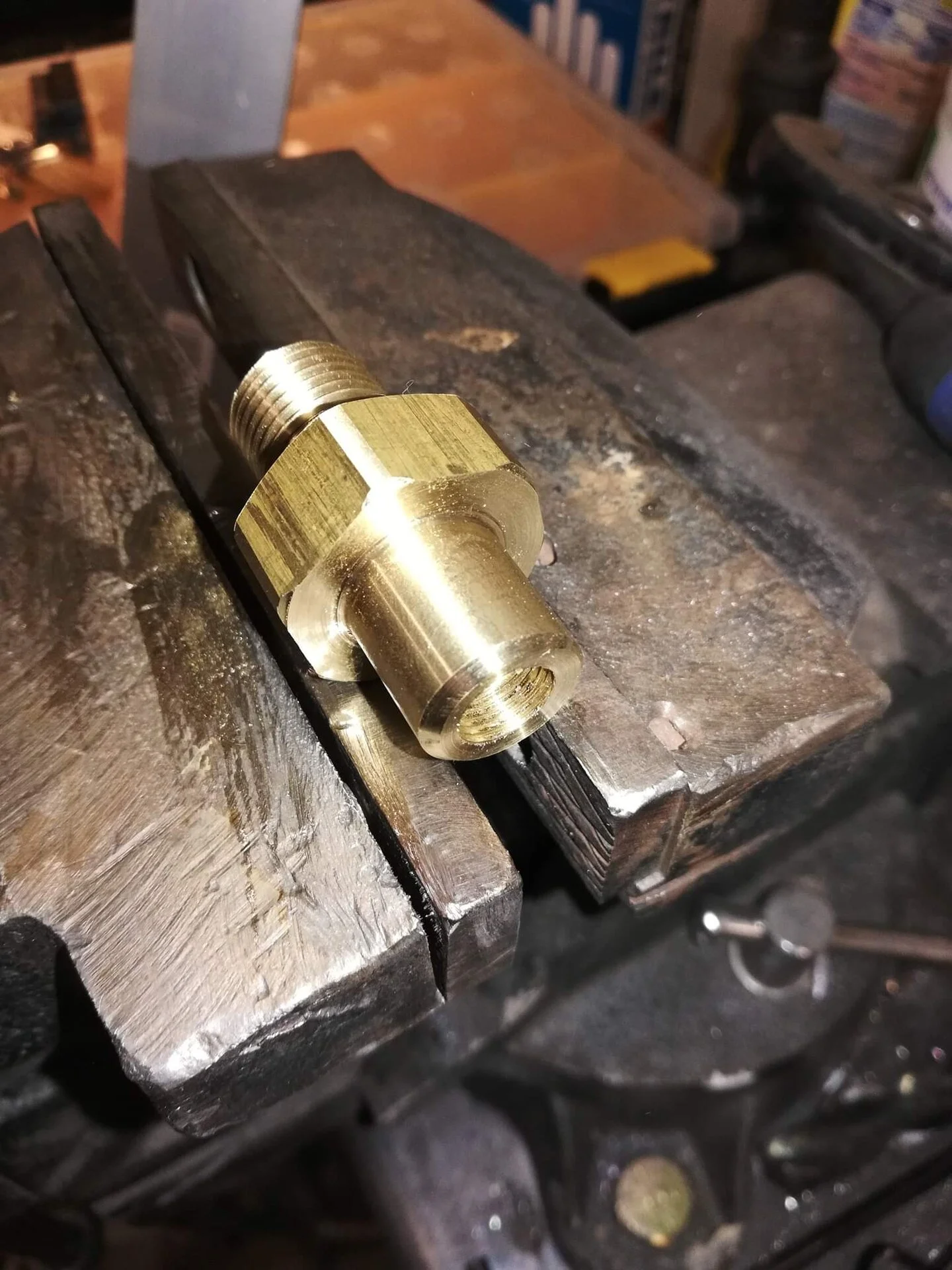

I turned a custom brass adapter for my oil pressure gauge.
But there's an adapter available that lets you run both the Toyota and GM sensor off the same port.
View attachment 3192597View attachment 3192597
So what I'm going to do is either put the GM sensor in the stock location and the Toyota on the oil pan (or vice versa) using this.
