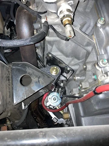

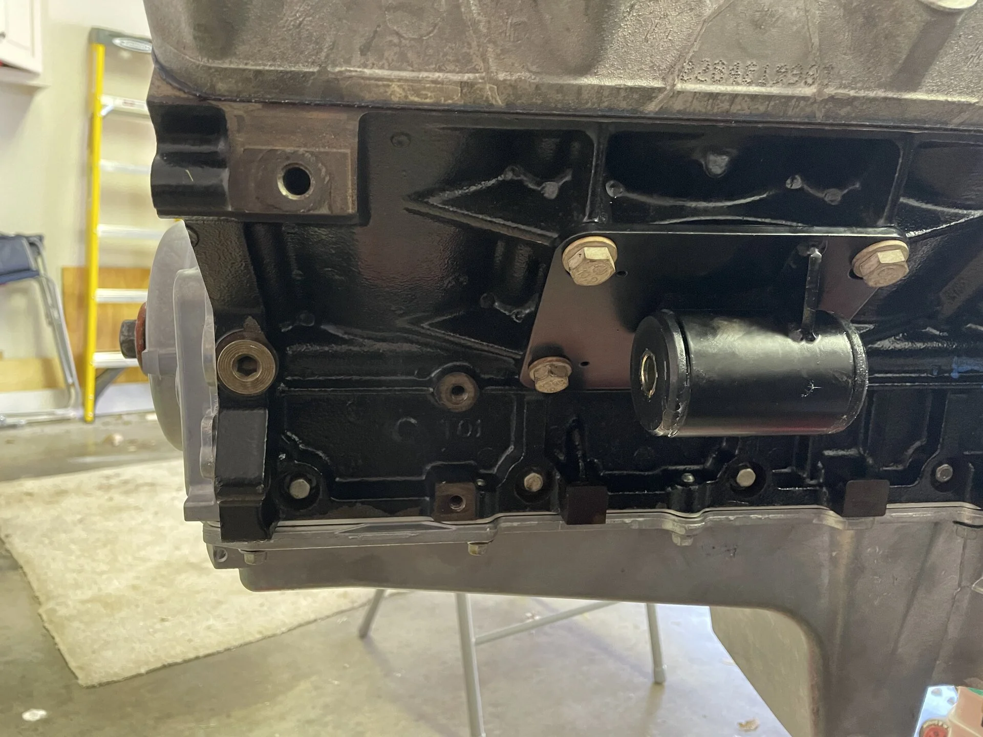

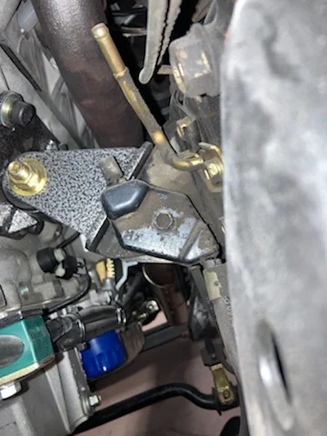

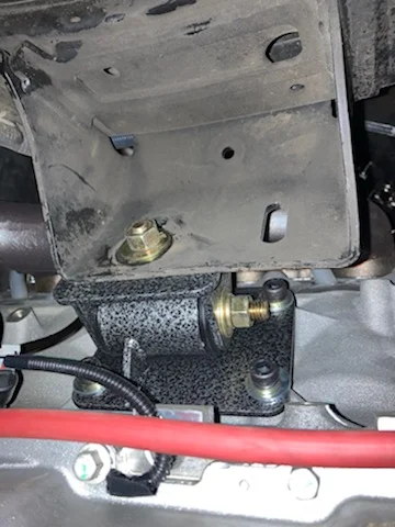

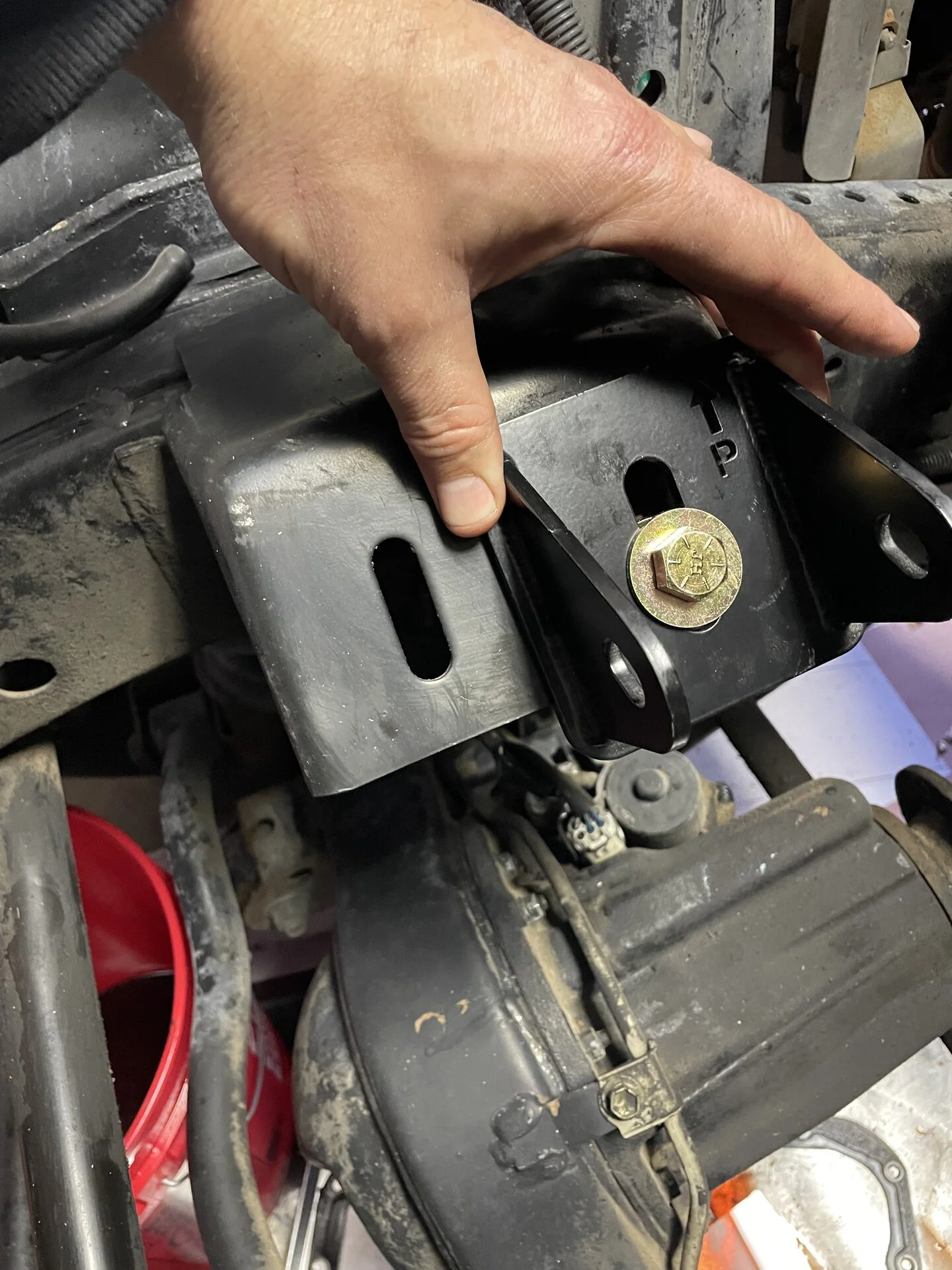

Anyone use LandCruiser Shop aka Selkirk Offroad engine mounts. Trying to get a little clarification on install. For the vehicle side do you just bolt them up, or do you need any of the original mounts, and on the engine there is an offset. You could flip the engine side mount around which I would think would move the engine forward or rearward. Thanks for any insight.
I called Selkirk Offroad before installing mine. Here are the pics they sent me.
I bought two bolts, two crush washers, four washers, and two lock nuts.

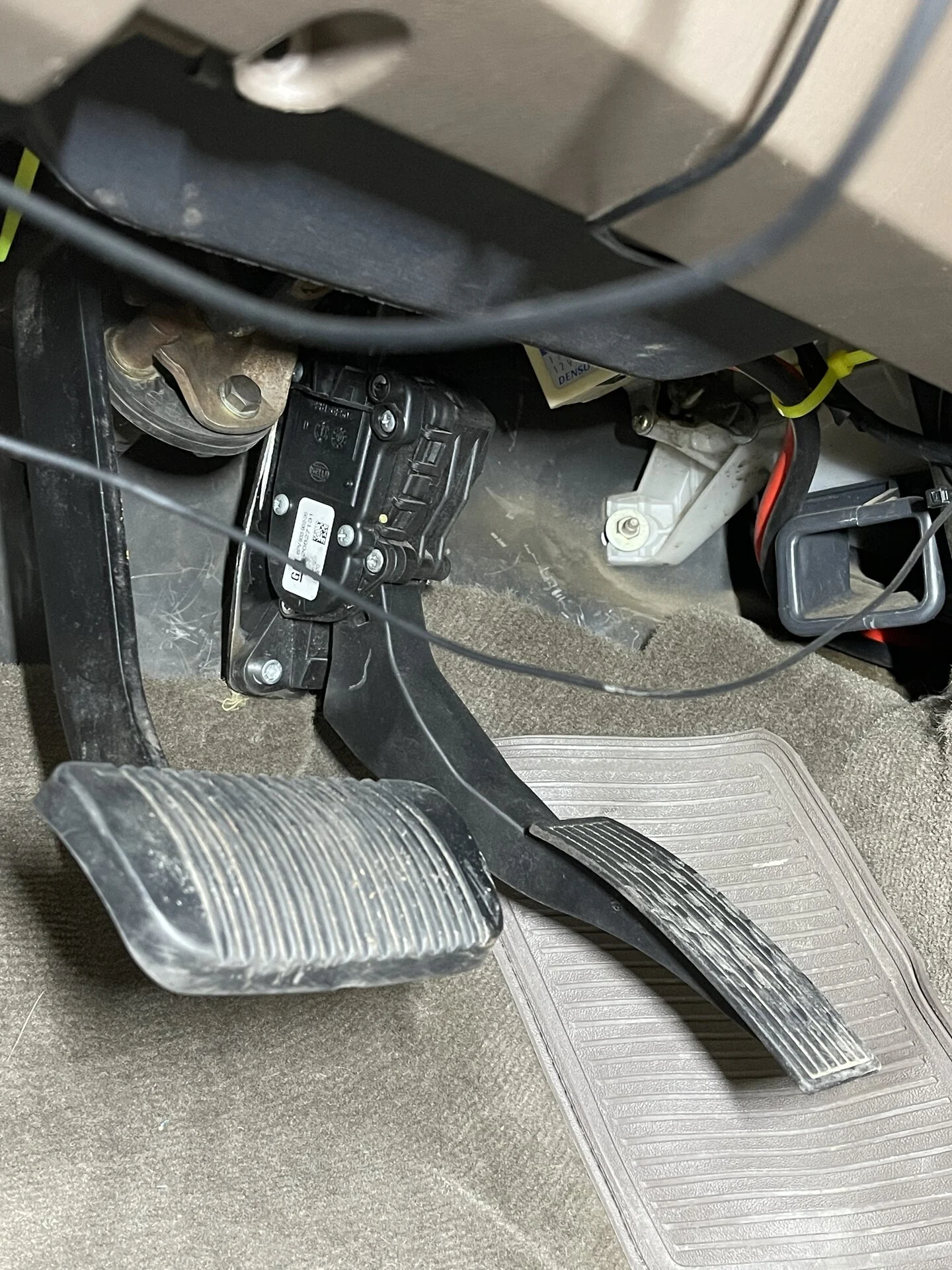

Curious how people mounted the gas pedal for drive by wire. More curious about how they for the angle right.
Don’t do what I did. Don’t forget to RTV that adapter to the tranny. I kept thinking my trans oan was leaking.
Got the gas pedal mounted tonight.
Update...I totally built a new mount for this...what a PITA...I needed the stability for road rage.

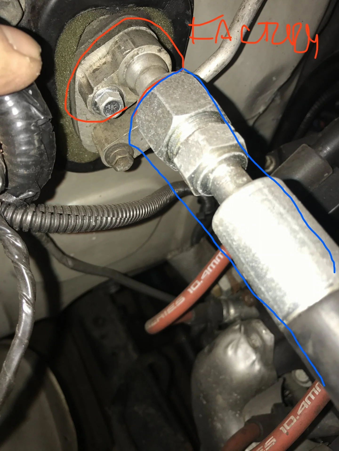

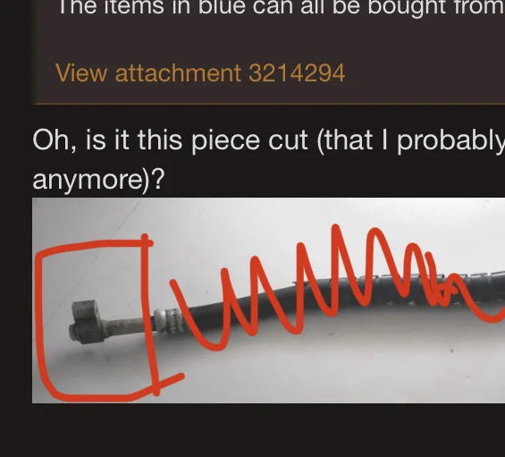

Could someone dumb down this connection for me? I haven't looked at it yet on mine (maybe it'll be self explanatory then), but I'm confused how and what the "coldhose 12MM Tube to #8 Hose Straight Compression Fitting" is connecting to what piece, where do I get that piece from, and how do I connect them together? 🤷🏽‍♂️
Thanks in advance 🙂
Thanks in advance 🙂
It’s connecting to a factory hardline fitting that bolts to the firewall in your pic. The factory pipe is cut off the fitting and the parts ordered from Coldhose (<—-that’s a company name) are mated to it via compression.
Doing a 60 body on an 80 chassis. Are pics for 80 engine bay?
I don't think those will work for you. Plus you have the welder out anyways, use a real engine mount and not a cheap leaf spring bushing. Been there, done that, it doesn't last

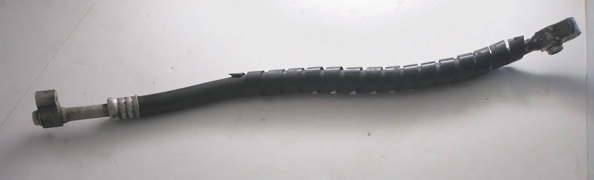

Oh, is it this piece cut (that I probably don't have anymore)?
Then would I tread or flare the end?
You need this:
It’s a compression connection using a ferrule. Somewhere on here I posted a list of all the items needed to make up the hoses including the tool to make the crimps.
