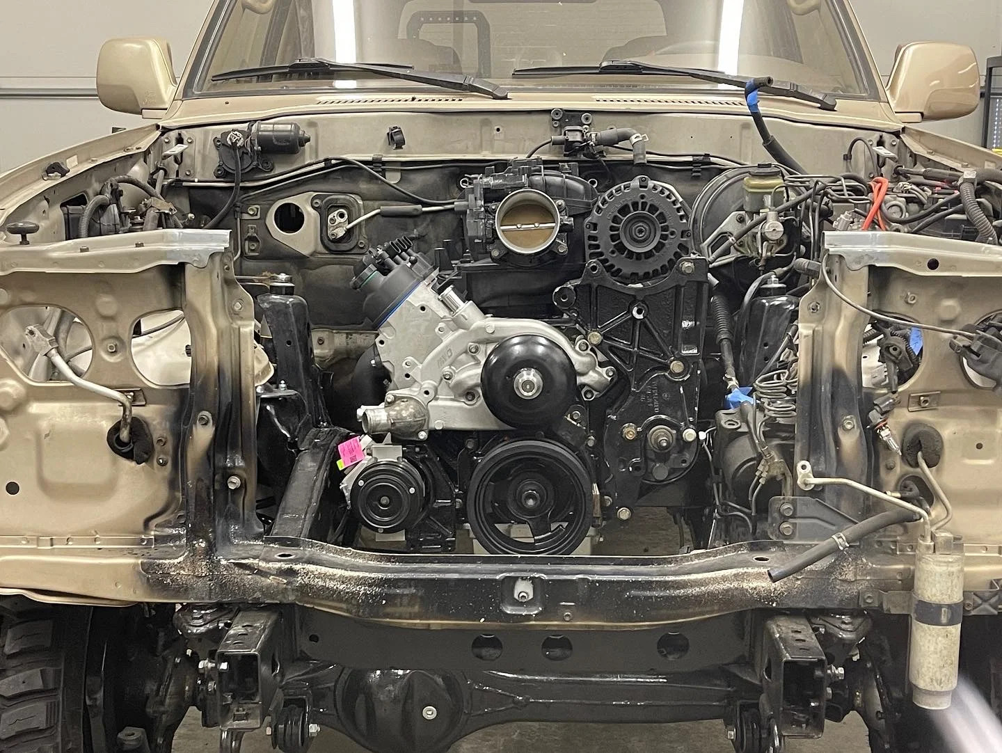

Hey everyone, big day for my swap. I got the motor and transmission pulled out. With just my 8 yr old helping it was quite the challenge. My question for the group is, I have to put on a lift kit, do brakes, and full front birf rebuild. Debating on how much to do before I put the new motor in. Not sure if any of it will be a particular challenge or not with a motor installed. Thanks for the inputs.
A small lift will help with front driveshaft clearance.
None of it needs to be done or is any easier while the engine is out.
No offense to that cabledude.
installing at least the front part of the lift is easier with the engine out. Access to the shocks and springs is much easier.

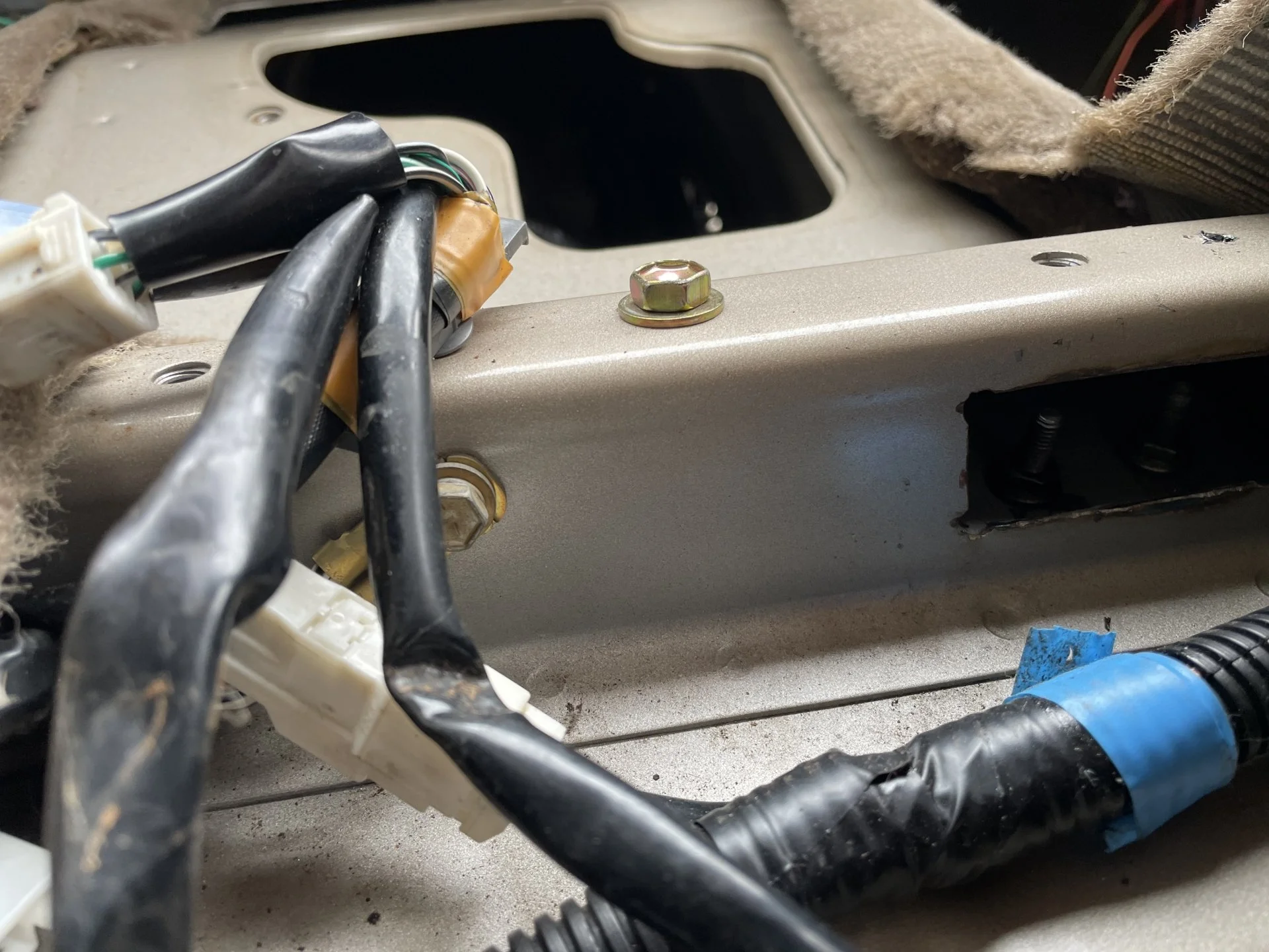

where did you mount clip on bracket for cable
I cut a square hole in the sheet metal “truss” and drilled two holes to mount an L bracket.
I would not mount it here again. In fact I’m sure i have to change it once I figure out how I’m going to solve the cable travel issue of not engaging 1st gear. I was on a time crunch to get it drivable.

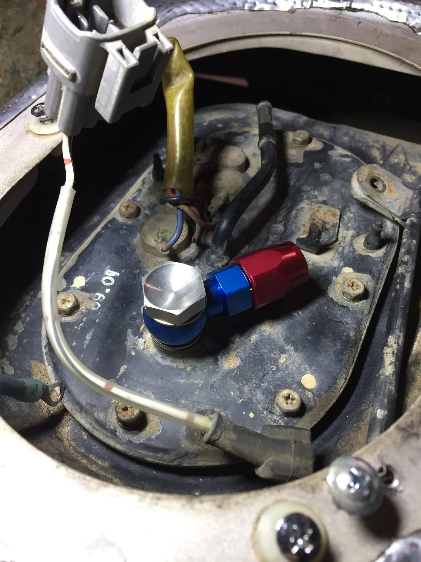

Decided on the following for my fuel pump/rectifier. Fuel Pump & Fuel Filter & Pressure Regulator. There isn't much room for AN fittings on the top of the tank so I hope to tackle that today/tomorrow. Haven't seen much on here...if anyone has images or writeups on what they have done...would love to see them. I am choosing to use new fuel lines to avoid issues that a few others have with cooking the fuel as it returns to the tank next to the new exhaust. Side note...hoping to start the engine for the 1st time on Sat. Lets hope all goes well.
I have a shared an Earl’s banjo fitting that fits like factory on top of the tank a few times.
Can also get an adapter to go frome the return line to 6an its a barb fitting to 6an. You will have a short rubber fuel line make sure to get the fuel injection rubber line other end will be male 6an.
