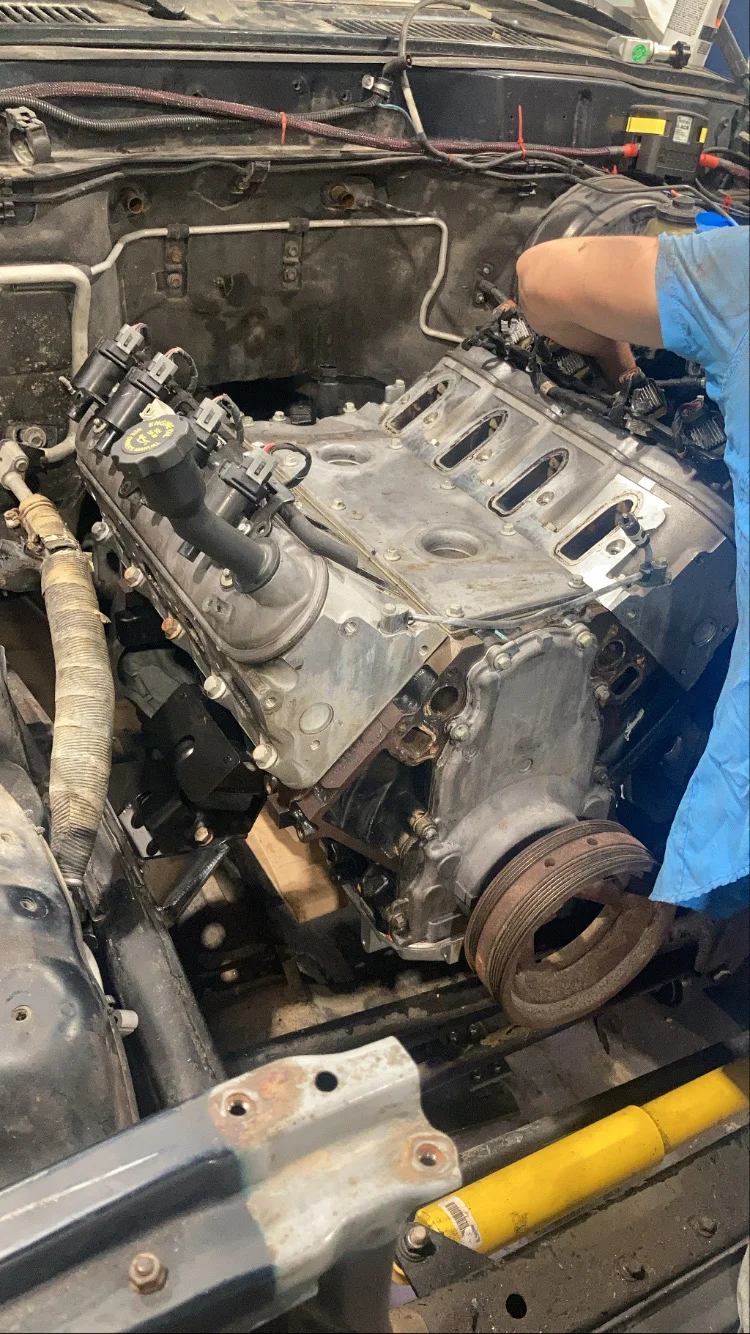

Got the engine bay cleaned and ready for the test fit. Unfortunately I no longer had the factory motor mounts to test fit today. With the front clip off the motor flew in with no fuss at all.
And just noticed I didn't take any after pics. So if pics or it didn't happen I have done nothing to my truck.

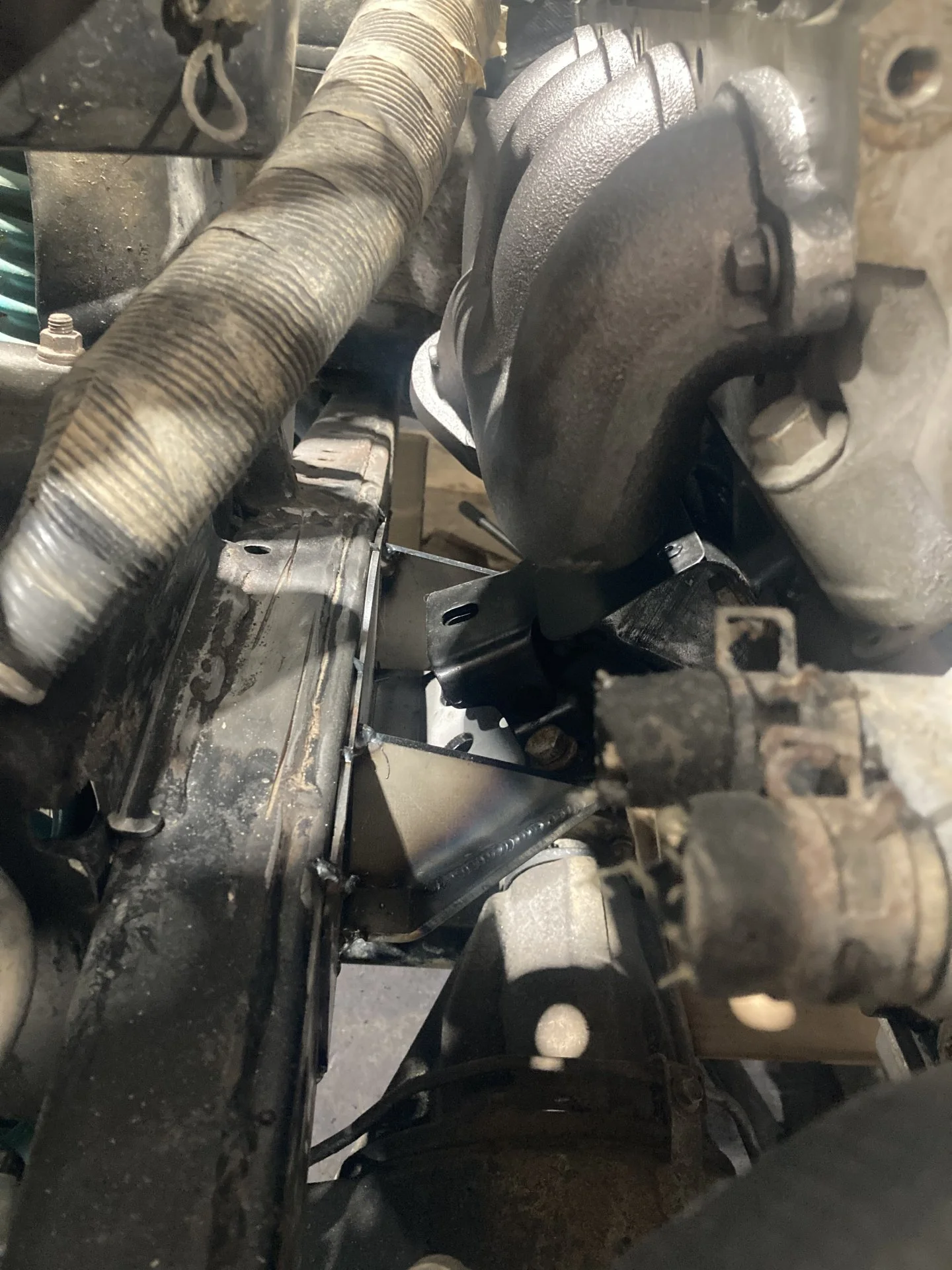

Couldn't find any when I started my LS swap on a 91 FJ80 in early 2021. Not saying they aren't out there, but I couldn't find them. Weld in ones are abundant if you have access to a welder or know someone who can weld for you.
I ended up going with the ones that came with the Mark's adapter kit. They needed to be swapped left to right (LHD vs. RHD) and needed some modification to work well, so they aren't a simple solution.
Good things have been said about the Dirty Dingo mounts, but I've got no first hand experience with them.
Words of painfully gained wisdom... tack the mounts in first and then check, double check, (take a nap) and then triple check ALL clearances (including the hood to intake and accessory pulleys to frame rails) before final burn in. :bang:

Yes, started at the cross member to position everything. The Mark's adapter kept the HF2A transfer case in the OEM position, which was attractive to me. However, I utilized a 6L80E, so it may be different for the 4L trans. The guys at Mark's were very easy to deal with and super helpful in sorting everything out on the phone.
Just jump in and getting going on it. It's the single best thing I ever did to my 80. Totally transformed the truck. It's a hoot to drive now!
PM me if you have any questions.
@cruisermatt has motor mounts he makes and sells. I don't know if they bolt in but he has a lot of swap experience.
Definitely not bolt-in. But IMO they are worth the effort.
80 series mounts are not currently for sale, hopefully soon once I get my site up.
