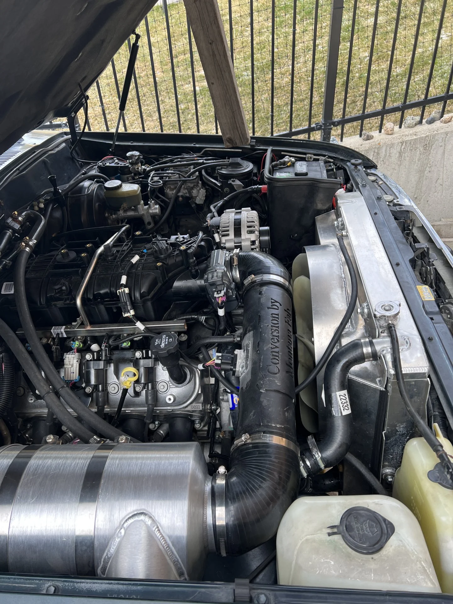

Need some help getting MAF to work.
Setup: L96 crate engine with GM performance harness. (not relevant but 6L80 with tap shift ;)
using 4: aluminum tube with MAF 10" from throttle body. The harness instructions state the MAF must be 10" from the throttle body and at least 3" from upstream bends. the MAF is 6" from upstream 90 bend.
I don't see any reason my MAF readings are low, but the engine won't run right with the MAF plugged in. Will run just fine on speed density mode (default if MAF unplugged).
getting P101 code for low reading. The engine won't stay at idle rpm and jumps around.
I thought I was getting heat soaked from the radiator hose which was running over the top of the air intake tube, but I re-routed the radiator hose and bought a new MAF sensor. still having the same issues.
I am completely bewildered...
Any ideas????

Intake tube needs to be the correct diameter or the maf will read incorrectly.
