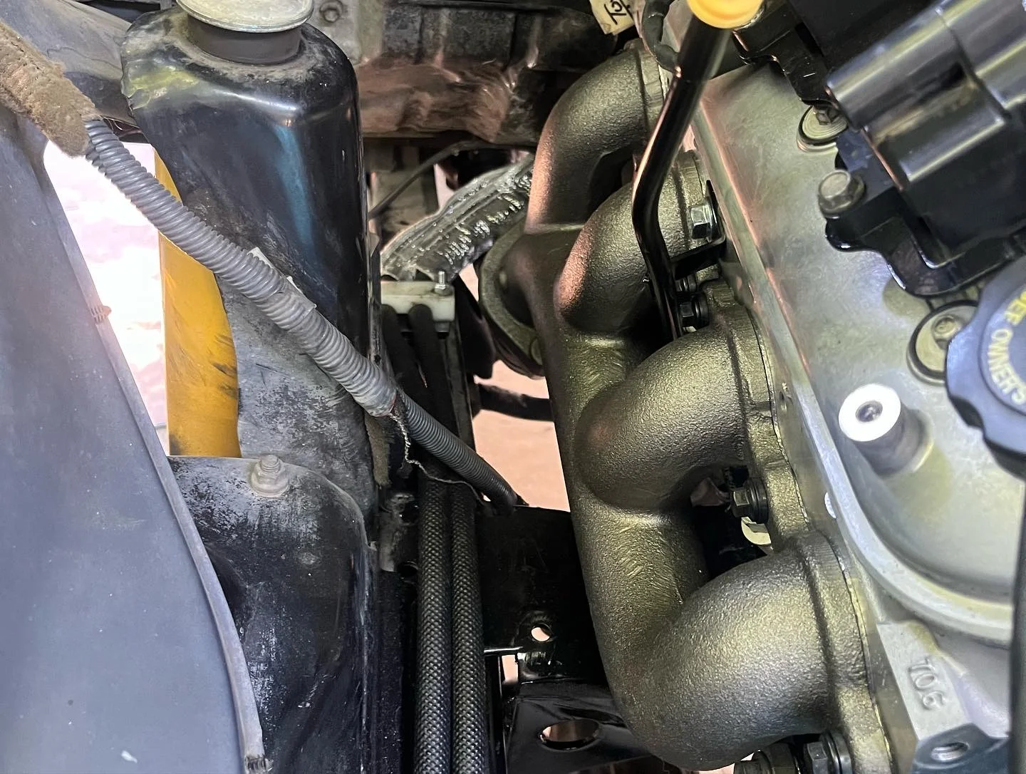

Looks great! Do you have the model number on those Hookers? Thanks.
Summit sells a "knockoff" that's about half the price of the hookers.
I saw that thanks. Just curious to compare to se le how much they are charging for the coated version.
Personally I wouldn’t bother. Spray the raw ones with VHT “Flamethrower” to prevent rust and call it a day

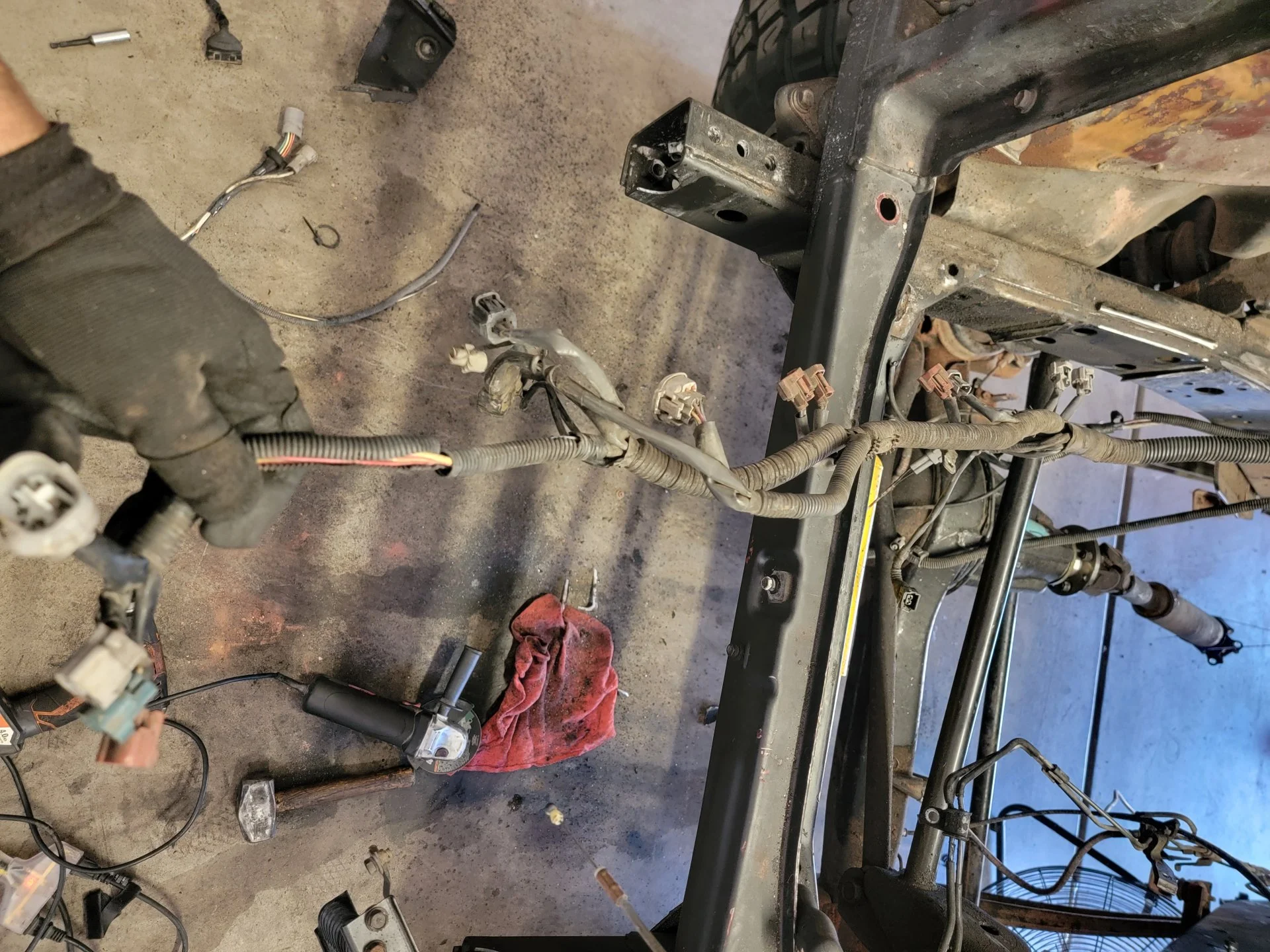

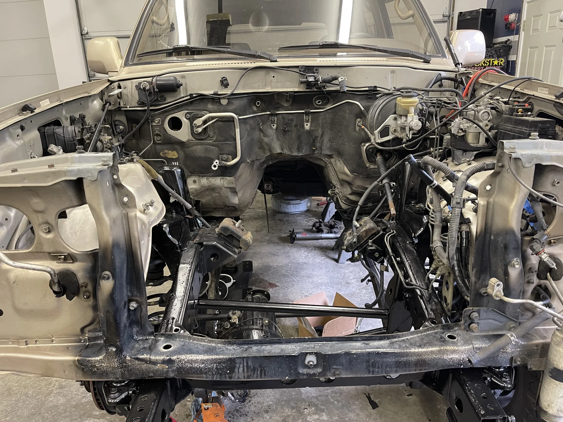

Trying to clean up fj80 engine harness, keep coolant temp wire, oil pressure wire, tcase harness...cut the rest? Swap has a standalone harness
Is that the harness that goes into the oil pressure connector, washer bottle pump? If so, keep it. I’m finishing up my swap and was glad i didn’t cut off a lot of connectors. I’m waiting on my old engine harness to pull the trans wiring out that goes from EC1&EC2 to IH1
Yea, maybe I'll just throw the swap in 1st and trim old harness after it's going.

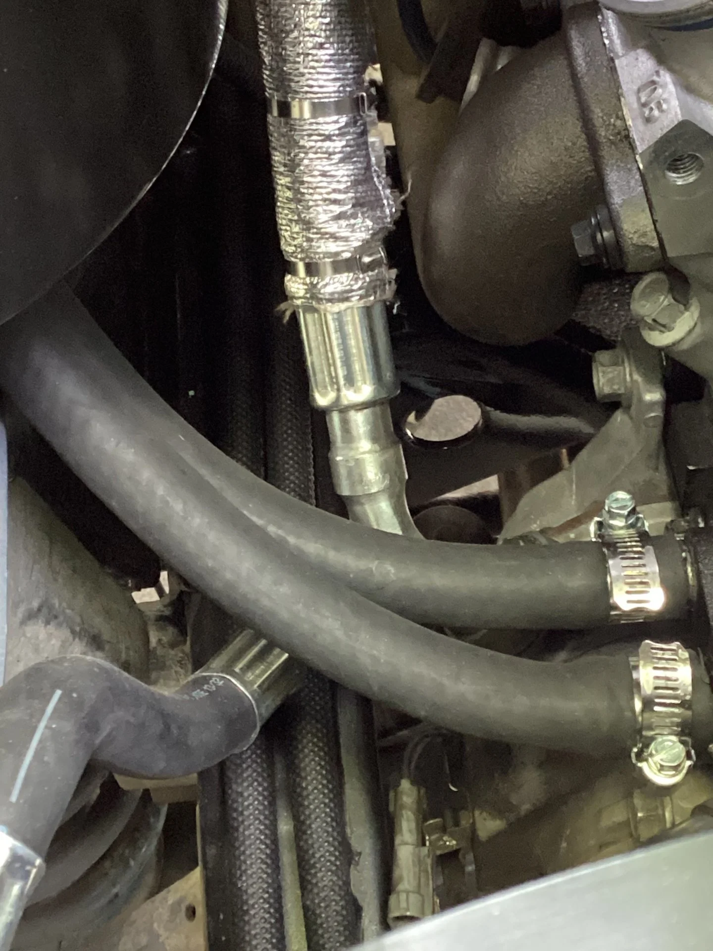

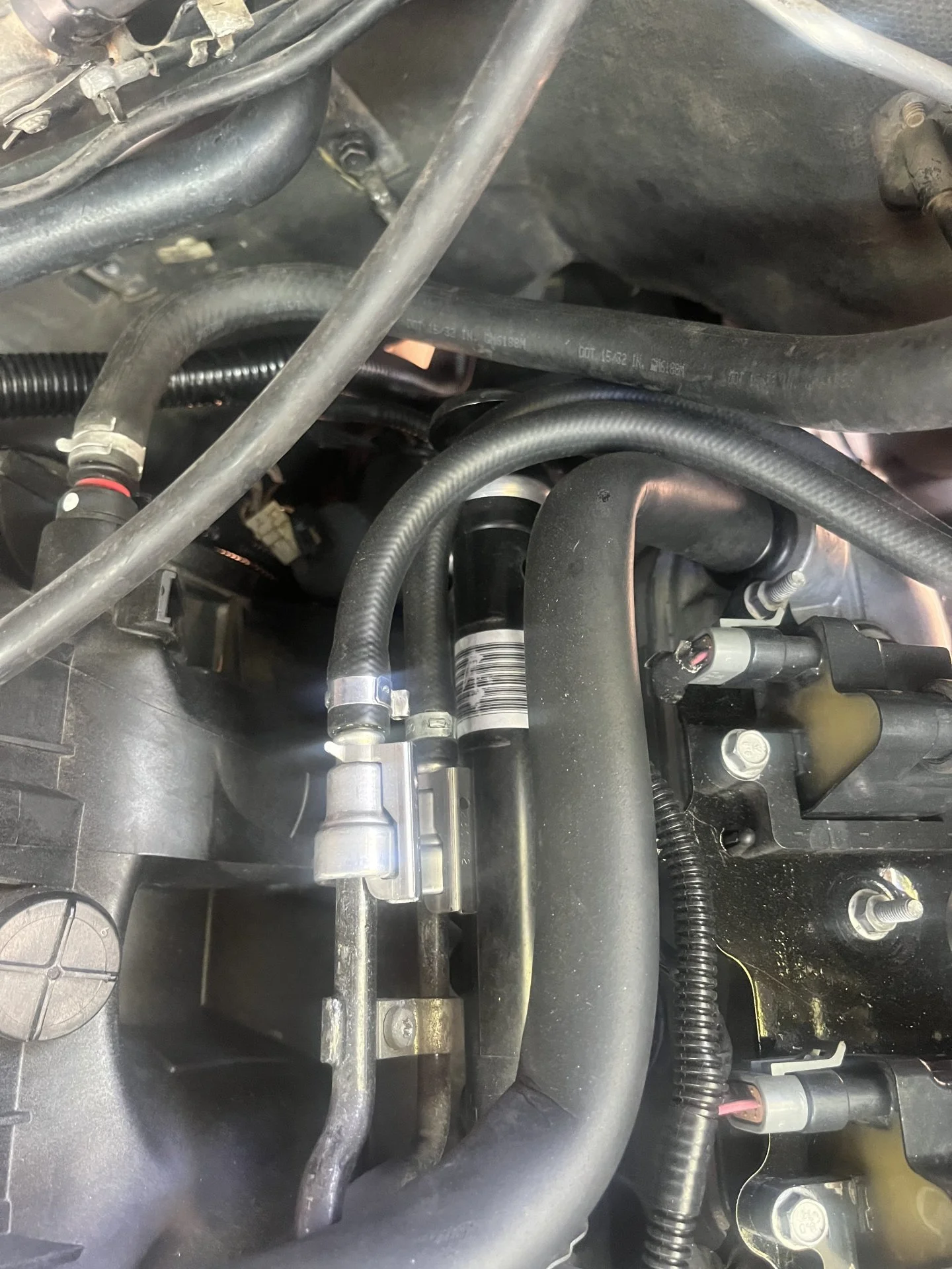

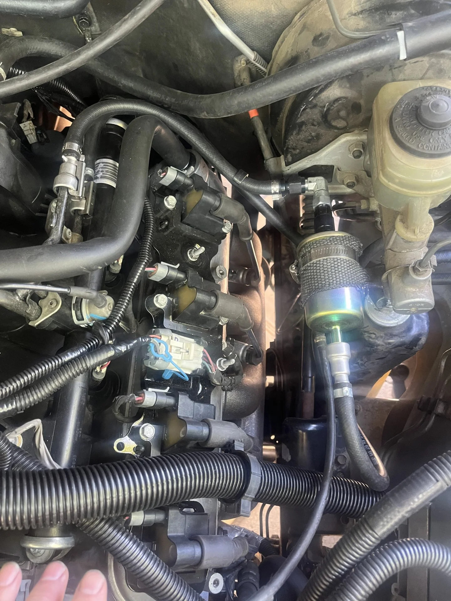

I used the 2 ends from the donor. I cut off the old/original hose and it is barbed. Bought the 2 fittings on the back of the filter and went to auto wrecker for another Chevy end. Cut the old/original line off the Toyota side and it’s barb’d too. Used otyiger clamps all all ends
I used the 2 ends from the donor. I cut off the old/original hose and it is barbed. Bought the 2 fittings on the back of the filter and went to auto wrecker for another Chevy end. Cut the old/original line off the Toyota side and it’s barb’d too. Used otyiger clamps all all ends View attachment 3017510

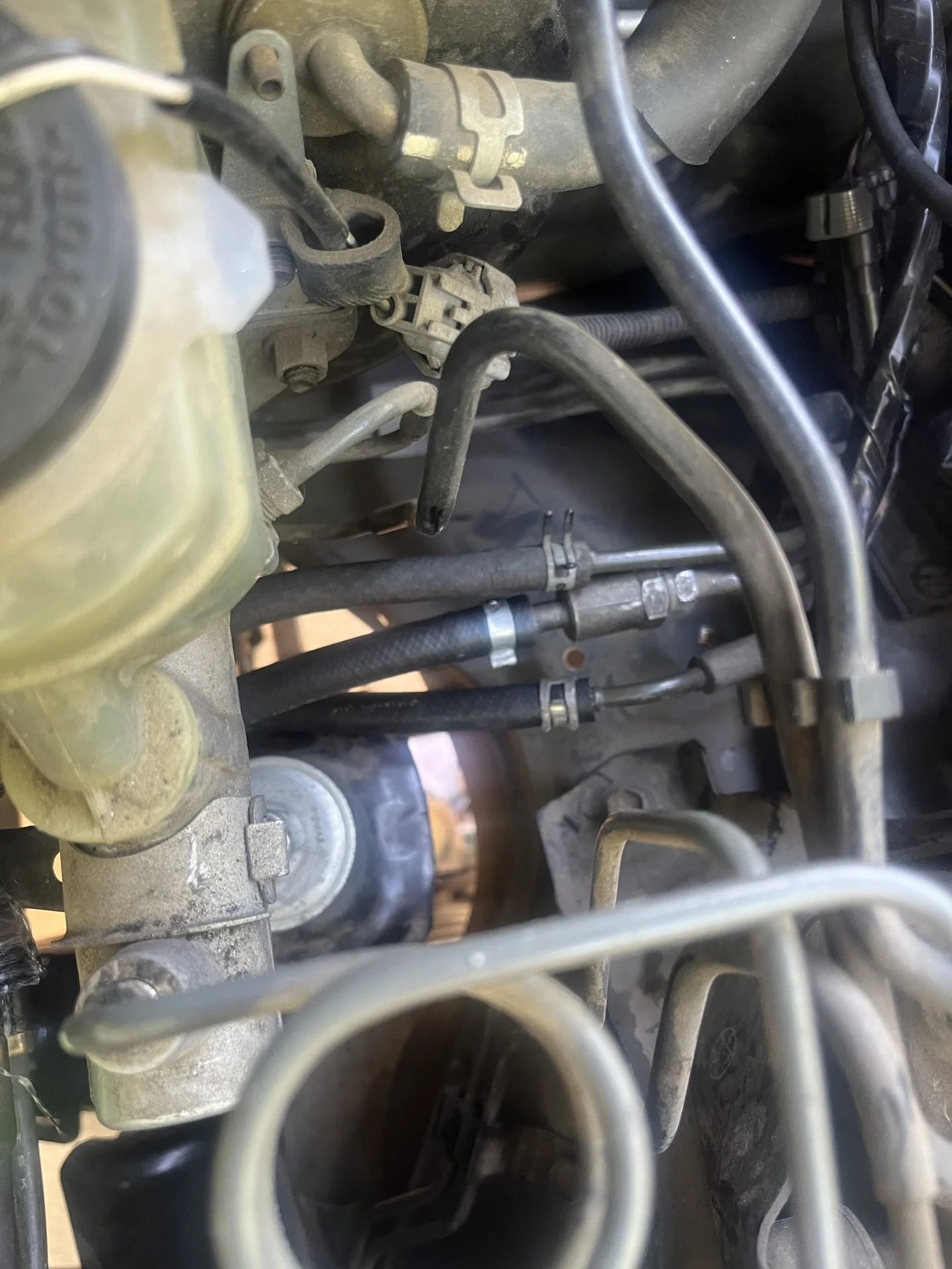

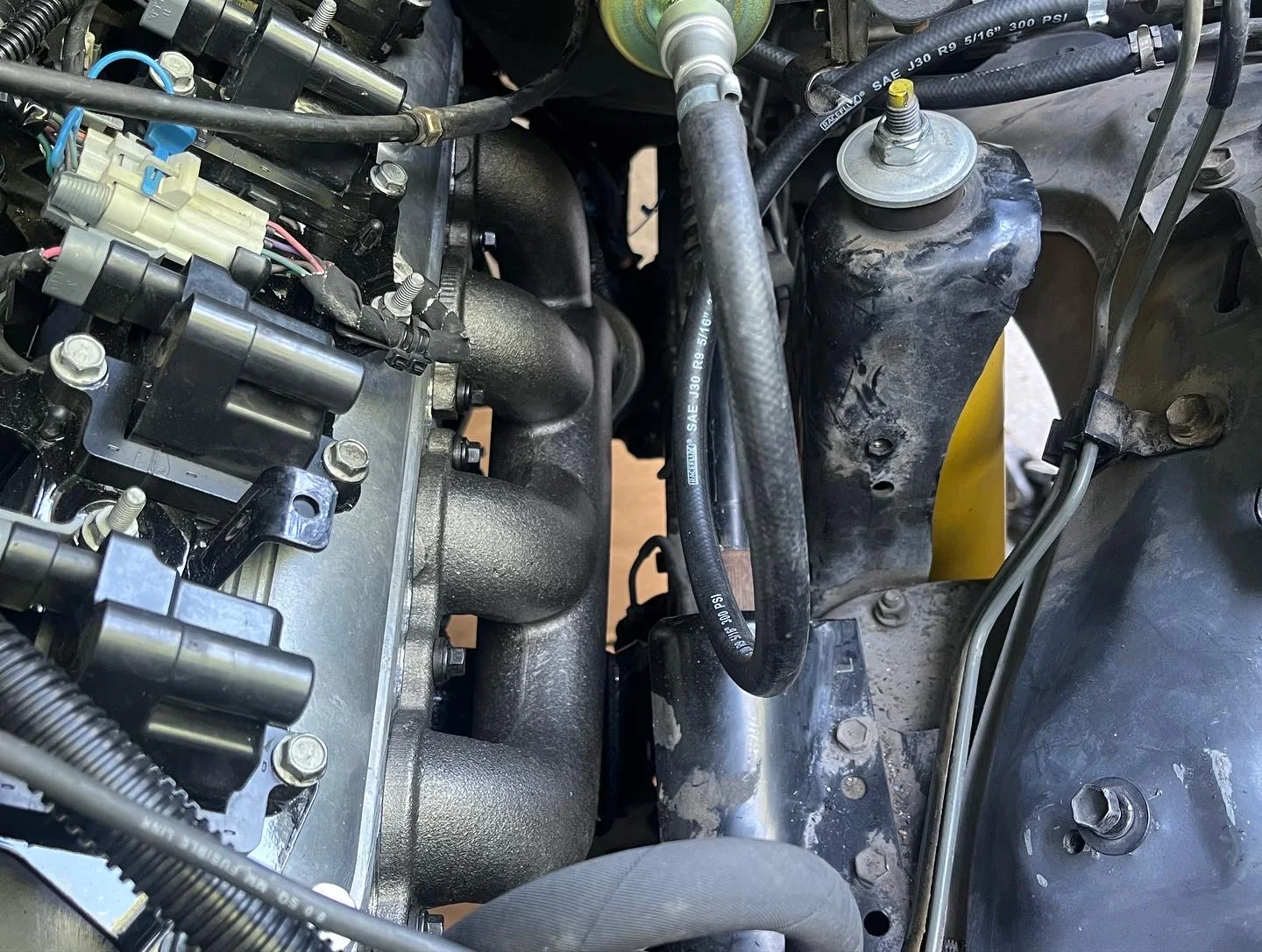

This may cause issues. I had my fuel filter mounted to the fuel rail. Used the stock feed and return. Had a vapor issue. By the time the fuel on the return side got back to the tank it was vapor. Basically vapor locking. It messed up the fuel pump too.
This may cause issues. I had my fuel filter mounted to the fuel rail. Used the stock feed and return. Had a vapor issue. By the time the fuel on the return side got back to the tank it was vapor. Basically vapor locking. It messed up the fuel price no too.
I will remember this. I’m still on the final part of my swap. If I run across an issue, I will look into this.

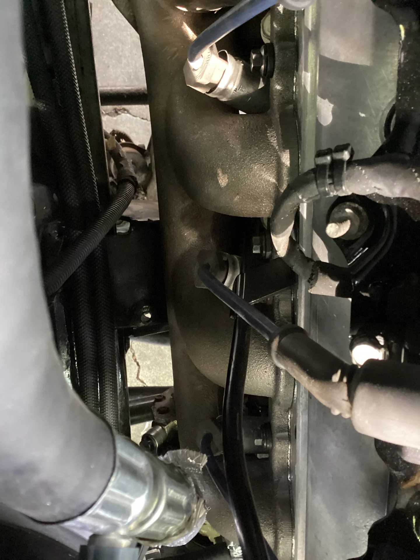

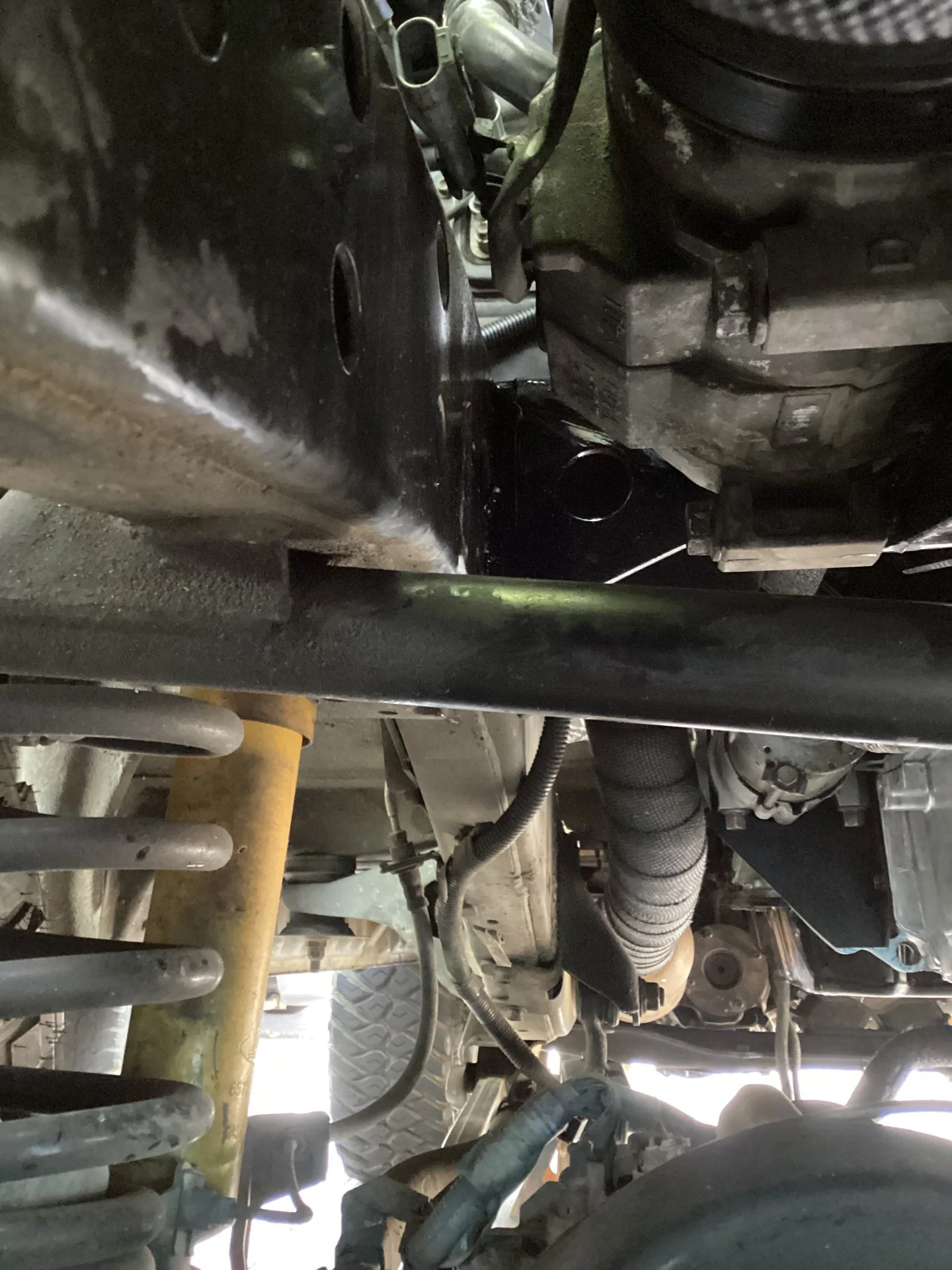

This looks great. I will def order these....That engine mount almost looks stock. Did you just re-work the original?
The engine mounts on my 96 were in the right spot for the mounts I bought. They were made by The Land Cruiser Shop. They were made for ls into 1FZ based LC. The passenger side frame mount has to mount holes. It bolts to the rear one. I trimmed the mount to fit the a/c compressor. Took roughly 3” out
Using the land cruiser shop mounts, you had to cut the passenger side factory frame horn to clear the ac compressor? Do you have a picture of this?
Yes I did cut out about 2-3” from the passenger mount, so the A/C has about an 1” of room behind it. Pictures aren’t the greatest, sorry. I cut the front end off, then removed a section, then rewelded the end back on.
i used same fuel line clamp and it ended up leaking so i went with regular screw type clamp and no problems any more
