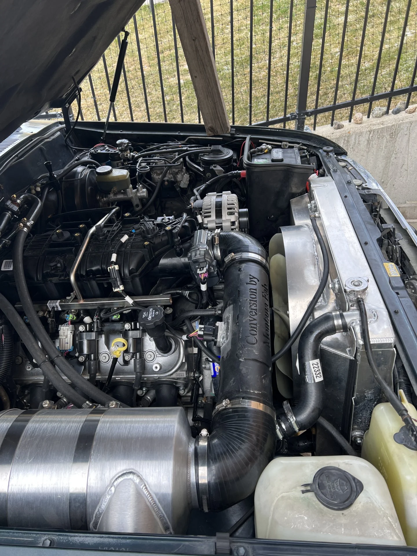

Need some help getting MAF to work.
Setup: L96 crate engine with GM performance harness. (not relevant but 6L80 with tap shift ;)
using 4: aluminum tube with MAF 10" from throttle body. The harness instructions state the MAF must be 10" from the throttle body and at least 3" from upstream bends. the MAF is 6" from upstream 90 bend.
I don't see any reason my MAF readings are low, but the engine won't run right with the MAF plugged in. Will run just fine on speed density mode (default if MAF unplugged).
getting P101 code for low reading. The engine won't stay at idle rpm and jumps around.
I thought I was getting heat soaked from the radiator hose which was running over the top of the air intake tube, but I re-routed the radiator hose and bought a new MAF sensor. still having the same issues.
I am completely bewildered...
Any ideas????
Curious…did you go with the stock GM oil pan or did you switch to the Camaro Fbody pan? I am right there with a L96
Last gen 4 intake I measured had a inside diameter of 3.35" at the maf. But your style might be designed for a different size.
The crate engines seem to have standardized parts. It uses the ls3 MAF sensor and the instructions say to use 4”.
I’m gonna try temporarily removing all 90 angles to see if it’s a turbulence issue.
Anyone have a factory solution for this problem?

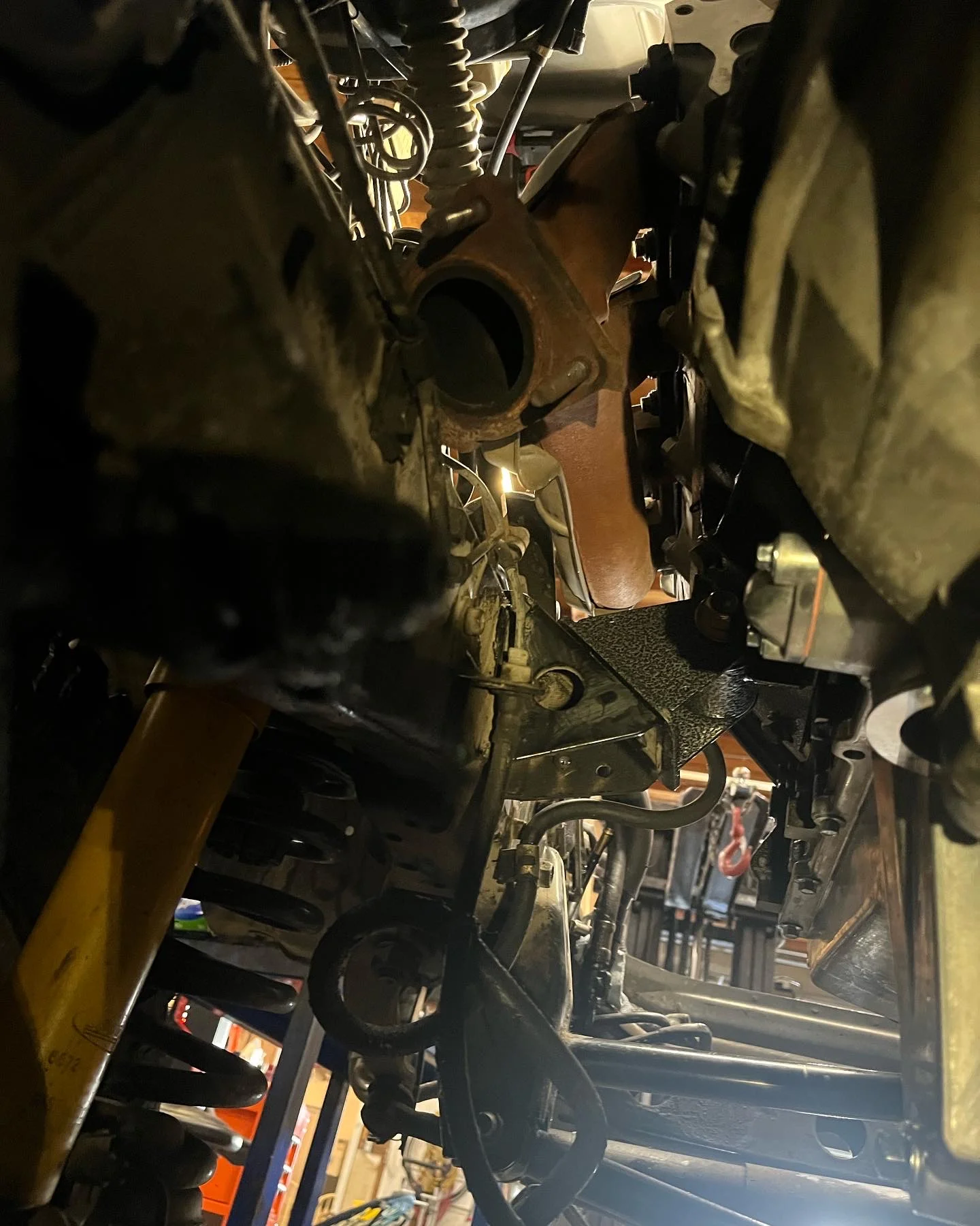

I bought a set of corvette center dump ls3 manifolds while I was doing my swap. They looked like they would need a bit of trimming on the flange but would most likely work. I didn’t end up using them as my motor needed an egr valve to make California legal. I’ve also heard ctsv manifolds would work but I would do some research on them.
Summit manifolds and add the OEM heat shields.. like the guy a few pages back did
