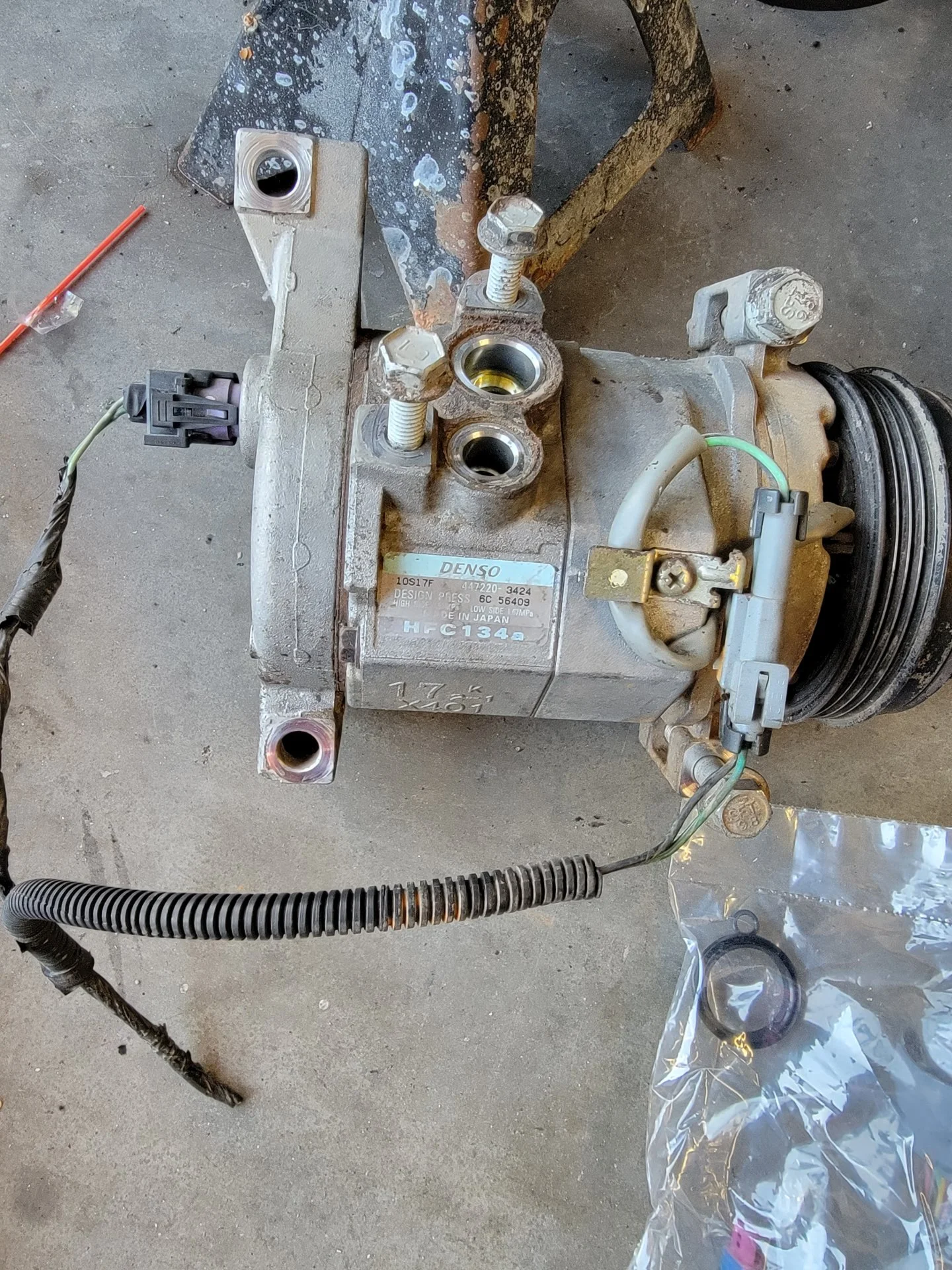

… I trimmed the mount to fit the a/c compressor. Took roughly 3” out
Thanks for sharing this. It didn't occur to me that that the a/c compressor would contact the passenger side frame horn when using truck accessories and TheLandCruiserShop mounts. My LM4 is still on the engine stand being prepped for the install. I suppose I would have figured it out soon enough.
What made you decide to cut and weld the frame mount vs relocating (high mount) the A/C compressor?
Simplicity. Everything else sat perfect. That was the only spot where there was interference. I installed/test fit the motor 4 times

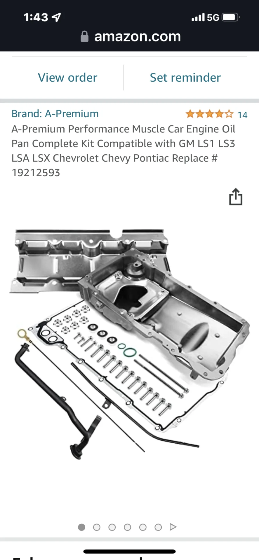

Thank you. Forgot to mention I'm thinking about a 1" body lift and 3"+- on the springs. Not sure what oil pan I'll wind up with, go with what others have found to fit. I like your heat wrap idea, keep things cool.
I’m on a 3”lift only and had no issues. Oil pan kit I used worked perfectly. I bought 1 and the pick up tube was too short, China one. I sent it back and got the one in this picture, works perfectly.

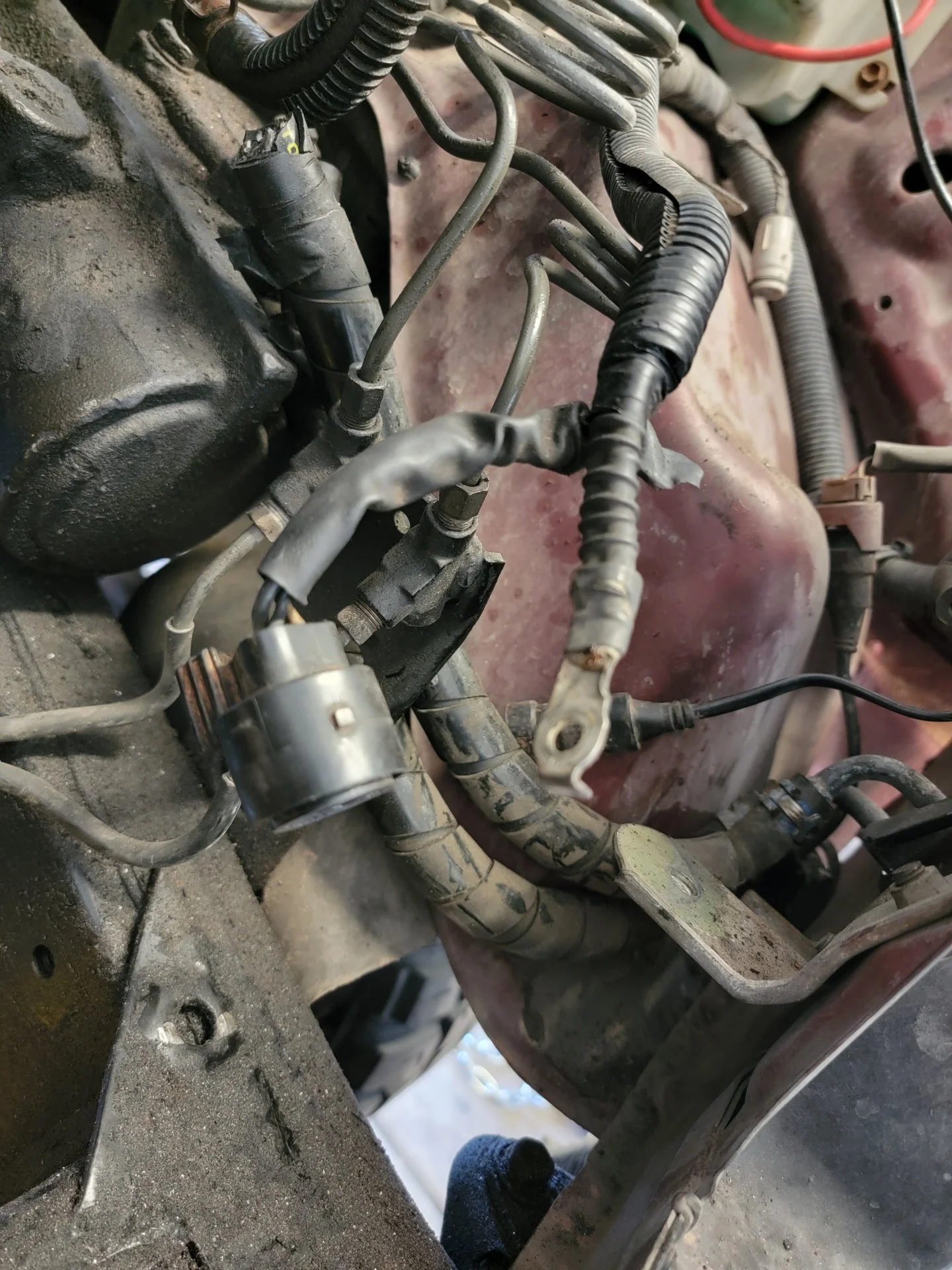

Anyone know which wire feeds power to fuel pump?
Or should I provide power somewhere else for the fuel pump

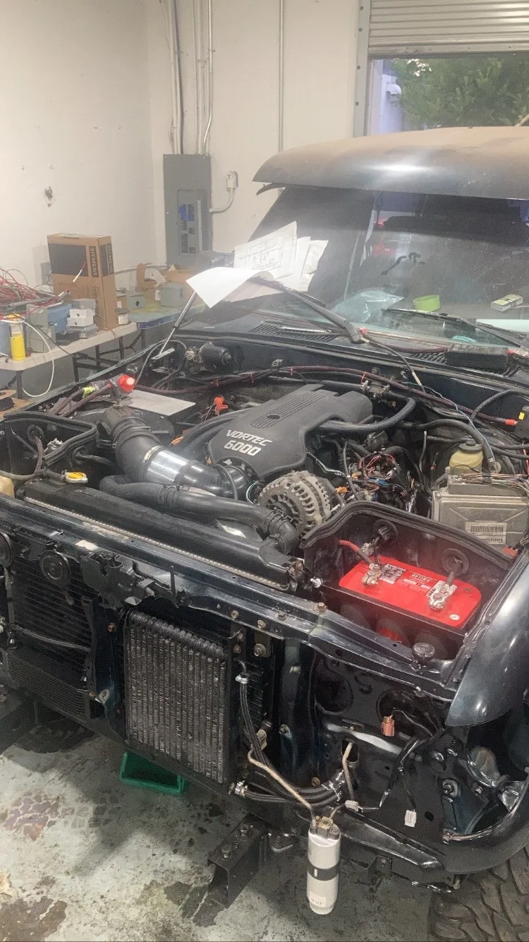

Another one just about done
