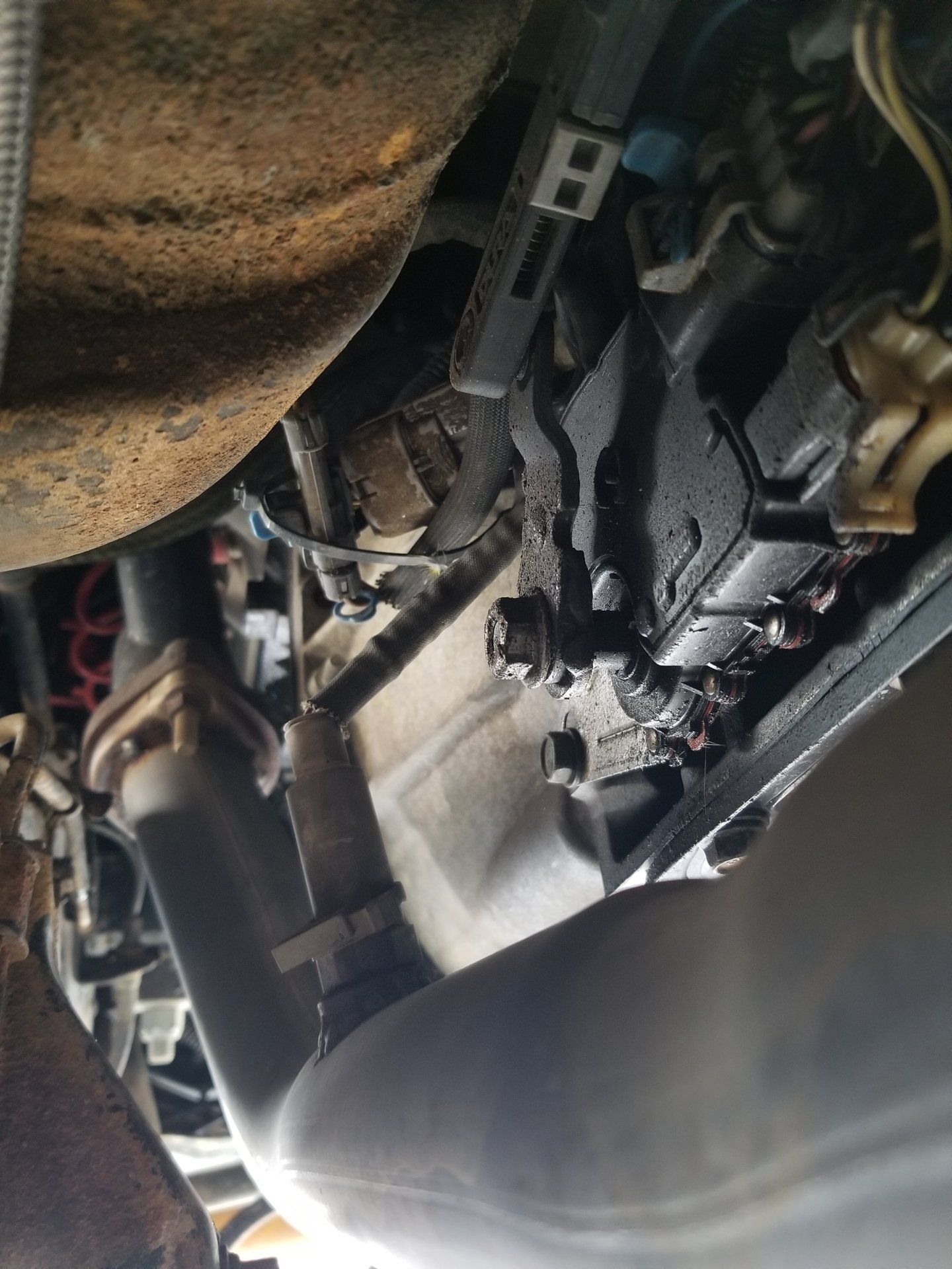

you can see some pictures how i did it page 2 and 3
i also made another bracket what i attached to floor i can't find pictures of it but it must be moved back enough so you sifter # matches the gear in the transmission it took me some time and you need two people for that fine tuning
