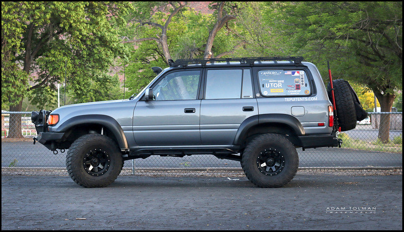

This is my 80 the day I installed the 75mm stage1 Slinky heavy kit.
IMG_0664_zpsdniw4tcs by Adam Tolman, on Flickr

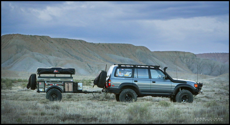

Here it is pulling my trailer the next day with the stage1. Still sitting very level.
IMG_1541_zpsuvk3nggx by Adam Tolman, on Flickr
