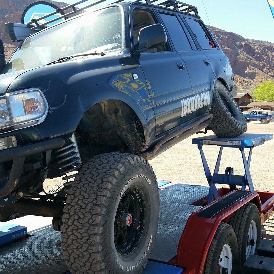

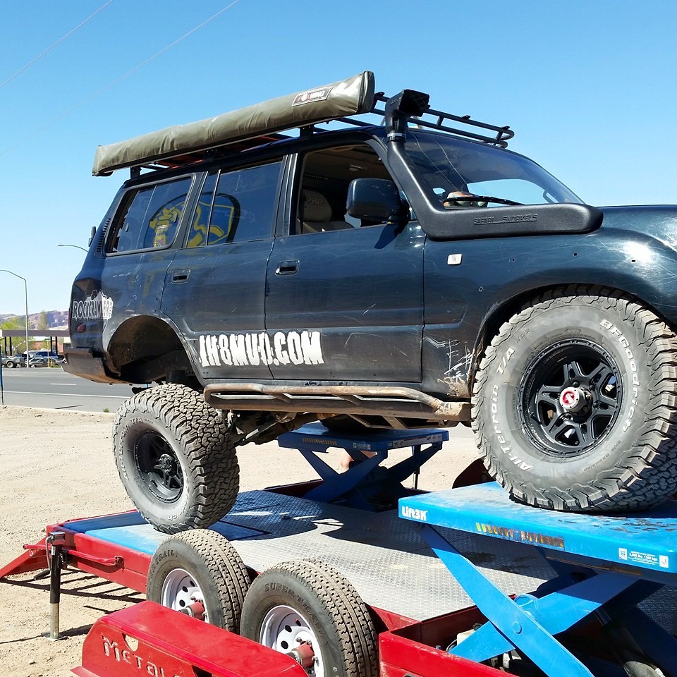

Yeah doesn't appear the Woodys truck is suffering from any lack of travel with the 50mm coils. ;)
Untitled by Adam Tolman, on Flickr
