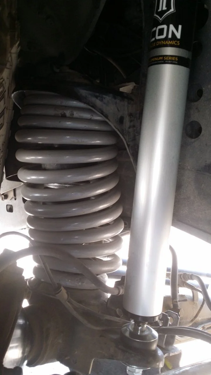

Quick & dirty shock report:
The specs on the mystery front Icons are 17" compressed 28.25" extended measured at the collars. End result is they are the same specs as my Doetsch Techs that I just took off. Mount to mount which is a more accurate way to measure is 19" compressed 30" extended.
I'm very happy with the end result of my set up.:):bounce::steer:

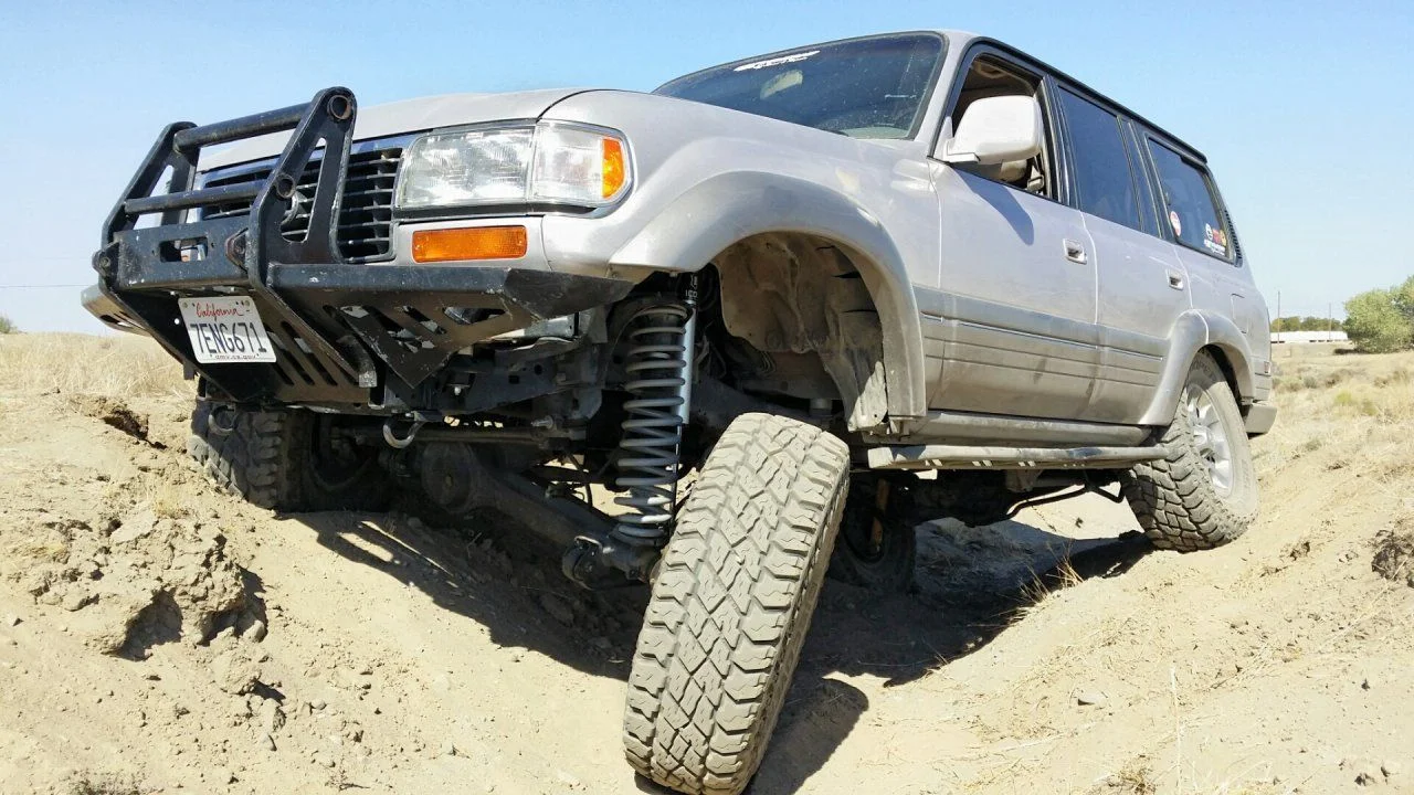

I had an itch on my way to the grocery store... so I had to scratch it.
I can't belive how big these fenders are... the 37"s can go up even more than this.
20160919_091434-png.1324128
Not to bad for a family wagon.
20160918_171425-jpg.1324129
screenshot_2016-09-18-17-16-13-png.1324132
Still have about 1" more up travel to go... my other coils would of been completely on the bumps here.
Still have about 2" more up travel to go... my other coils would of been completely on the bumps here.
