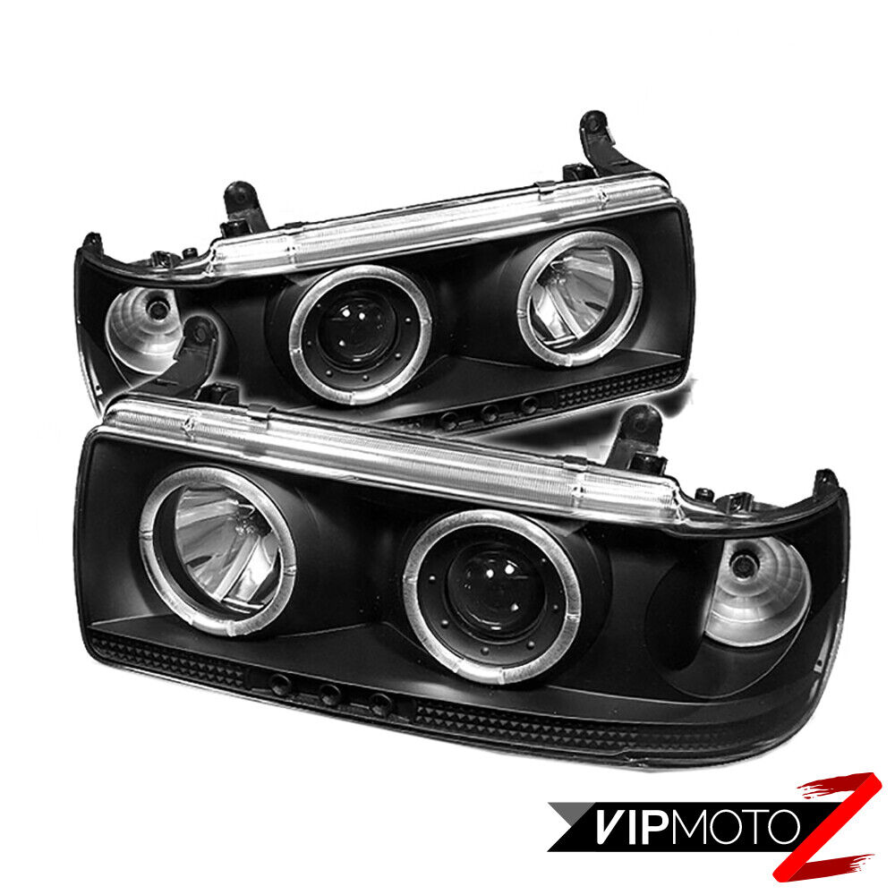

Has anyone had experience with the aftermarket Halo LED headlights where the entire unit is replaced. I noticed the lenses are plastic and not glass which I don't like. But what about functionality and brightness? I'm looking at something similar to the these ones.
Or should I just get LED bulbs to replace the stock bulbs?
Thank you

Has anyone had experience with the aftermarket Halo LED headlights where the entire unit is replaced. I noticed the lenses are plastic and not glass which I don't like. But what about functionality and brightness? I'm looking at something similar to the these ones. View attachment 3501088
Thank you
The units that you have pictured and other similar ones are junk. Cheap as hell, very soft plastic (pits and yellows quickly) and terrible light output too.
