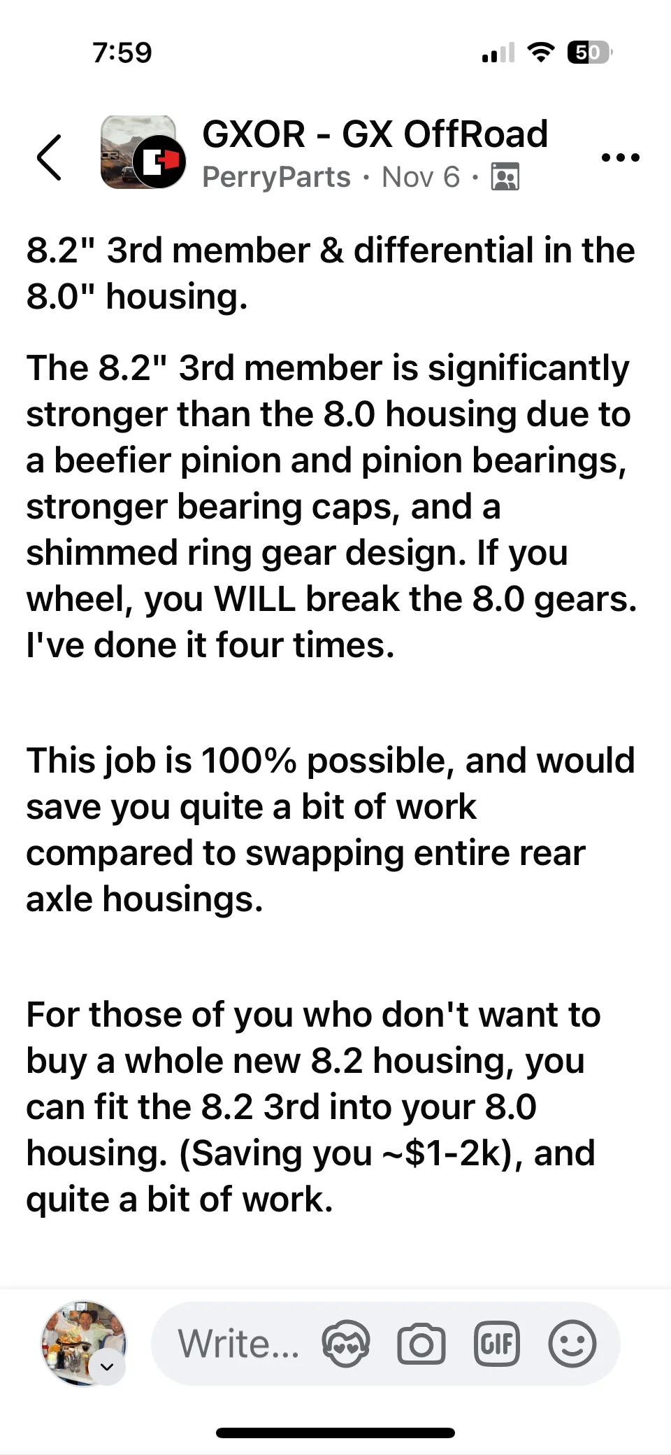

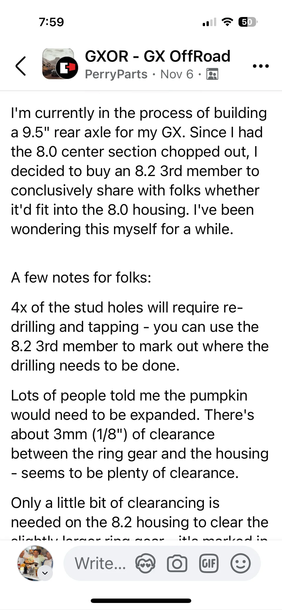

Will the guts of a 8.2" diff bolt straight into a 8.0" pumpkin?
There’s a post on FB GXOR whereby someone did this, but there were some mods required

They will fit, Ive seen this done. You just have to notch the 8" housing and tap a few extra holes for the 8" v2 to fit. Someone posted a write-up on here a few years back. It's basically the same overall housing.
