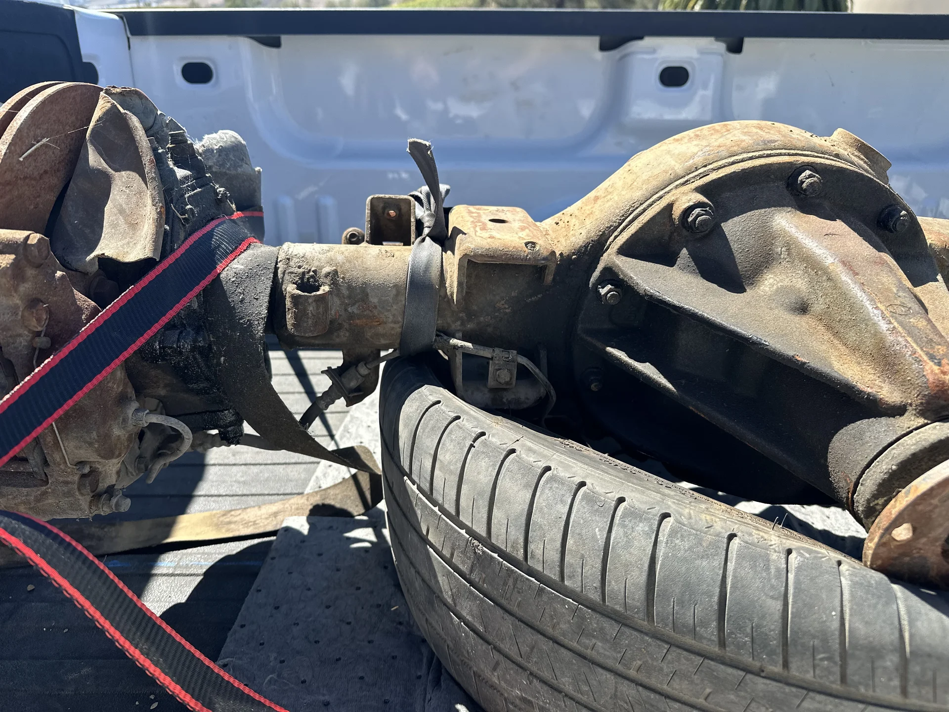

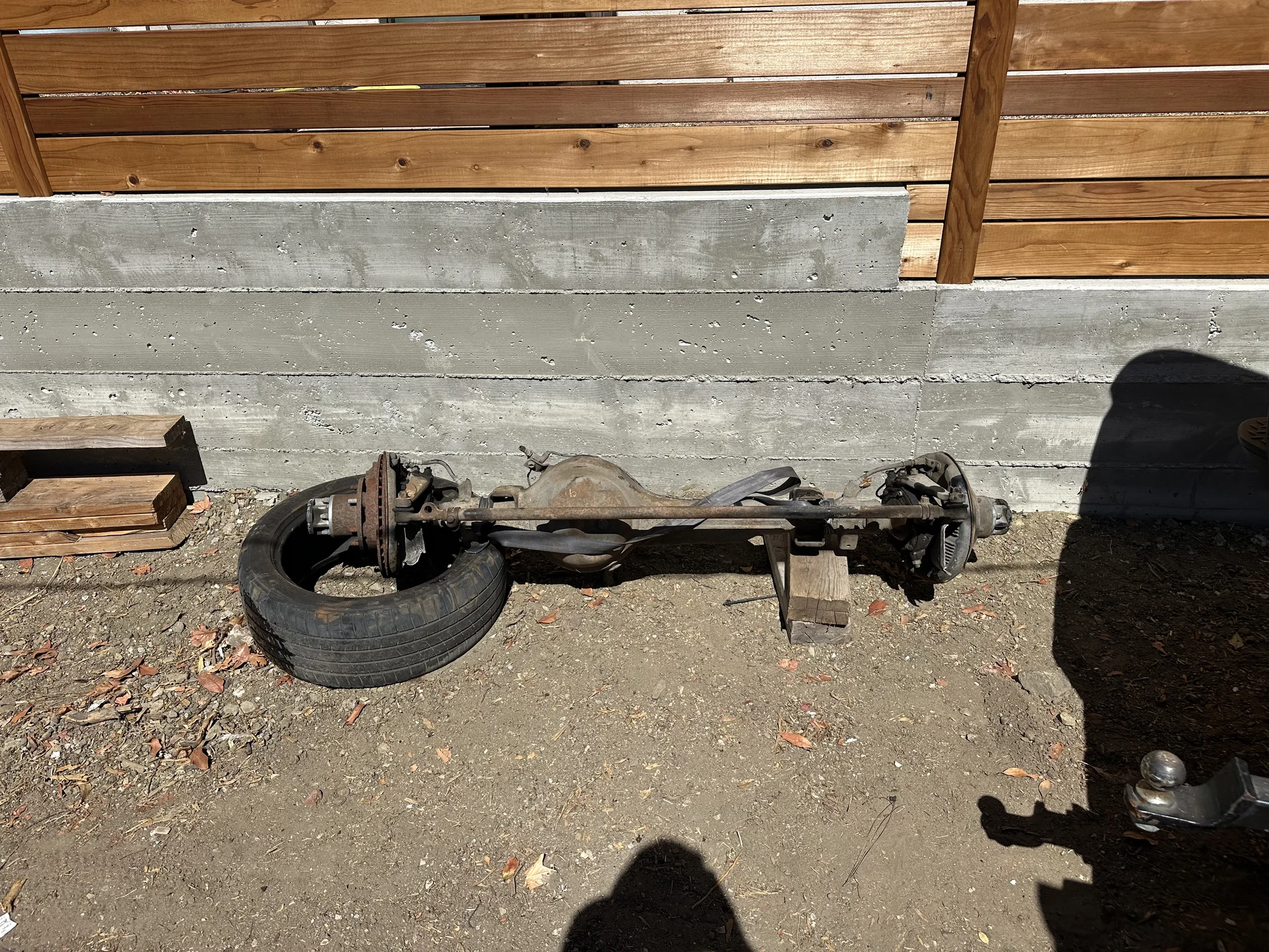

Sourced myself an axle, and went a little spend happy on various sites. I now have enough to keep me busy for the foreseeable future, issue is finding time to wrench with a three year old and 5 month old… minor details.
Anyhow, it was recommended to me that I should probably find a knuckle centering tool prior to starting this project. Anyone on here have success without it? Anyone want to rent me one?

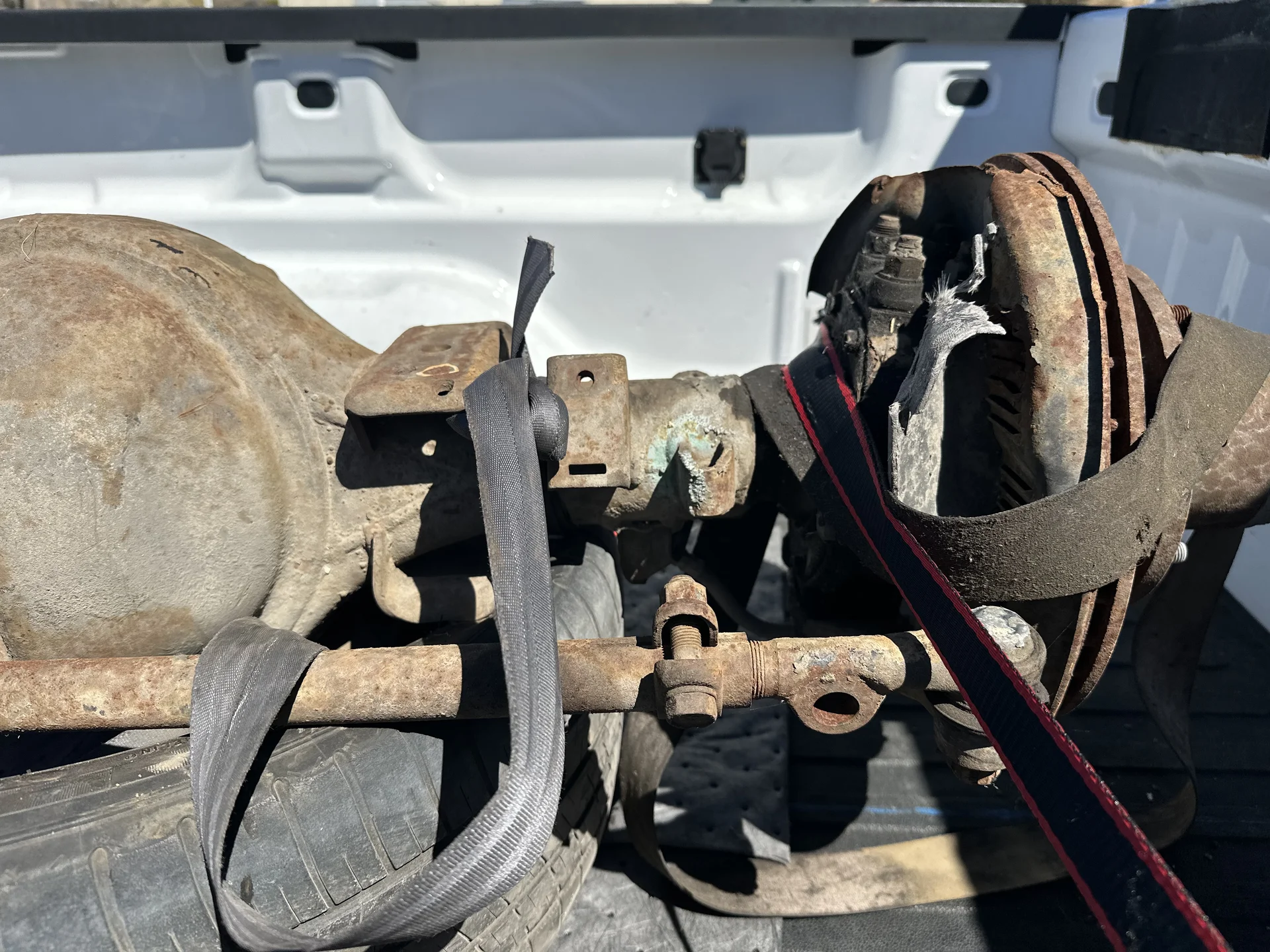

Don't assume that your axle needs a knuckle rebuild, right out of the box.
Unless you know it's shot (something is floppy-loose that shouldn't be, or it's full of rusty water), just install it, reconfigure the brakes as needed, and enjoy the ride. If the knuckles leak a little 90wt for a bit, it won't hurt a thing. Don't let 'rebuilt' be the enemy of 'on the truck' (at least in this case).

The Knuckles need to be swapped out as that's what the calipers bolt to and why it was best to just buy the hole 60 series front axle. At that point it's best to just do a full rebuild as it's all apart. IMO it just a good idea for peace of mind.
I also think it's a right of passage for any new Land Cruise owner to do a knuckle rebuild ;)
The worst part is all the cleaning, the rest is enjoyable /satisfying
If it was me I would get the 60 axle torn down and get the knuckle & hubs cleaned up and painted ahead of time and all ready to go.

A straight axle swap does sound a bit easier in some regards, but as Broski mentioned, gotta get a little greasy at some point.
He already has a FJ40 disc brake front end. He can just swap the complete front end, then service the knuckles, brakes and such. He might want to reroute the brakelines.
Who is he? He as in me? Apologies, I should have been more clear, the axle I have procured is from a fj62. Hence the talk of knuckle rebuilding/kits/etc.
Sorry for the confusion!
