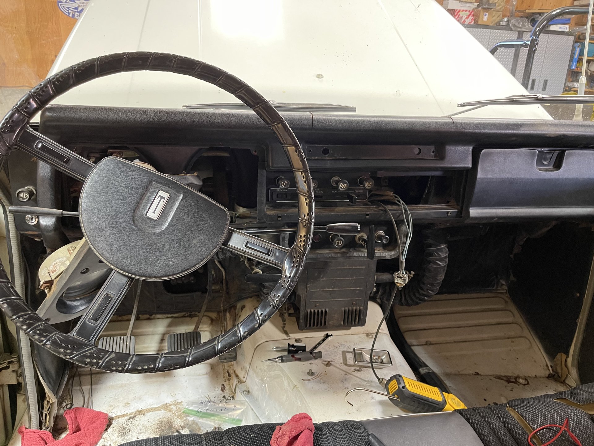

Trying to remove the dash pad, removed screws on each side and seem to have each end kinda separated. However I don't want to tear the pad up, instead I would like to send to same shop @gonzopancho is using to refurb his. So any secrets to removing the pad, am I missing some hidden screws or is it just held by some old adhesive?

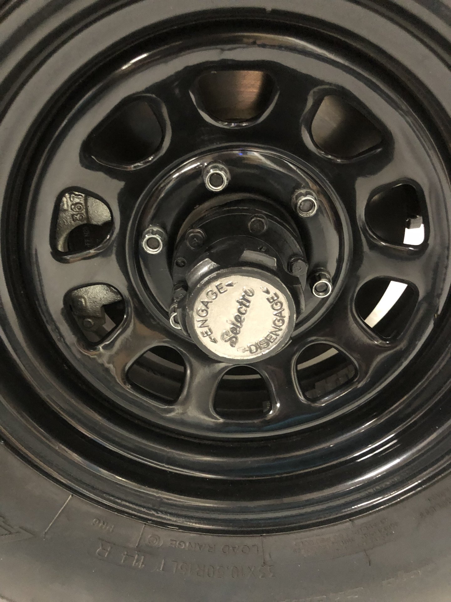

Can someone share what I would need to do to the original 15" wheels my PIG currently has to accommodate a front disc axle swap from a 77 55? I'm not opposed to buying the 16 inch wheels but if I can avoid it and use what i got I would prefer that...
Newer ('76 and up??) 15" wheels work but I think the older, riveted ones don't. My OEM wheels are 15" and they are over disk fronts.
Greg, the wheels are on the 69 and are original. I am going to pull the axles on the 77 parts pig. IT sure would be nice to be able to keep em as they are in great shape clips and all. So welded good, riveted not?
My understanding is that the rivet heads on the original wheels are in the way of the brake rotor. You would need a later style wheel that is welded, not riveted together. I need to double check, but I may have a set of welded 15" wheels I could trade for the riveted ones.
Edit: Rivets hit the caliper not the rotor.
I have seen some car shows on TV where they take the wheels to a shop and they add a new inner to widen them. I went for a temporary solution and ordered inexpensive wheels from Discount Tire. Now that I have them I sort of like them and may keep them.

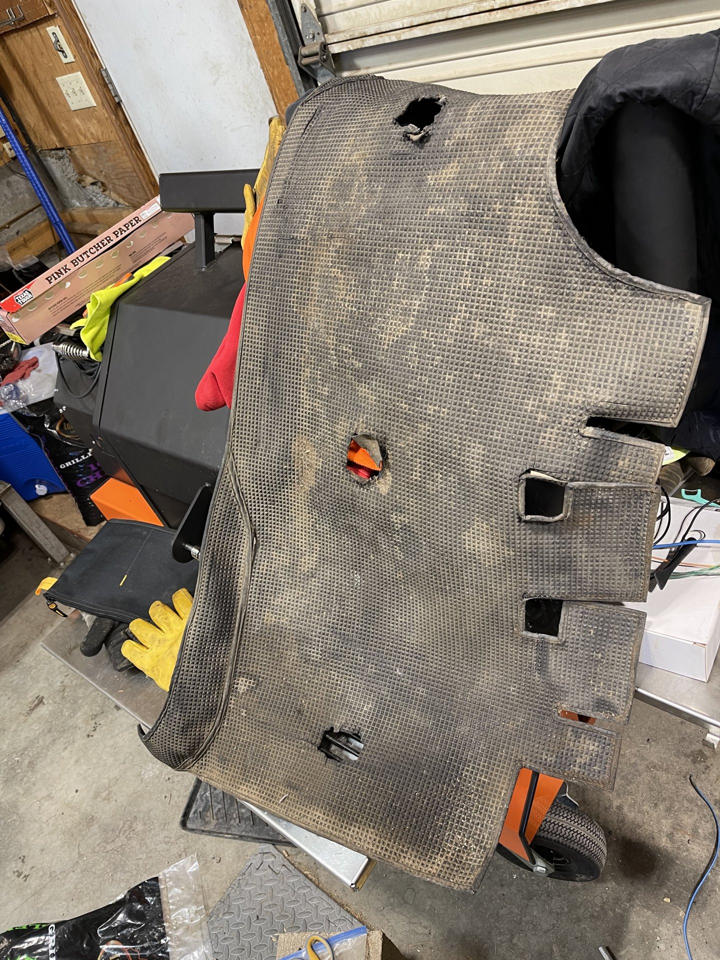

While cleaning it up inside got me curious if this was the original rear floor mat? Been following some mudders on 45 section and it looks identical. I haven’t see valve in the heater lines on my other cruisers before?
Floors continue to amaze me!
Your floor does look good. How do the floor pans under driver and passenger feet look? Mine were coated with fiberglass. After media blast, and a bunch of scraping underneath they were like Swiss cheese.
