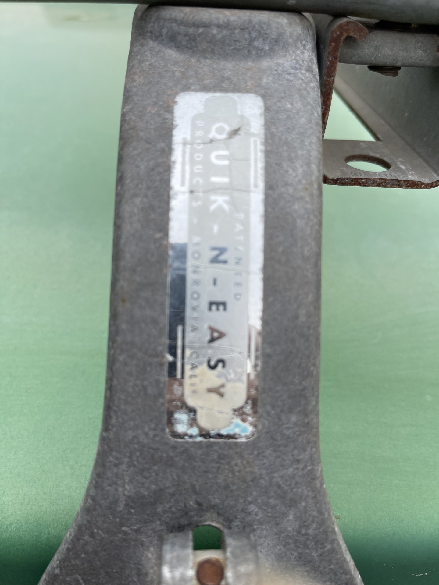

Seems like I’ve heard of this brand rack before and I need one more clamp like this. This will all be blasted and powder coated also. Pretty darn sturdy rook rack.
The other option is to have new ones fabricated I guess but see if anyone in the litter has a spare.
