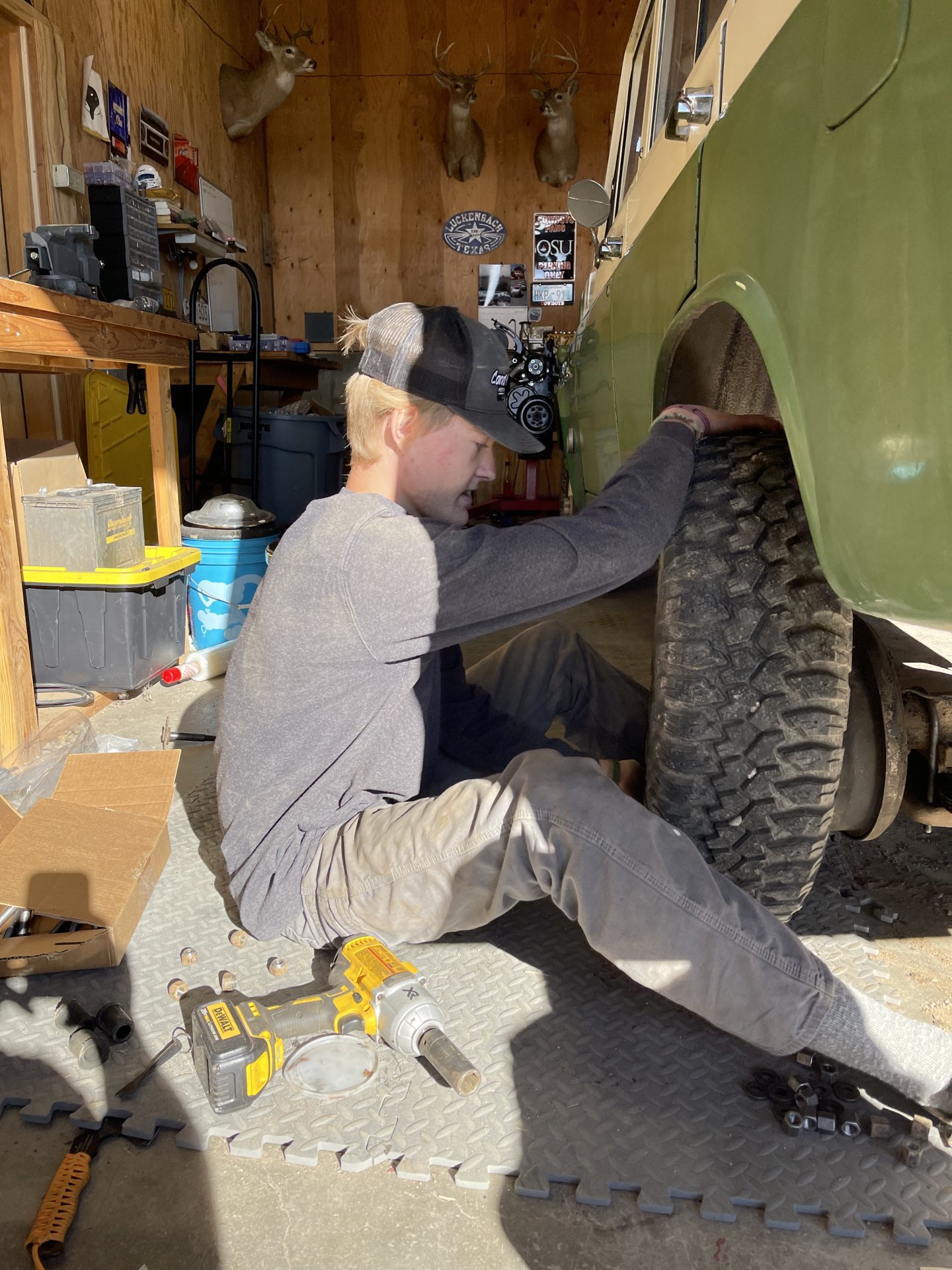

Huge thanks to @Mtntopper and his son Justice for driving over an hour to help install lift. Great people who I’m sure will be looking for a pig in the future after working on the Pig. Swine flu so contagious that you spend a little time under a pig the fever won’t be far behind.

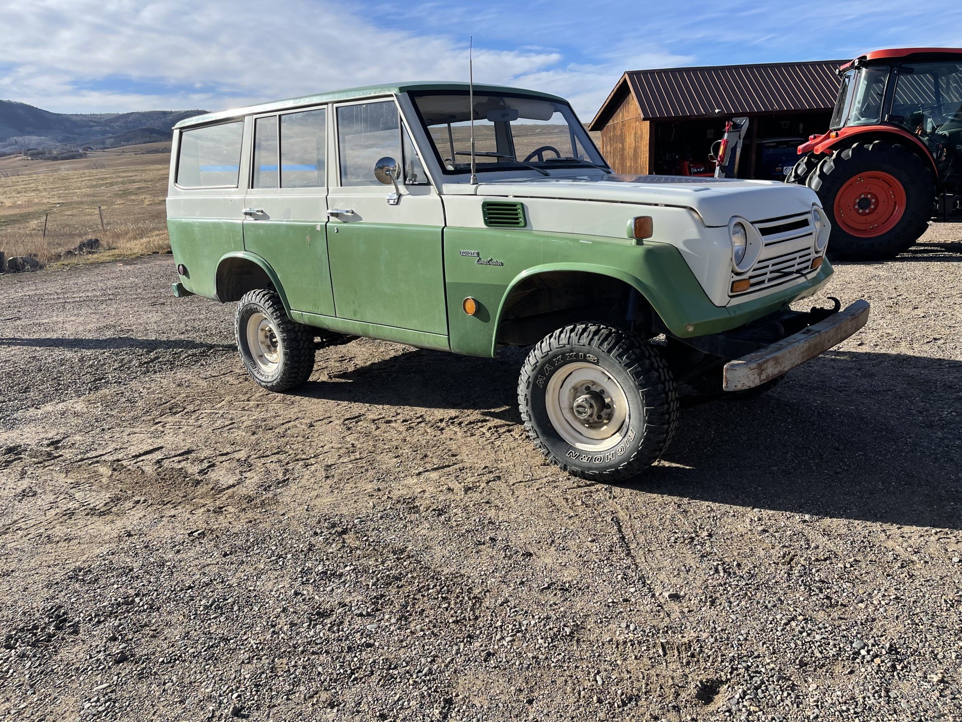

3” Alcan lift installed with pretty good fit. Their bushings didn’t work but Cruiseroutfitters had the remedy with replacement bushings. New shocks are next in order as the old shocks pretty much extended all the way so I’ll gladly take some recommendations.
Steve (@Mtntopper ) had purchased a 55 bumper for his new LV project but it was too wide so he was kinda enough to sell it to me. Gonna recondition it and place it on the front.
Looking good, Jon. Now time to fill up those wheel wells a bit more. That'll also give you a little bit of "rubber overdrive."

For shocks go with Bilstein or Dobinsons IMS. Both are good options, but the IMS are a step above the Bilstein's IMO.
For those that went with the Bilsteins did you use the 5100's? For my intended use the Dobinsons are probably overkill and I am getting close to the $5000 budget with the new lift, paint, body, 5 speed, etc...
5100s give a nice ride
