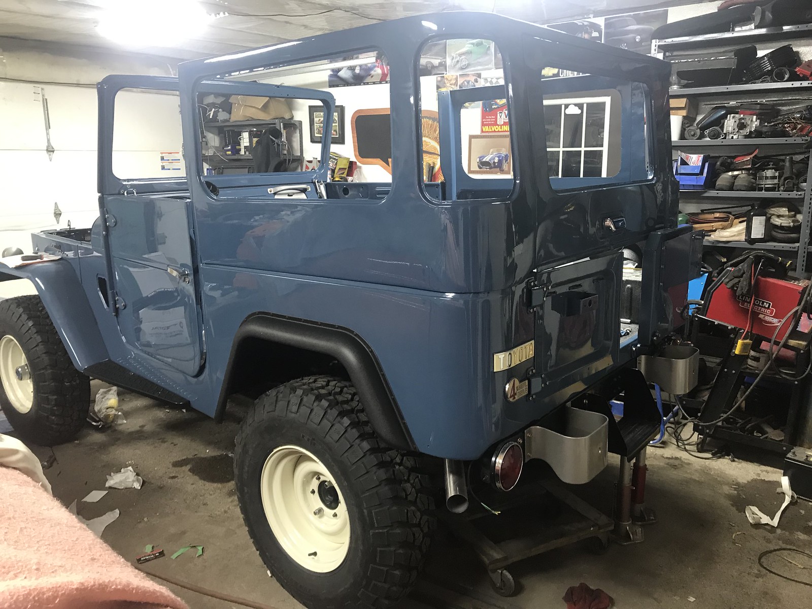

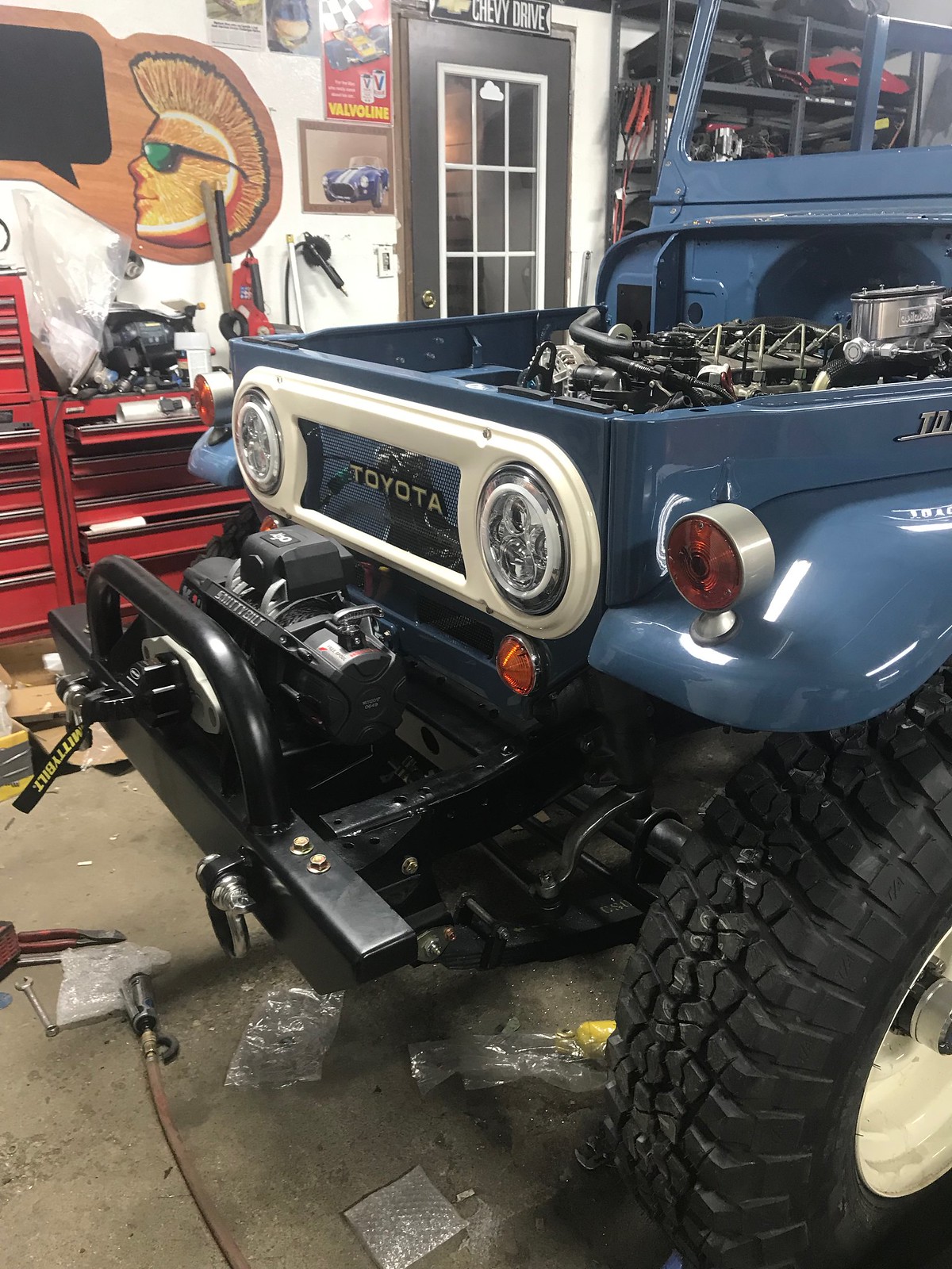

Update From yesterday, with stainless exhaust starting today
IMG_0906 by Steve Heck, on Flickr
IMG_0903 by Steve Heck, on Flickr

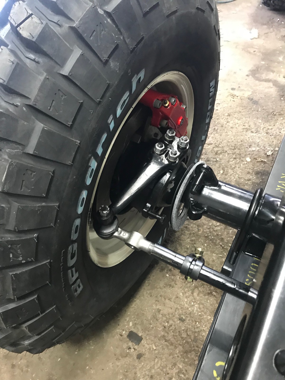

Brake clearance on the front wheels all good ''
IMG_0905 by Steve Heck, on Flickr

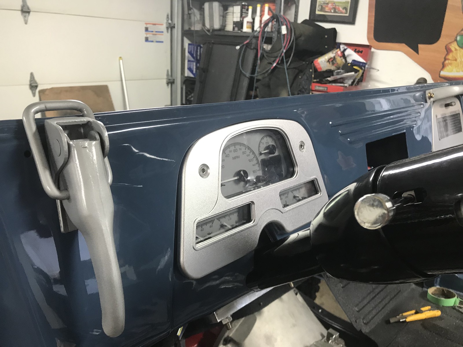

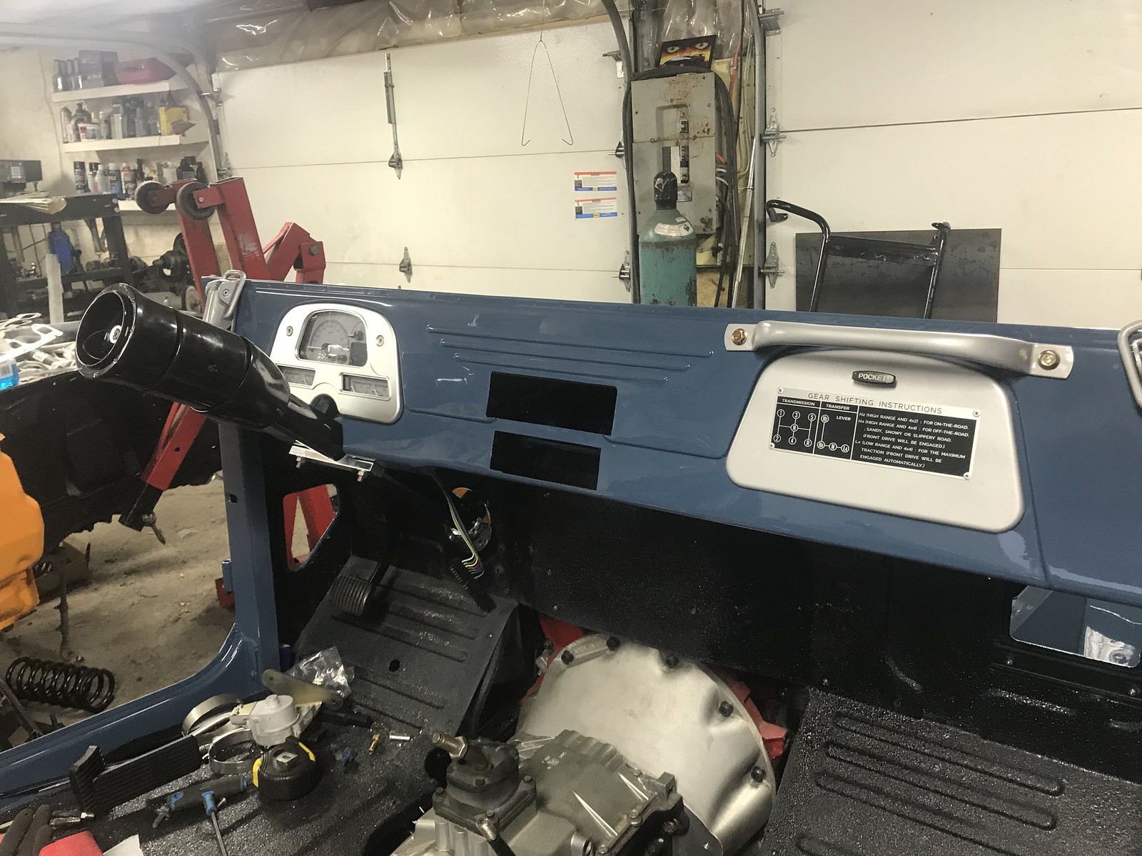

New HDX gauge set in white from Dakota Digital, with the gauge frame from ICON, really nice piece but requires some shaving across the top to properly fit. Very happy with the colour combination of the dash this far

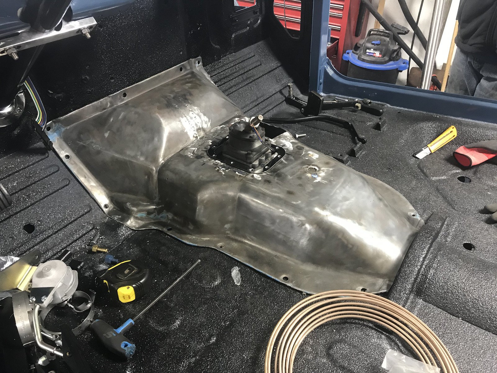

Also happy that we were able to clear everything with the stock tranny cover with only a little modification

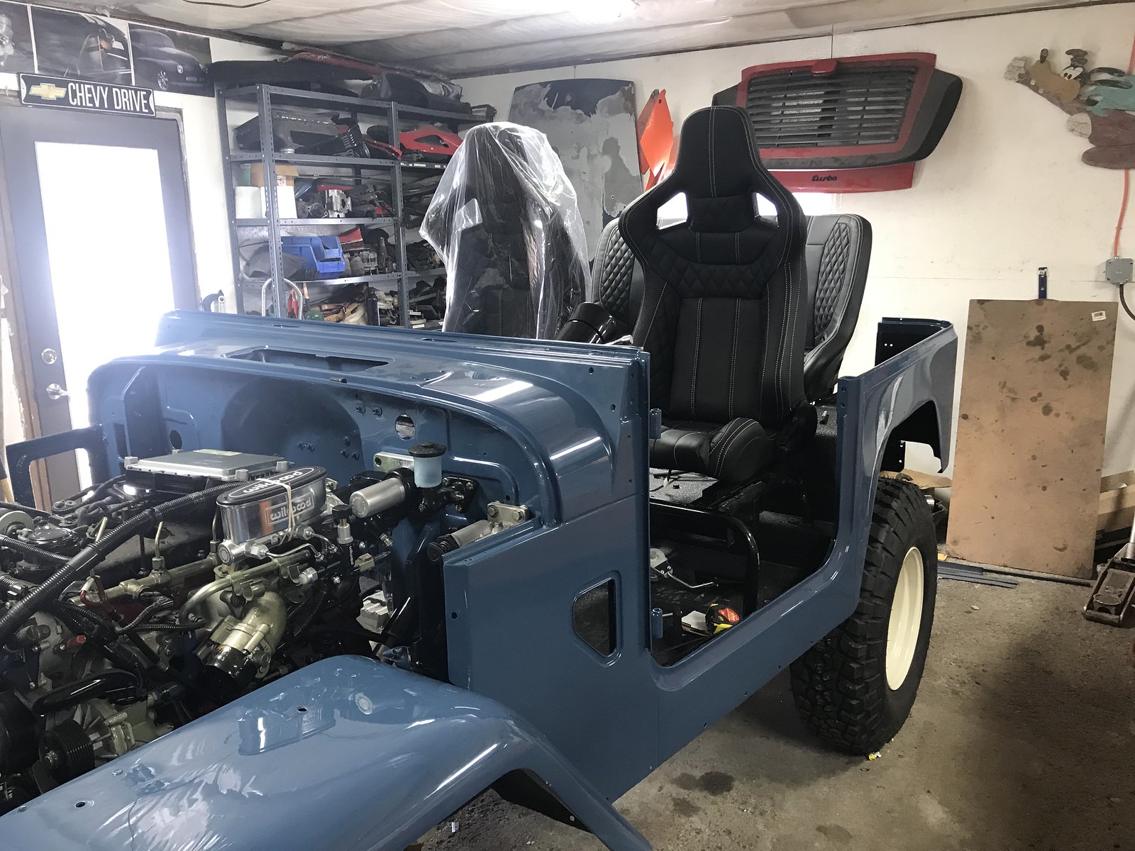

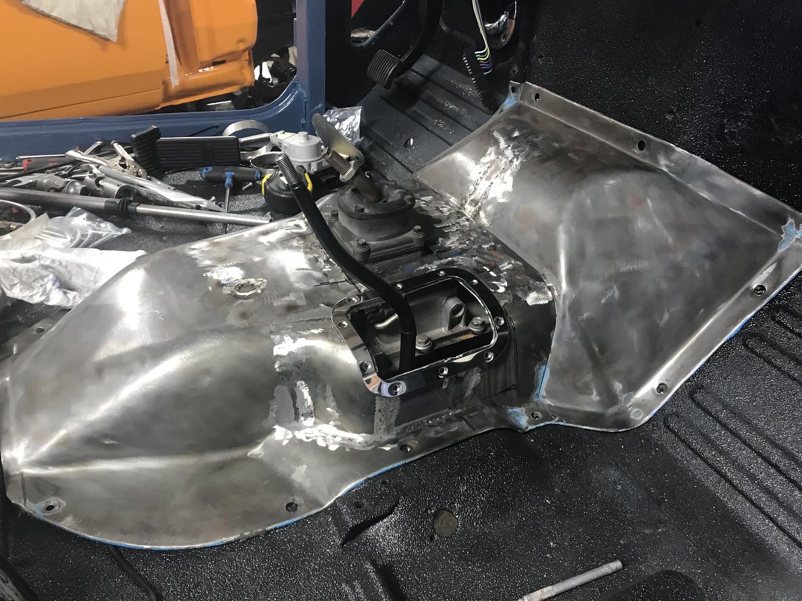

What shifter boot are you going to use?
with your transmission in that location so no major tranny hump mods are needed can i ask how low under your frame the bottom of the tranny sits?
Hey guys ... so I had to cut out the curved section of the tunnel, move it bak about 4" and weld it back in for the split case shifter. The same goes for the 5 speed shifter

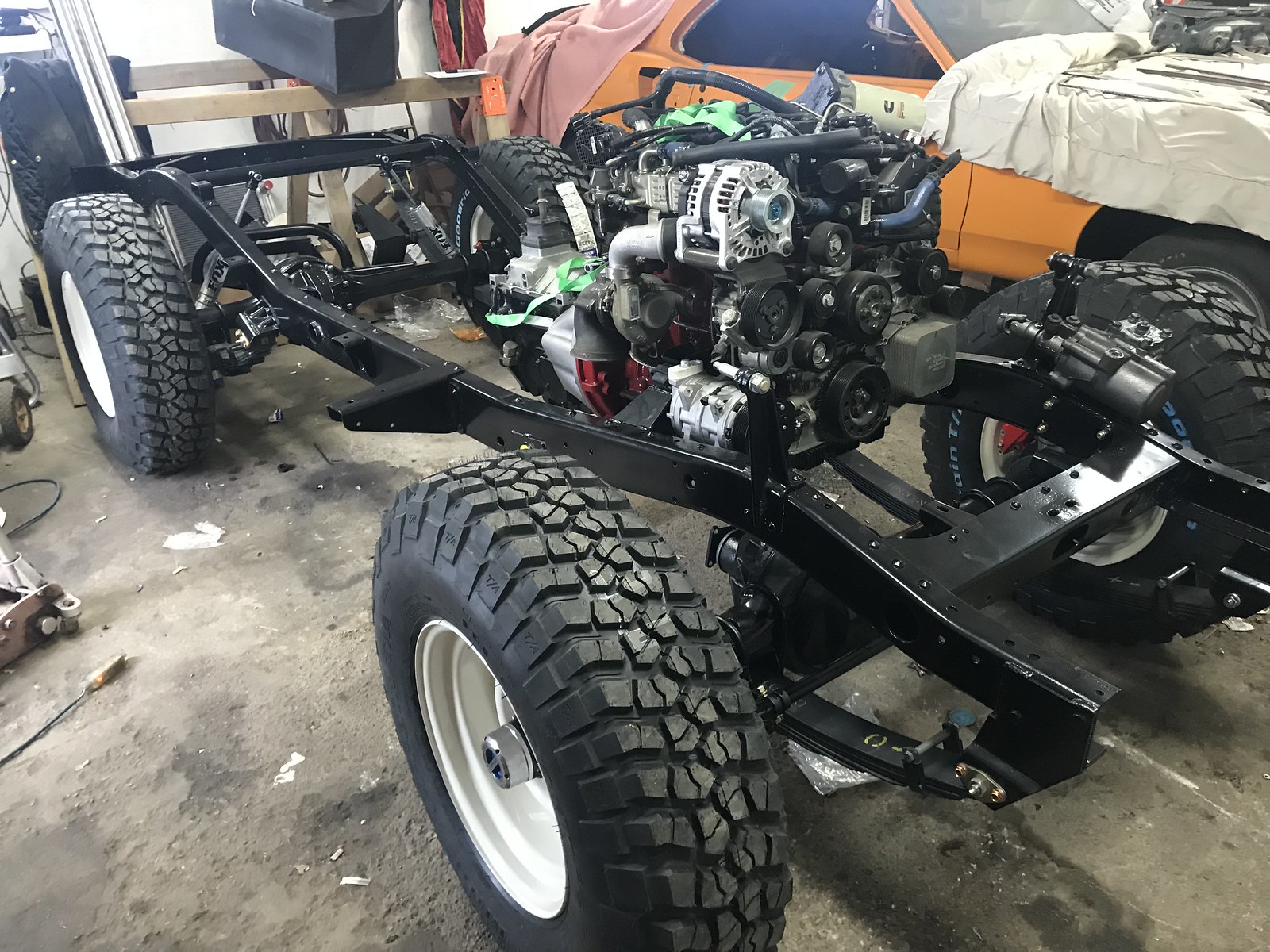

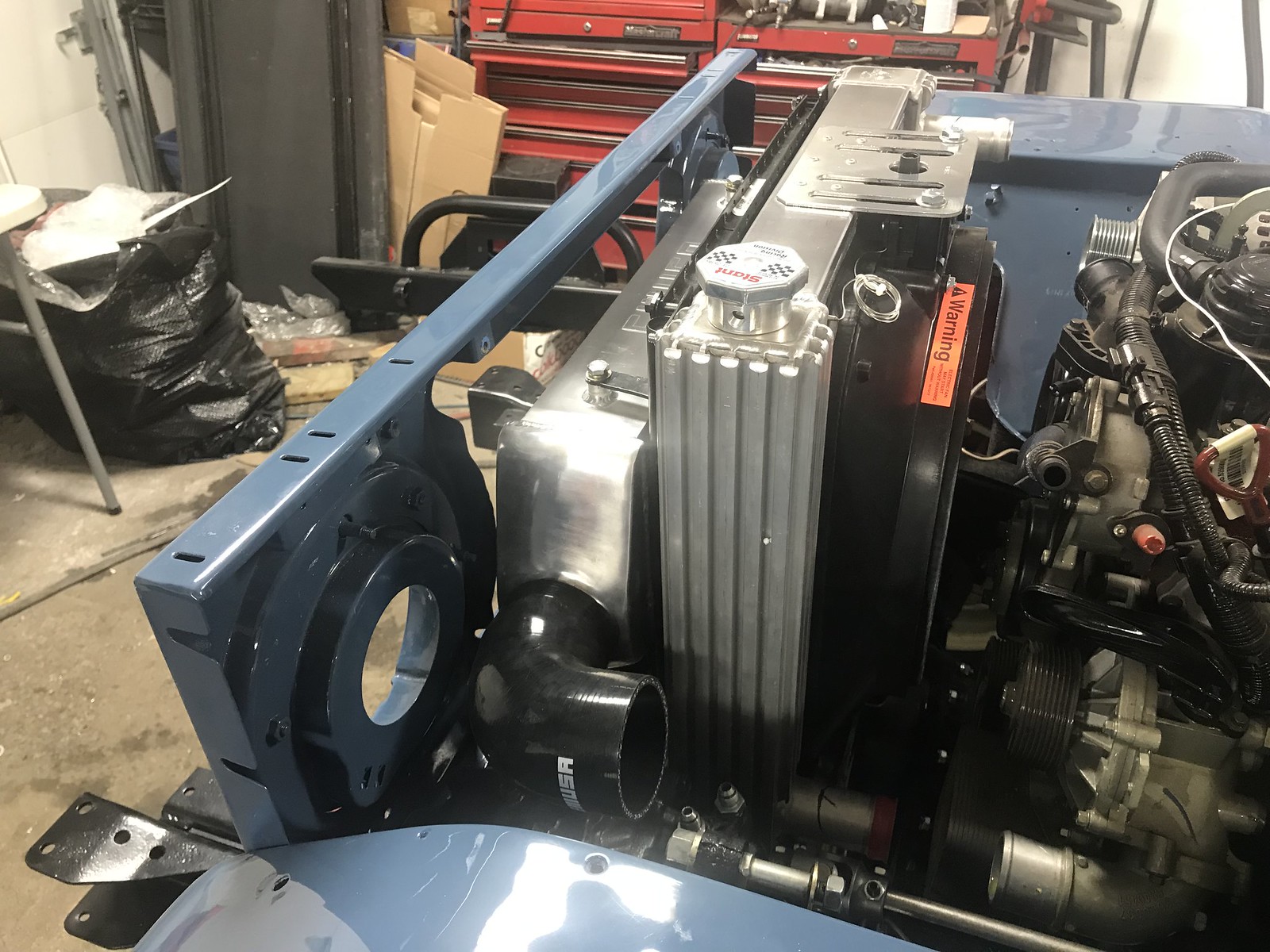

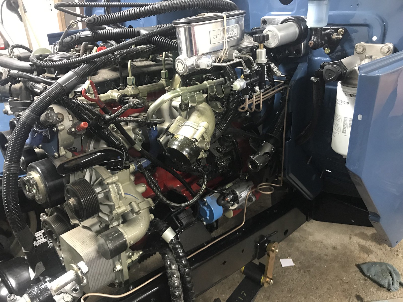

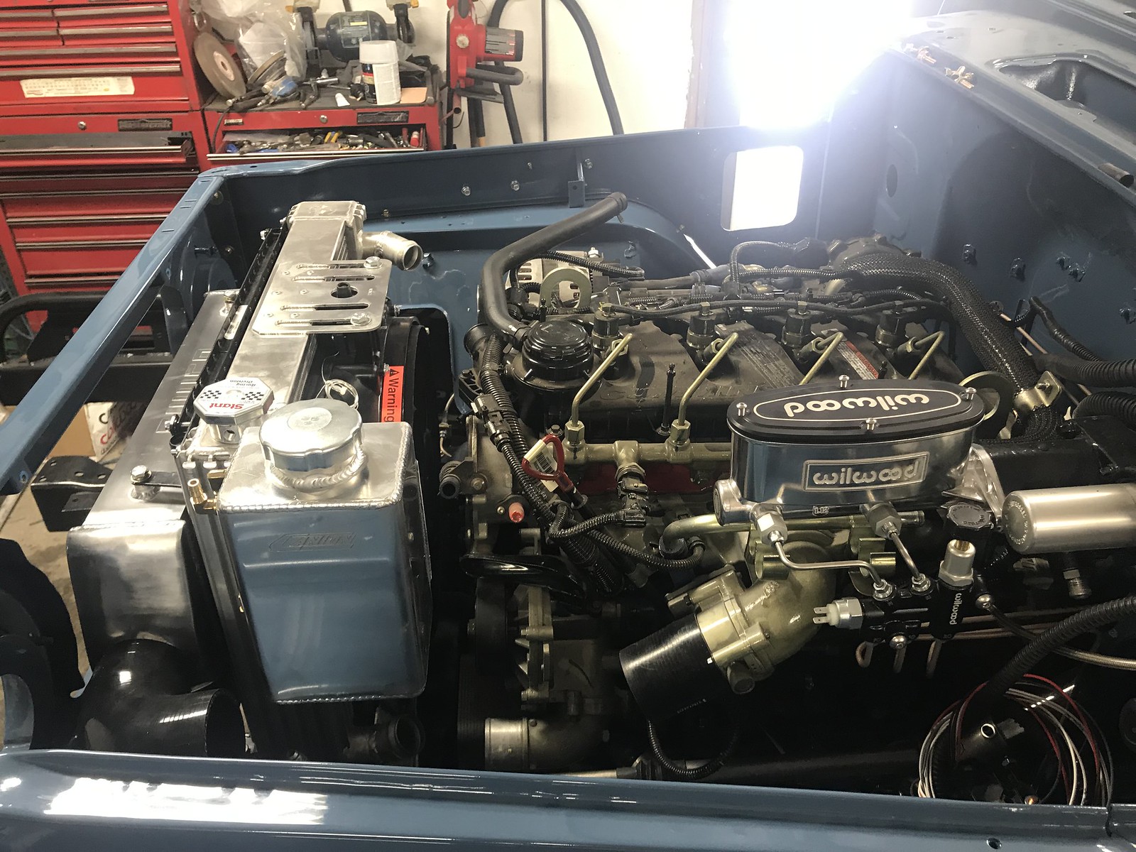

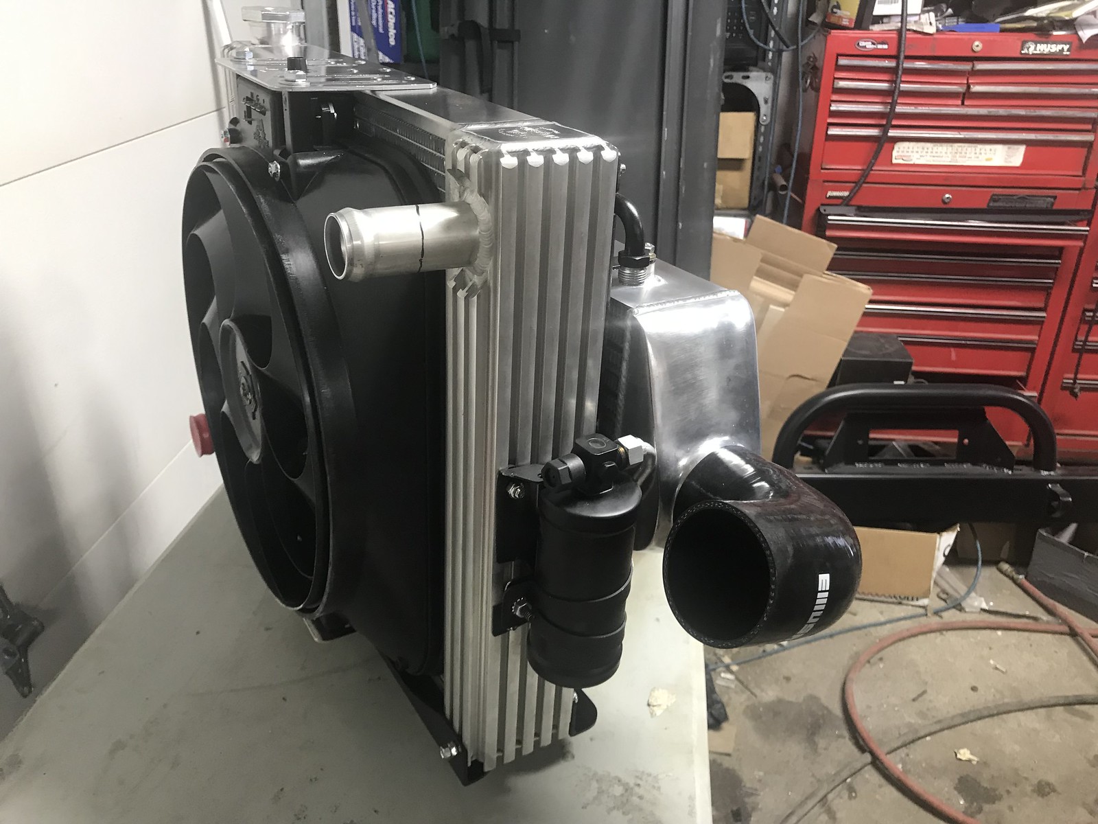

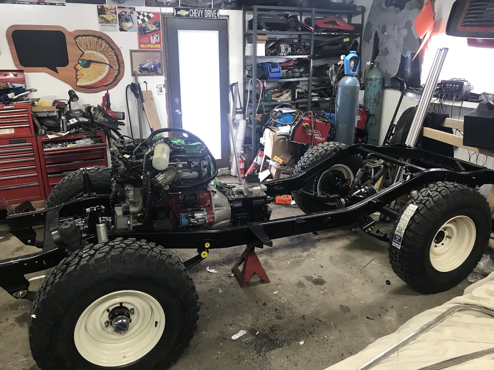

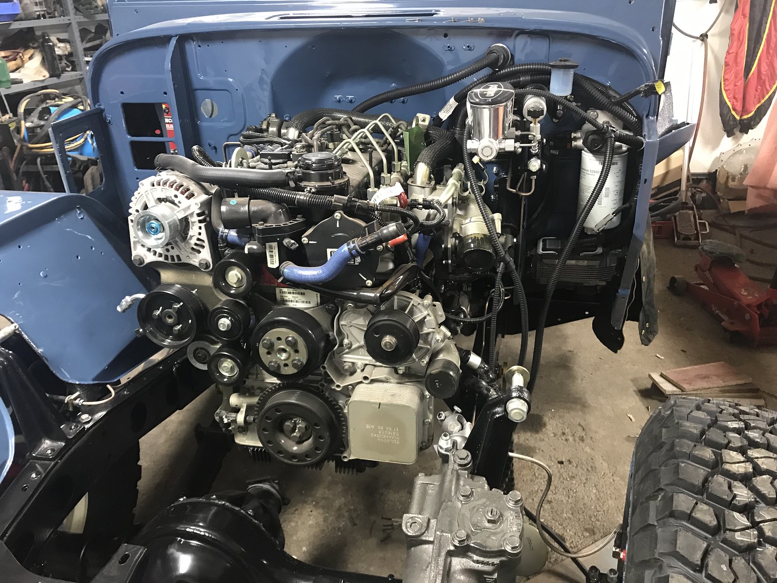

So, fuel system complete, suspension and drivetrain is complete, brake system complete and next is rad/intercooler setup and electrical
