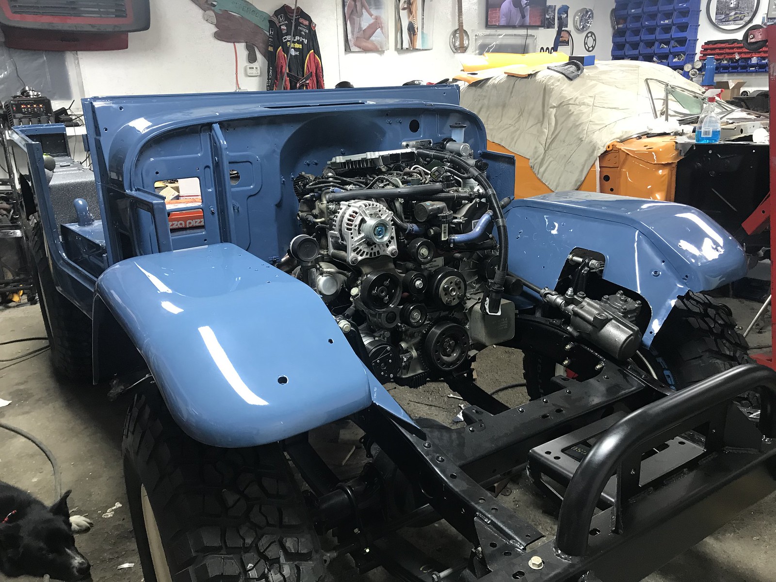

66' R2.8 1BADRESTO

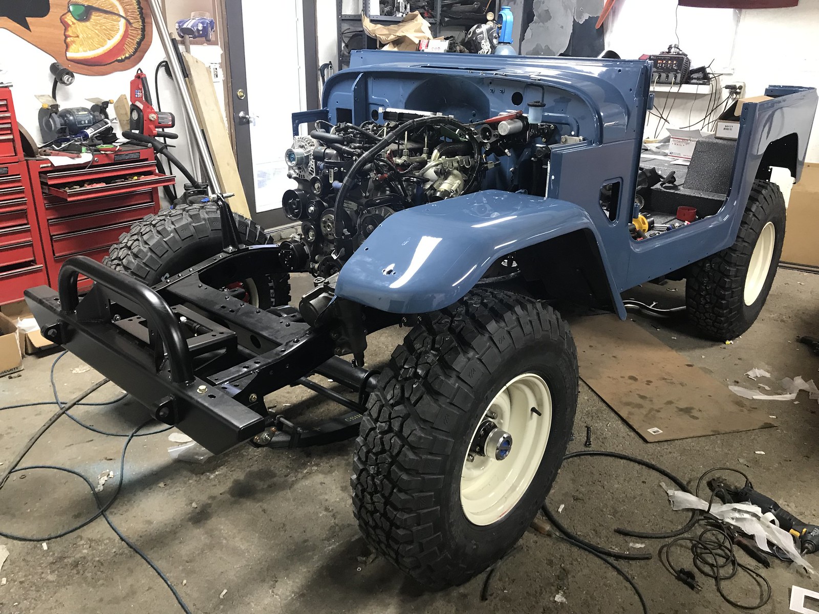

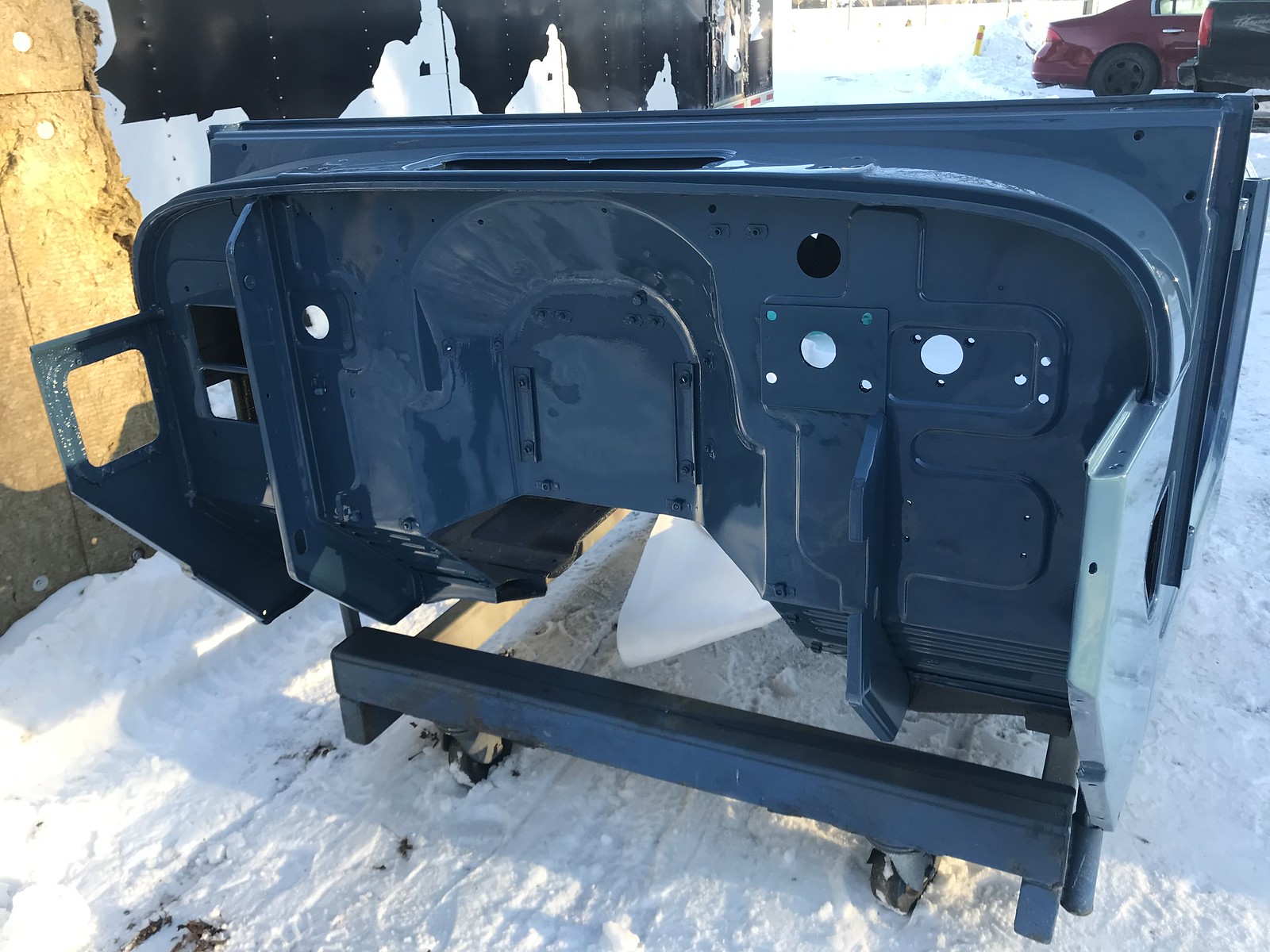

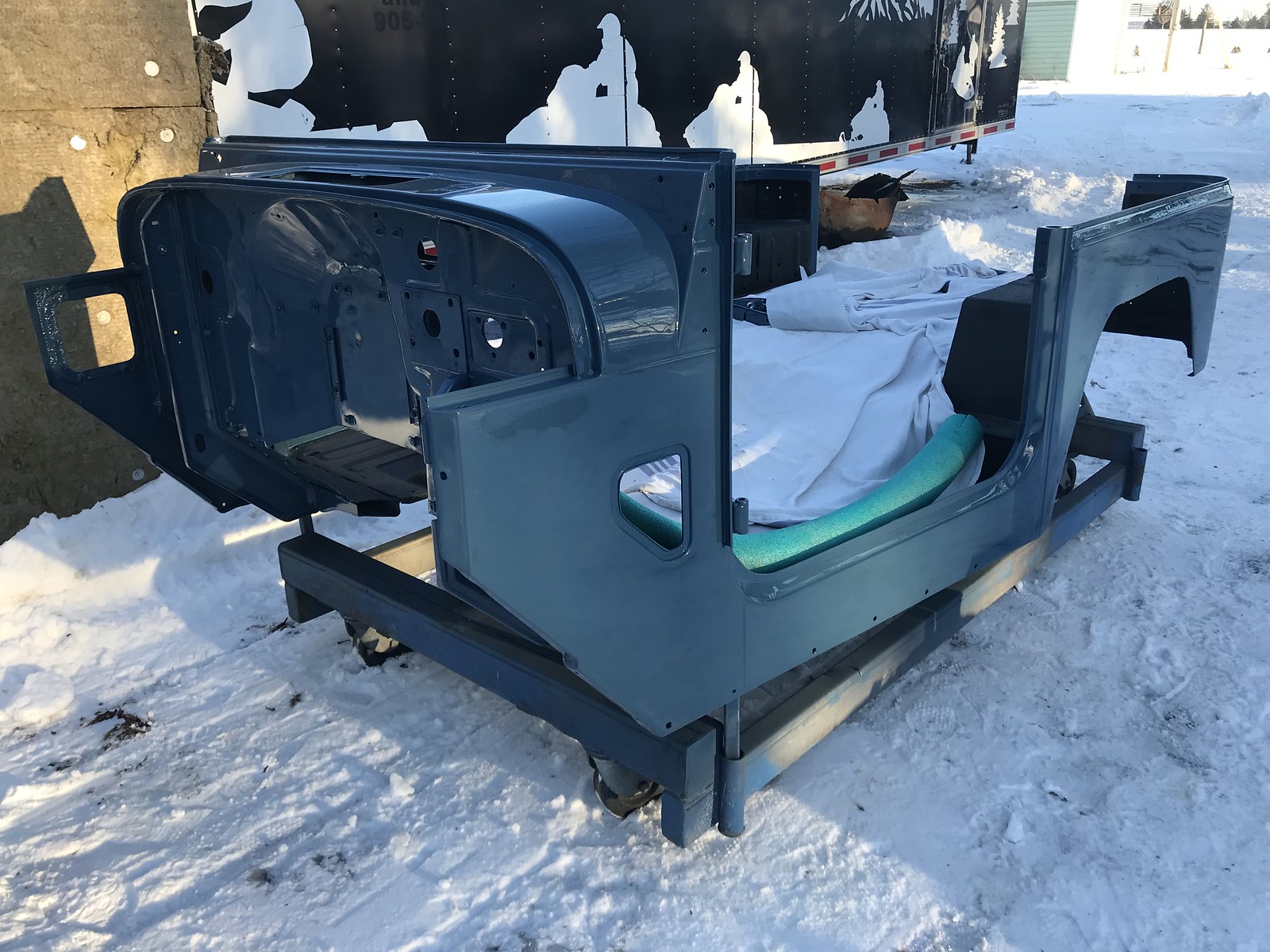

Looking very nice and the color is amazingly similar to a buddy's previous build. Maybe it's a preview for you.
1903664
I found the color in his build thread, it's Rustoleum Night Tide.
What axles are you using, or is it a disc brake conversion on the 66 axles?
Thanks guys ...
Rob, yes I can get you the paint Codes, but to get it exactly you may have to order the paint through these guys and they will have it exactly

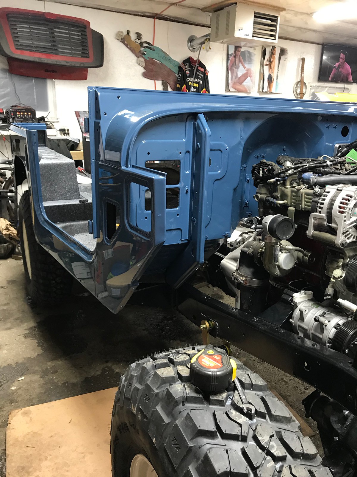

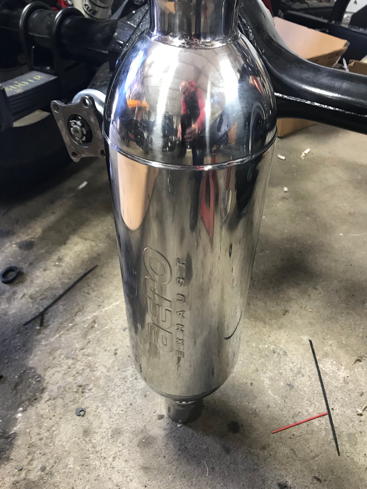

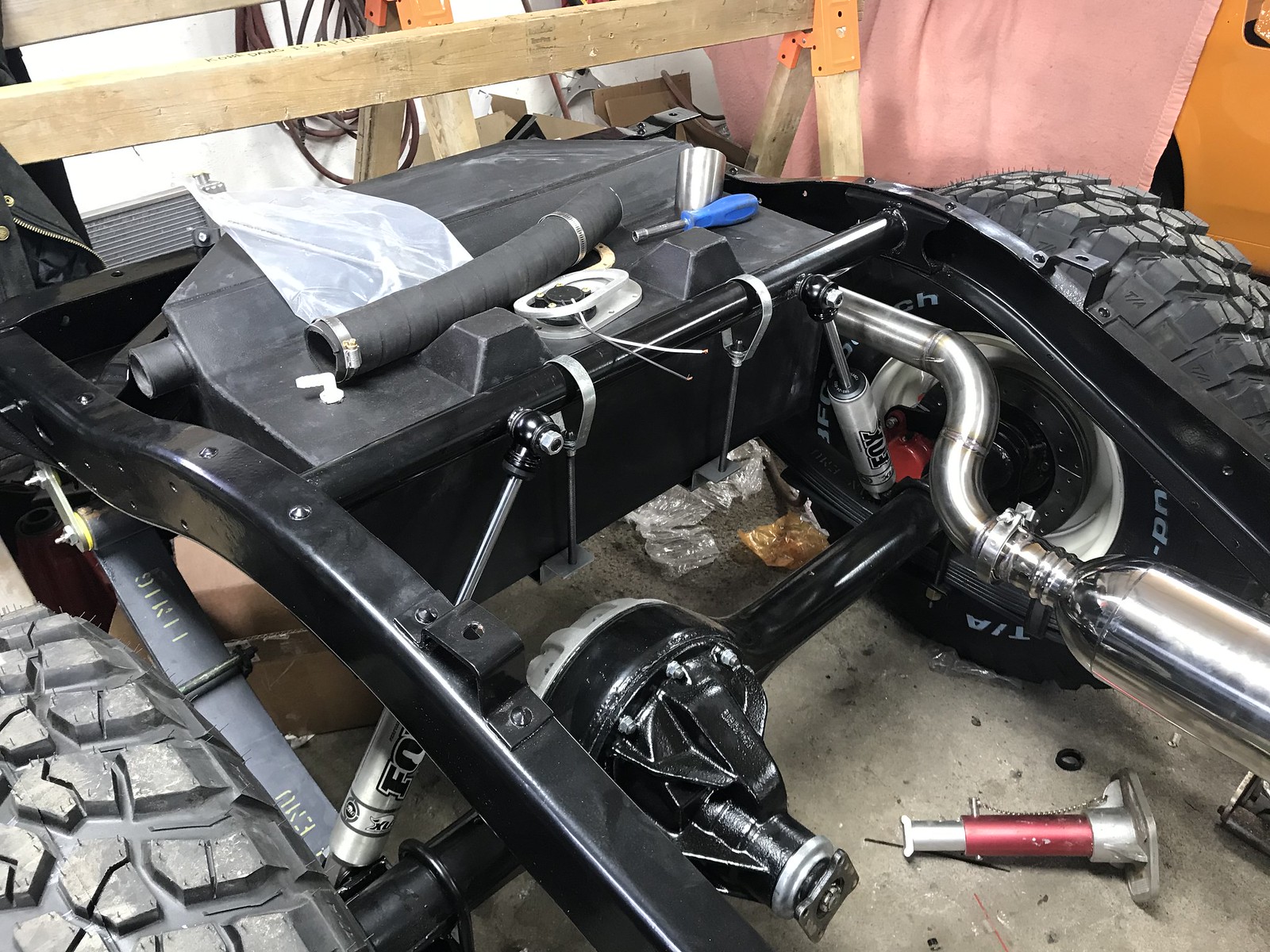

Update From yesterday, with stainless exhaust starting today
IMG_0906 by Steve Heck, on Flickr
IMG_0903 by Steve Heck, on Flickr

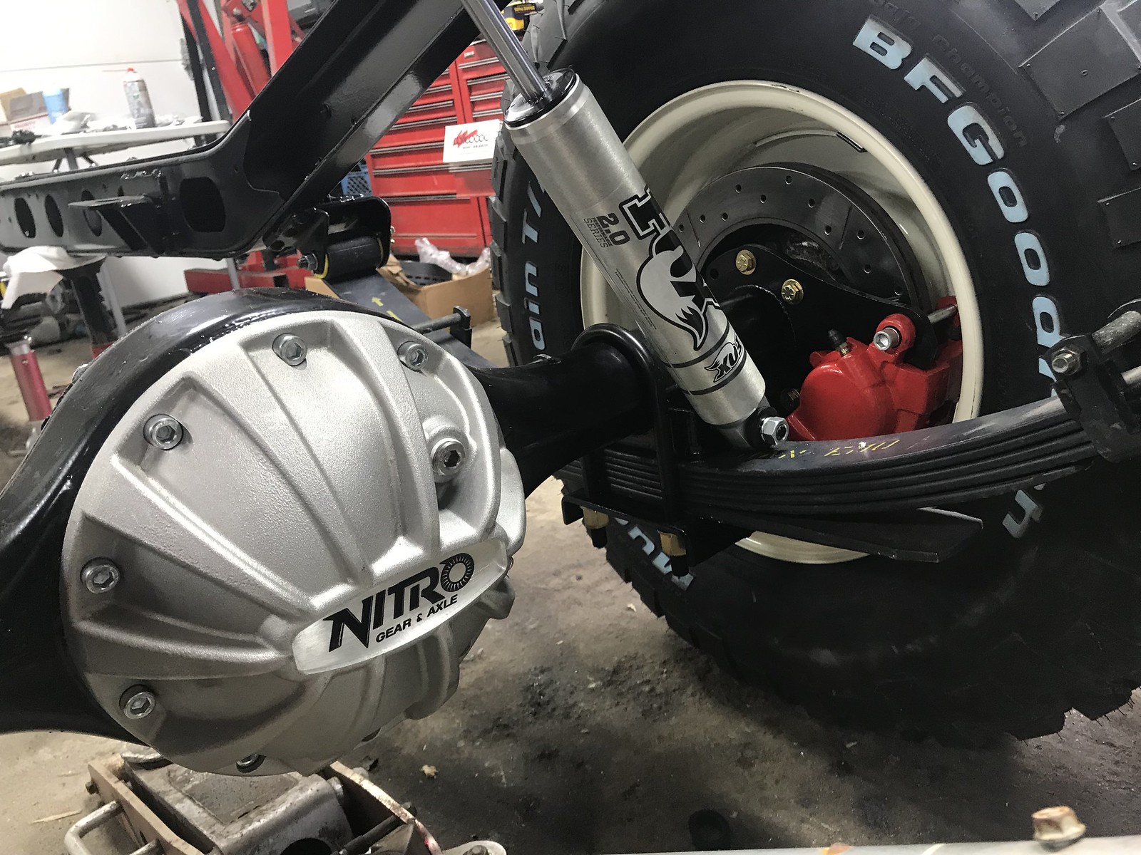

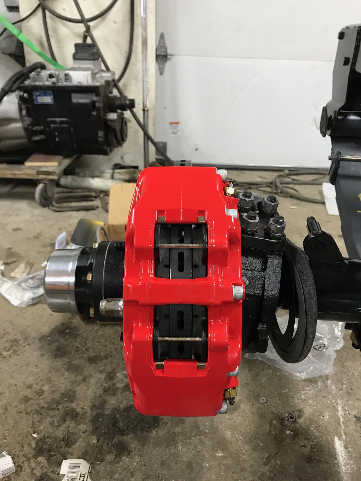

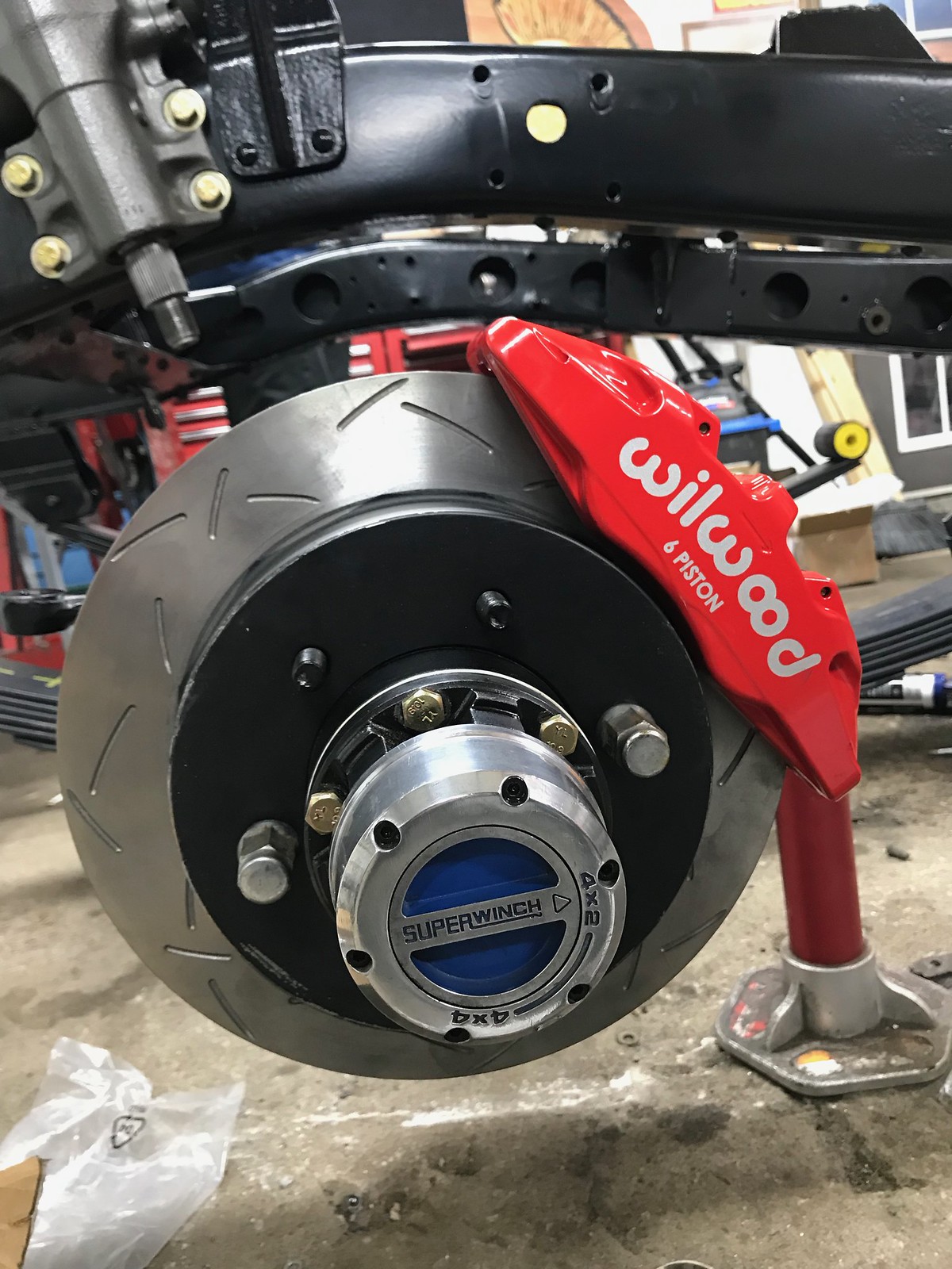

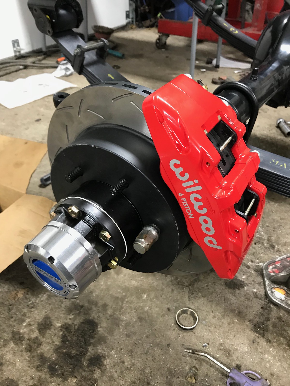

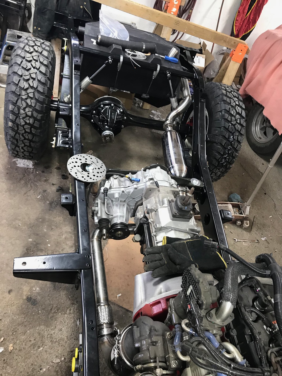

Brake clearance on the front wheels all good ''
IMG_0905 by Steve Heck, on Flickr
Where did you get the brakes from ?

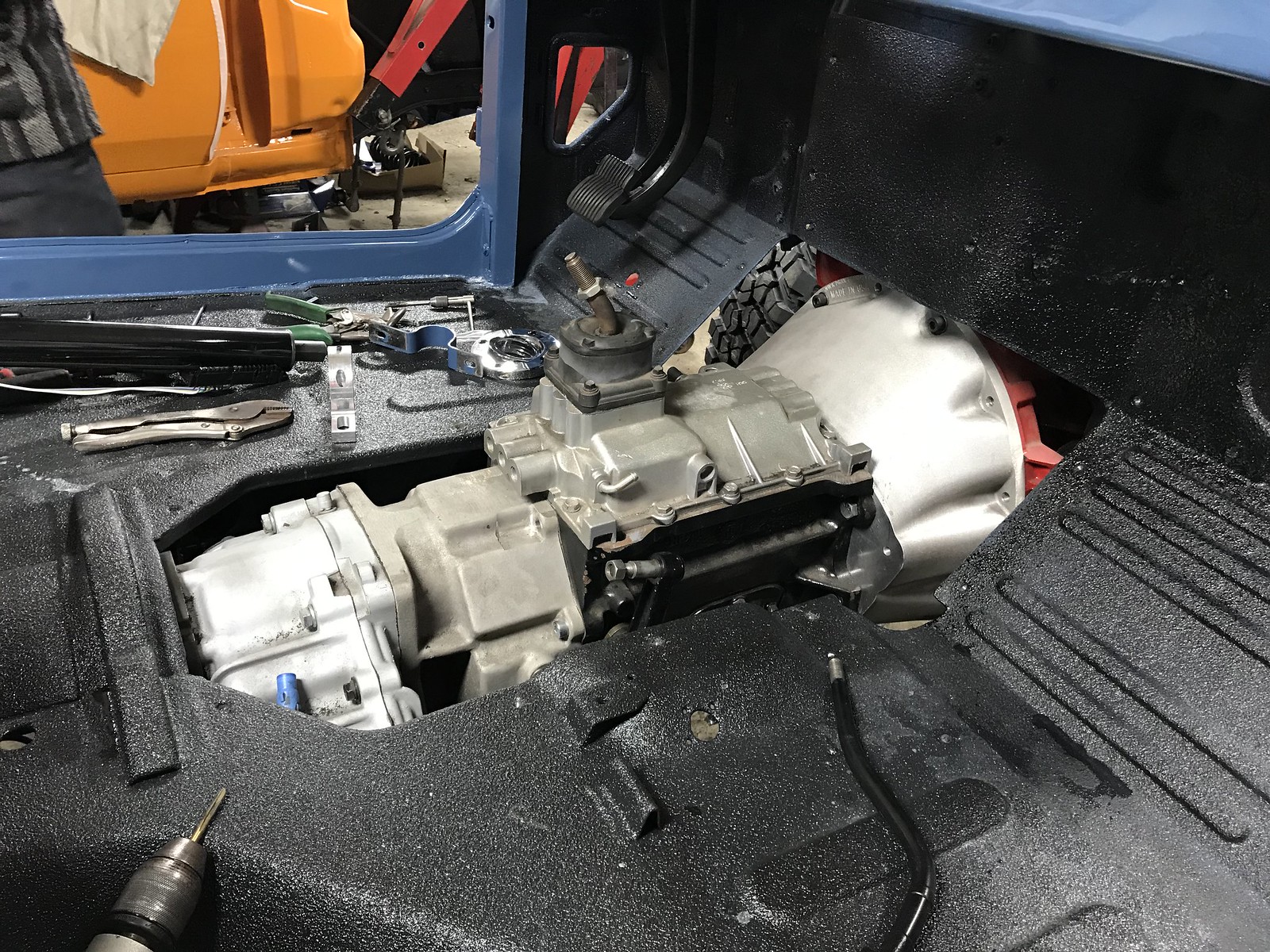

Arthur we are still using the NV4500 ...
Rob, bought the bracket kit and the rotors from BTB and sourced the 6 piston caliber fronts direct from wildwood, and the rears are GM
Cheers
Steve

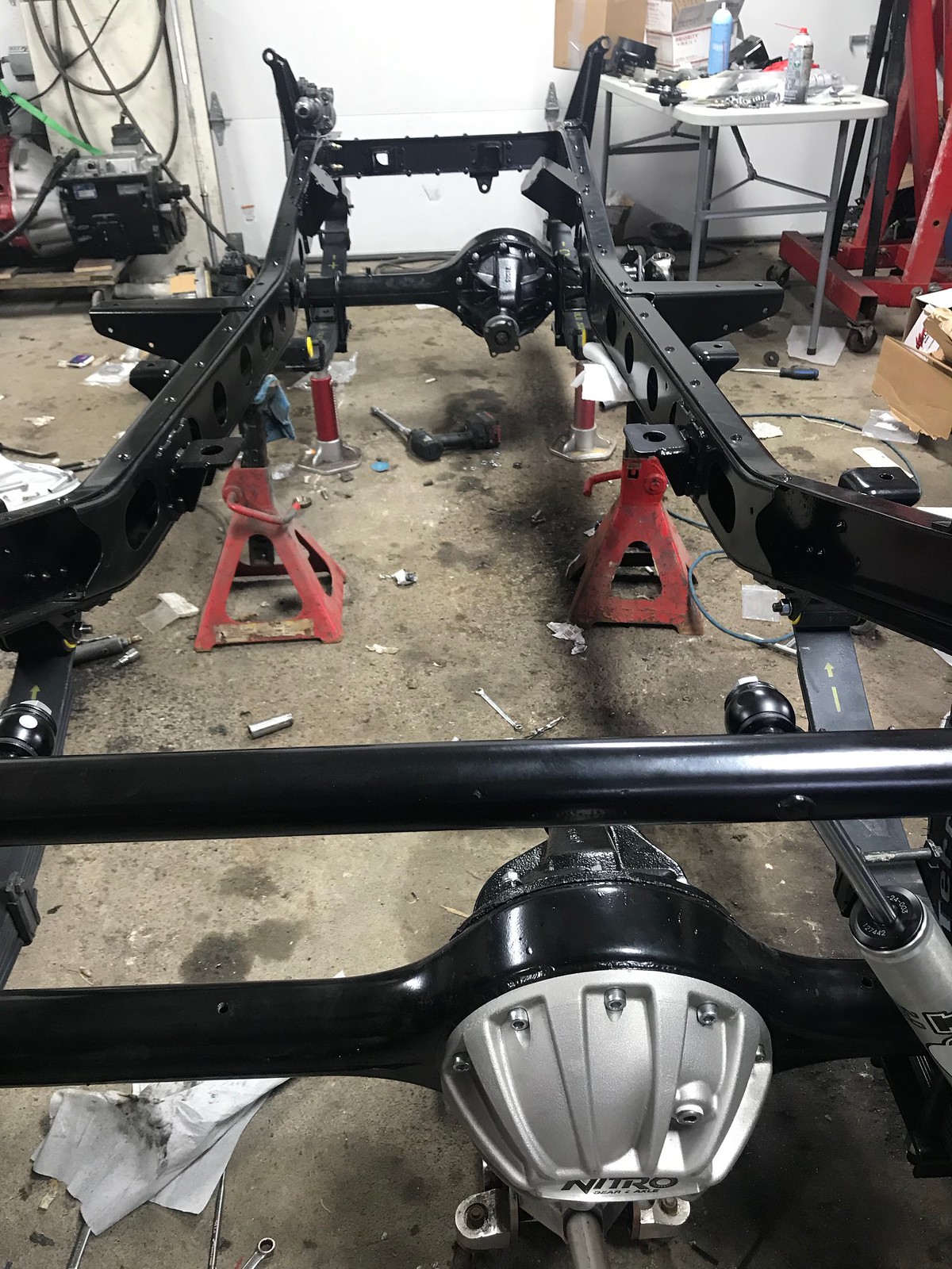

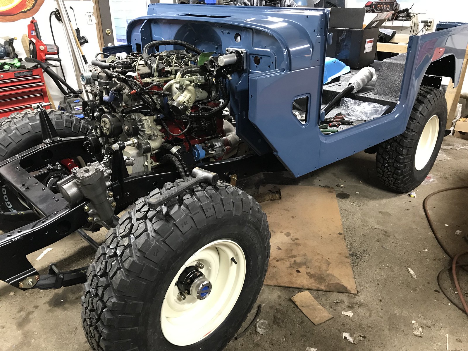

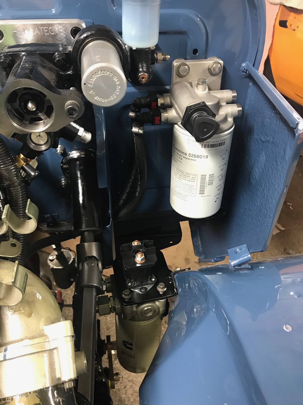

We are moving now ... so keeping my fingers crossed but looks like there should be no big surprises now, everything seems to be sorted

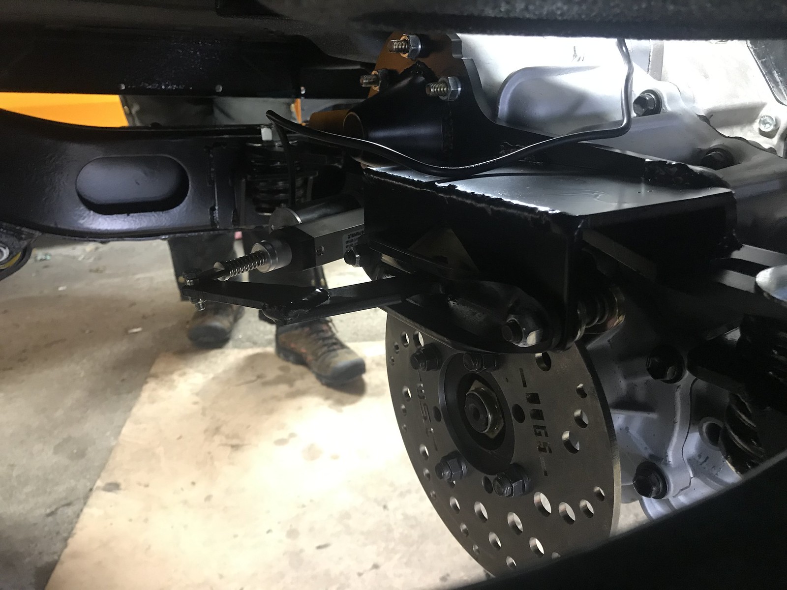

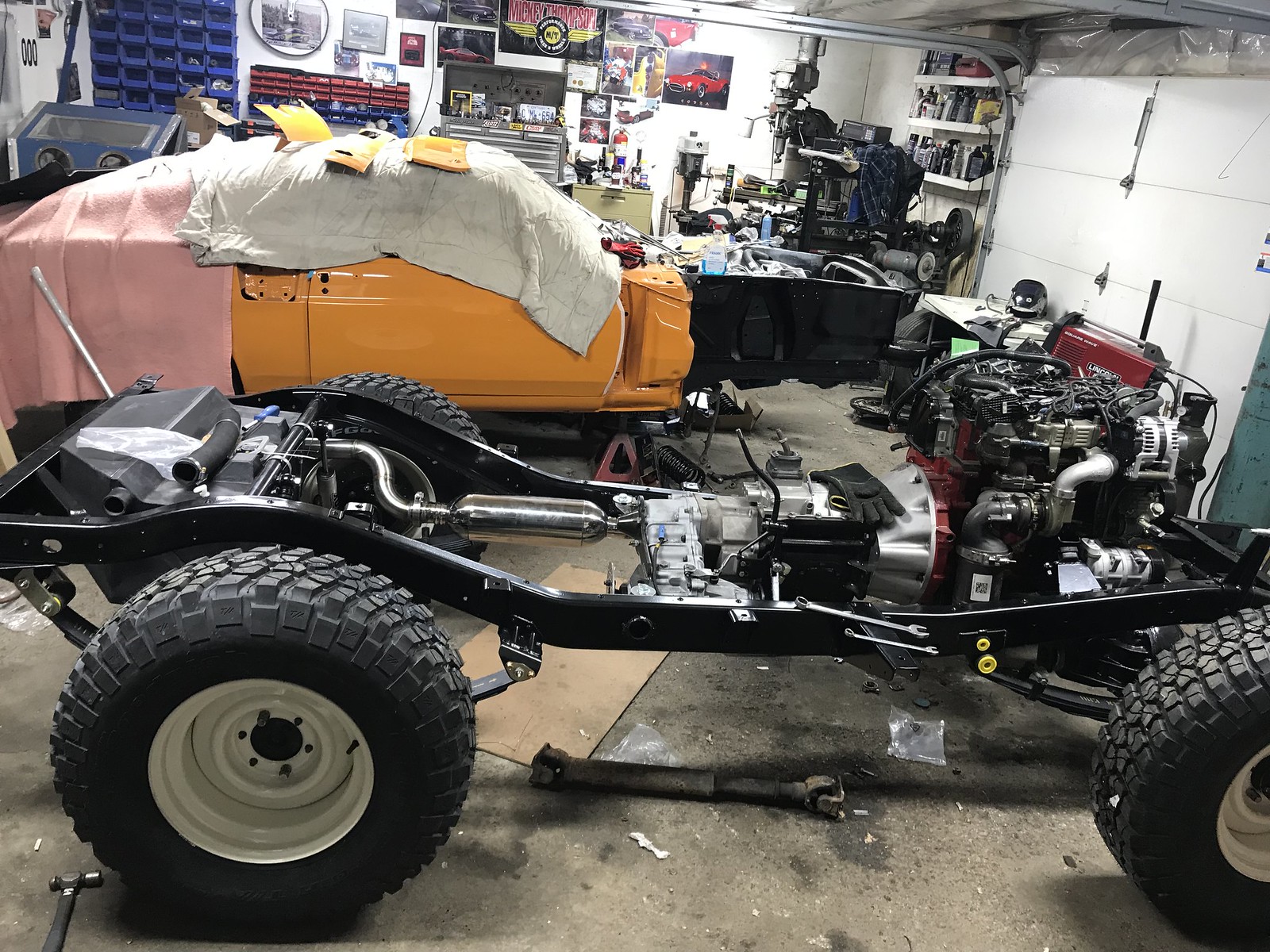

IMG_0955 2 by Steve Heck, on Flickr
It seems from this picture that the back transfer case just barley clears the floor brace, do you plan to do any mods to the tunnel cover?
