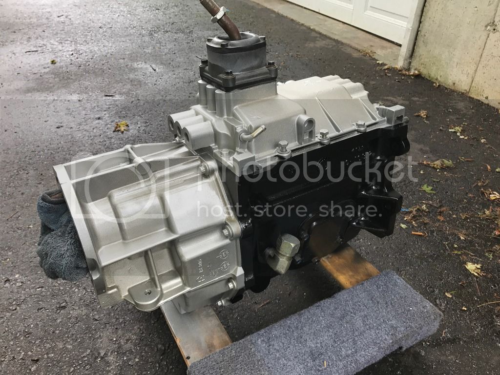

Cleaned up and painted the 2 year old NV400 that took me 8 months to find

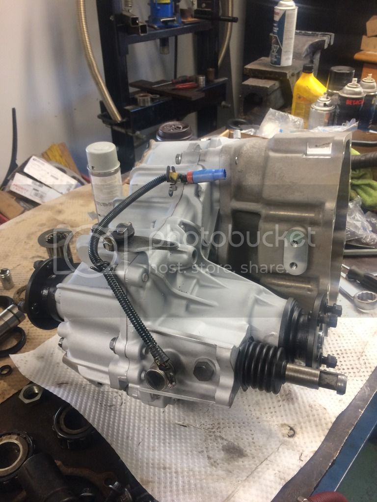

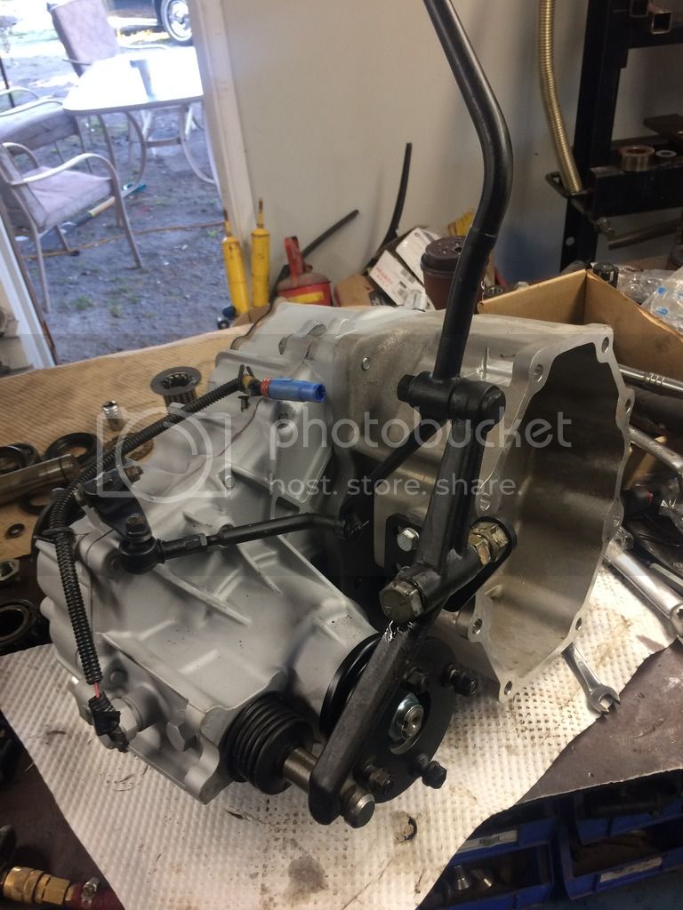

Tore down the NV4500 for a full rebuild and repaint
