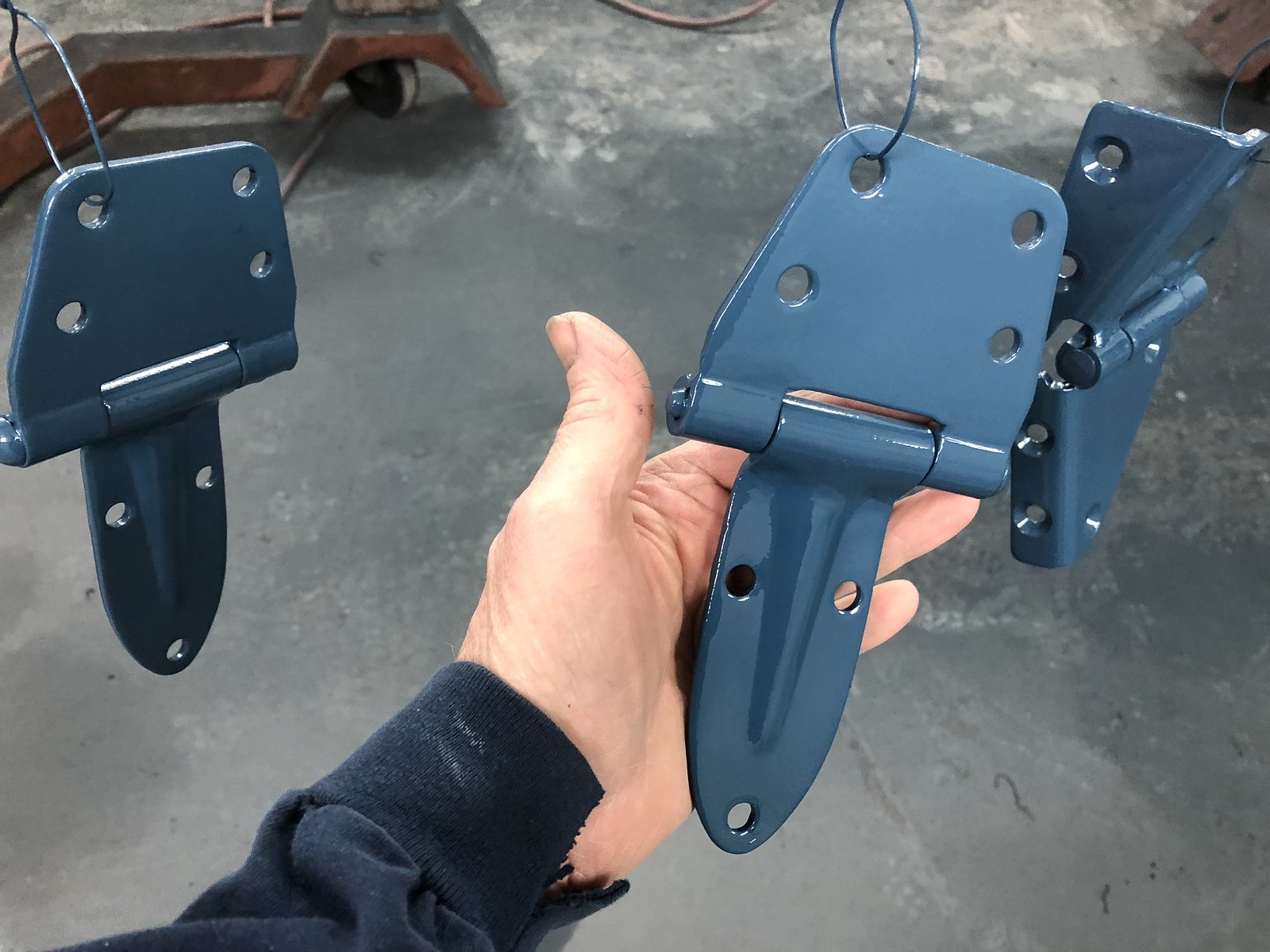

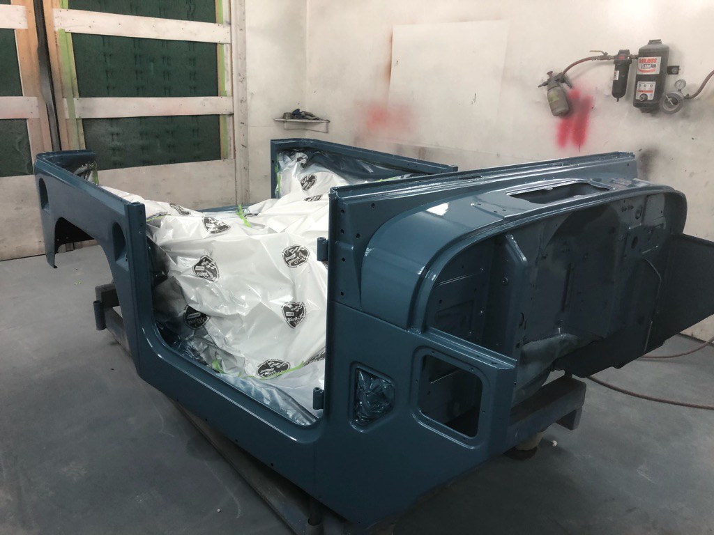

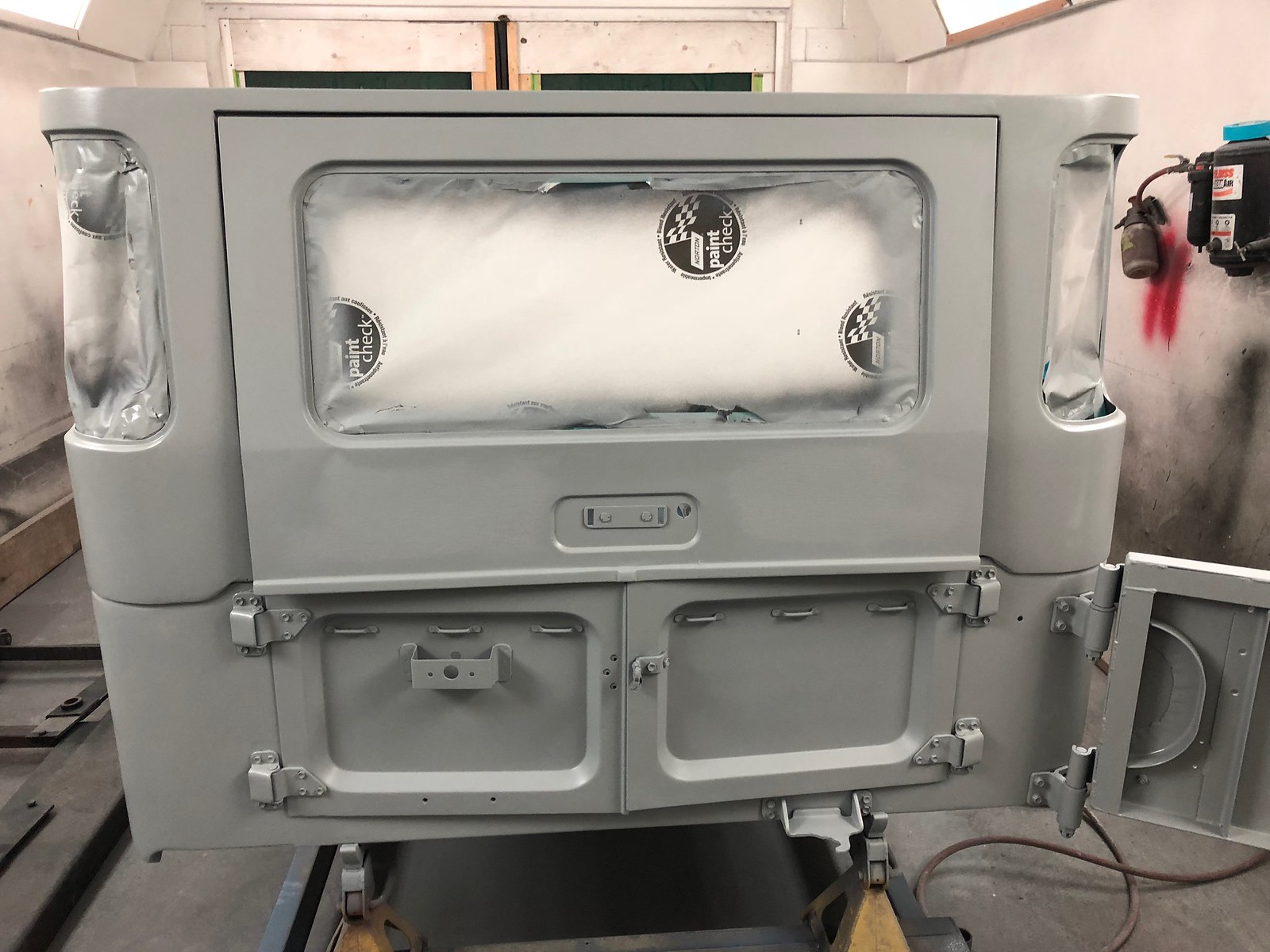

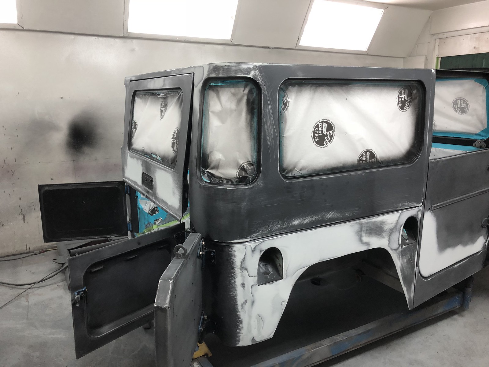

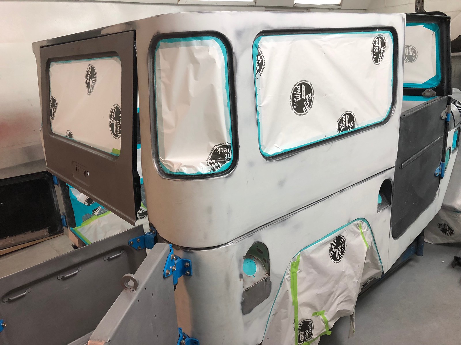

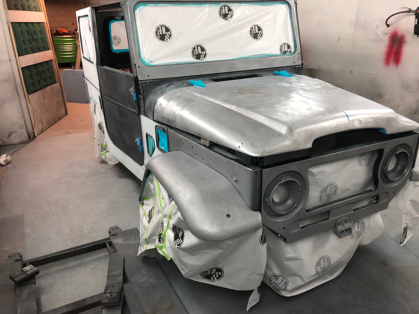

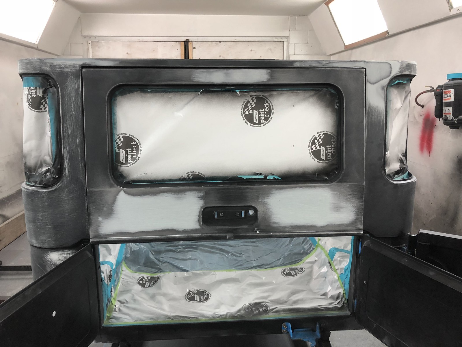

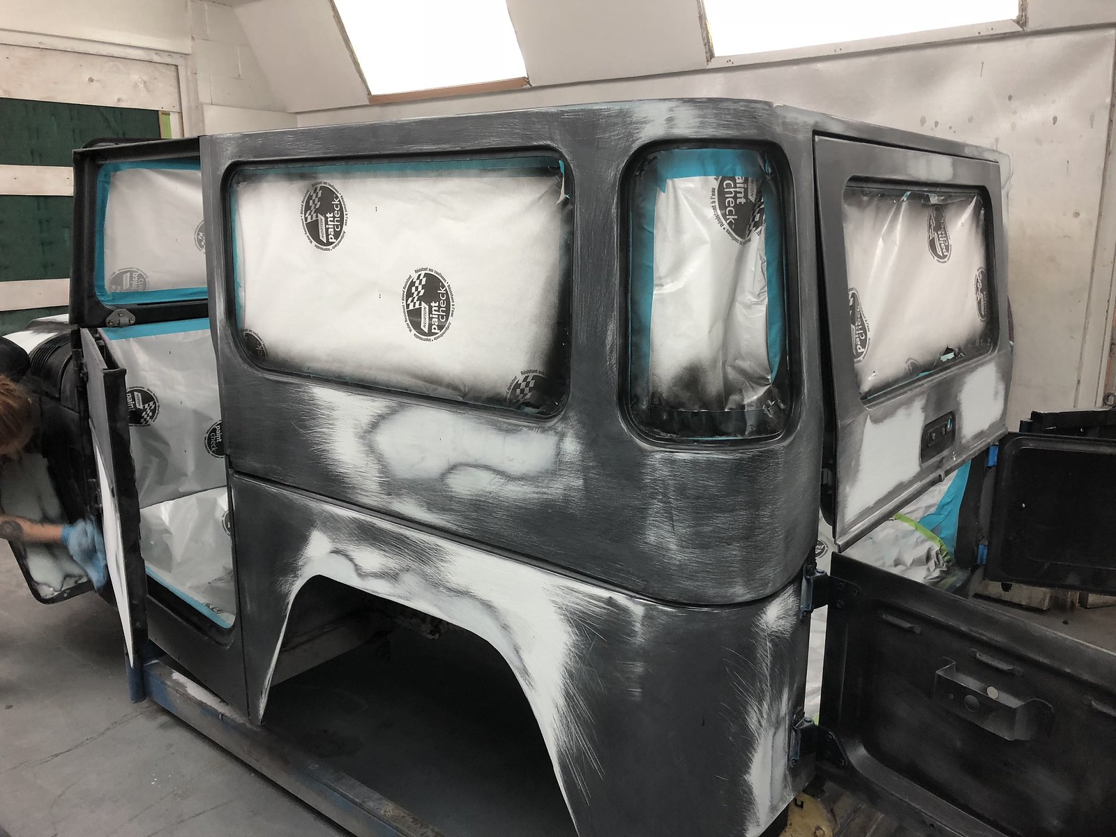

Update pics from the paint shop
IMG_0759 by Steve Heck, on Flickr
IMG_0760 by Steve Heck, on Flickr
IMG_0763 by Steve Heck, on Flickr
Cool stuff! Are you going with something other than the ‘66 axles with that torque?
Have you placed your motor yet? The one I'm building for a customer is challenging - the NV4500 plus split case combo is 4.5" longer than an H55/split case. I'm looking at serious mods to the tunnel cover and floor pan to make it all fit. I've got the motor back quite a bit to make room for an intercooler/condenser/rad/fan cooling pack and pushed up pretty high to optimize clearance to the 3rd member. We're actually debating going back to an H55 because of all the sheet metal mods it will entail to make it fit and clear.

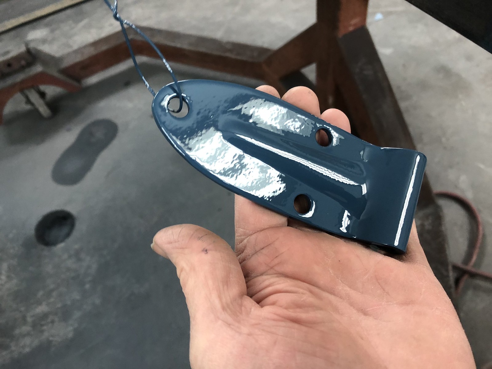

If your in the neighbourhood (Toronto) this March, this one and my grey one will be in the Motorama car show ride by side showing 2 completely different styles of builds

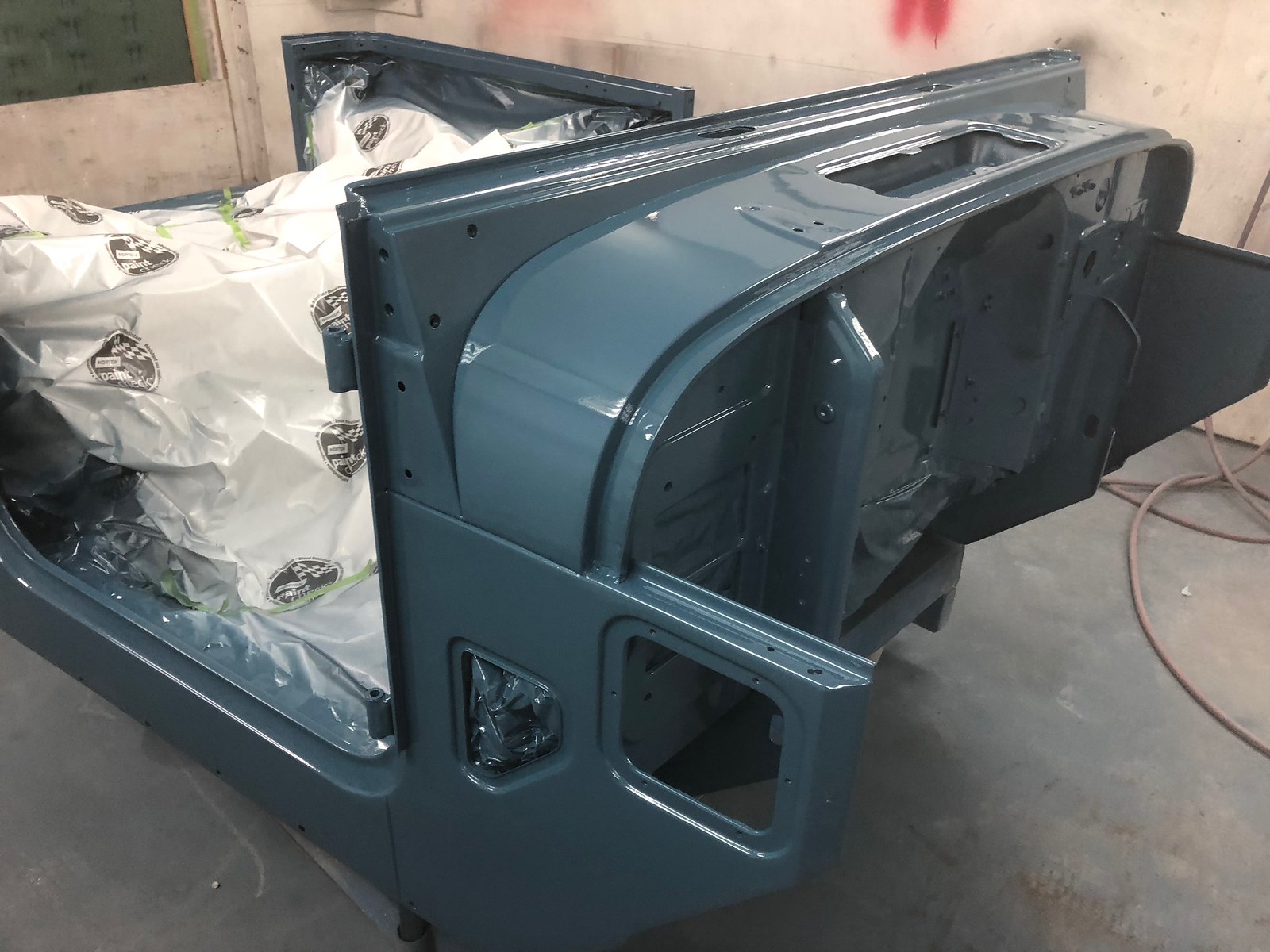

REALLY happy the way the colour turned out
IMG_1150 by Steve Heck, on Flickr
IMG_1149 by Steve Heck, on Flickr
I'm sure I can make a tour, I was thinking between that blue and the heritage blue for my blue. The 2.8r combo is going to be amazing, really interested on how that drives.
Color looks great!
