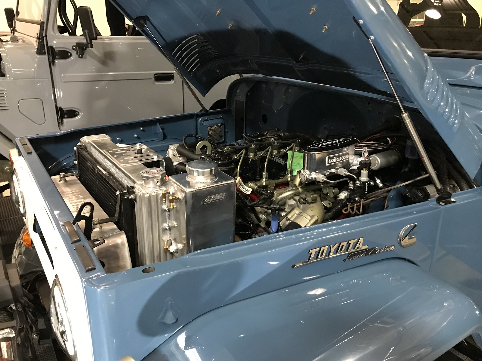

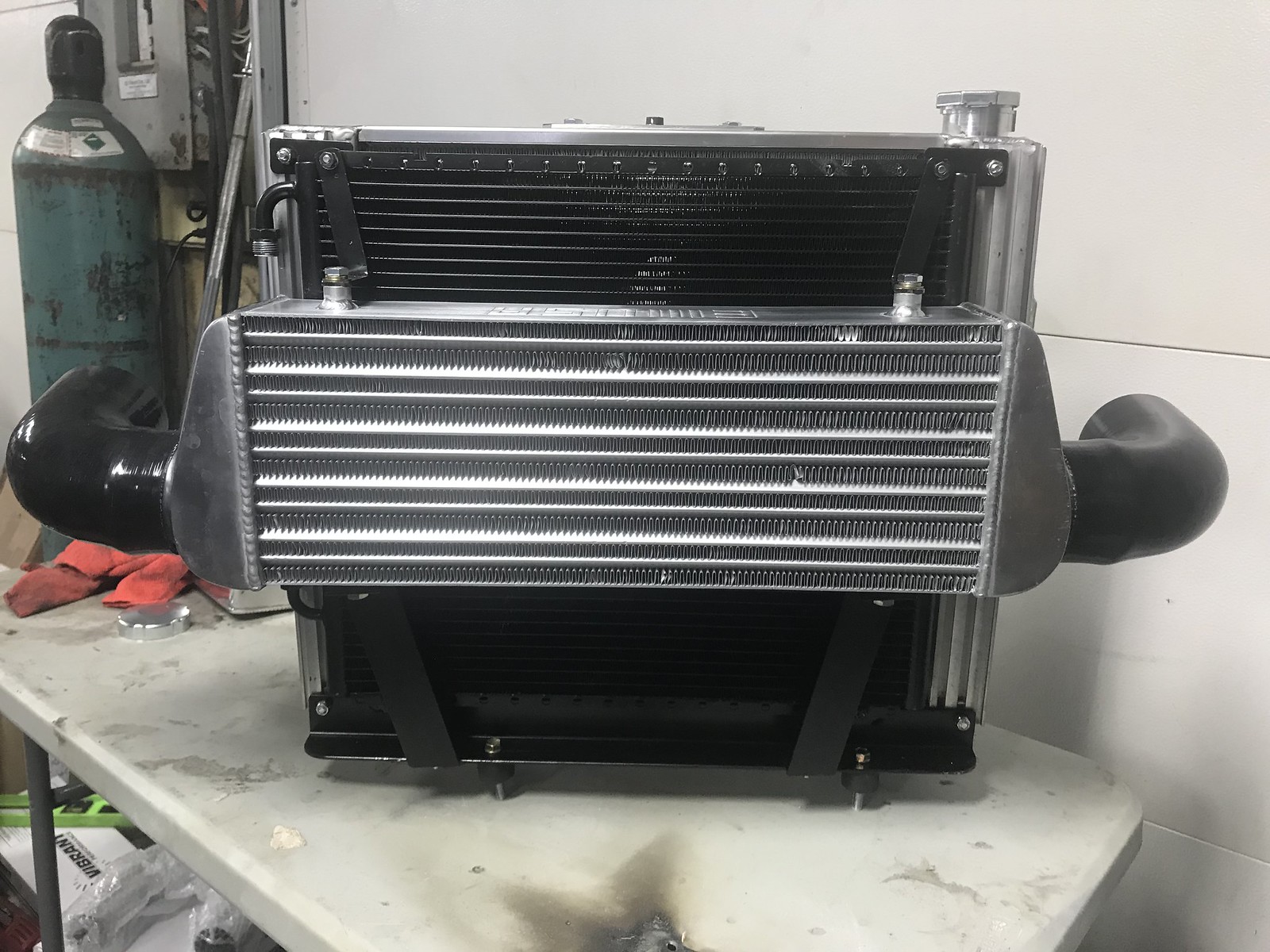

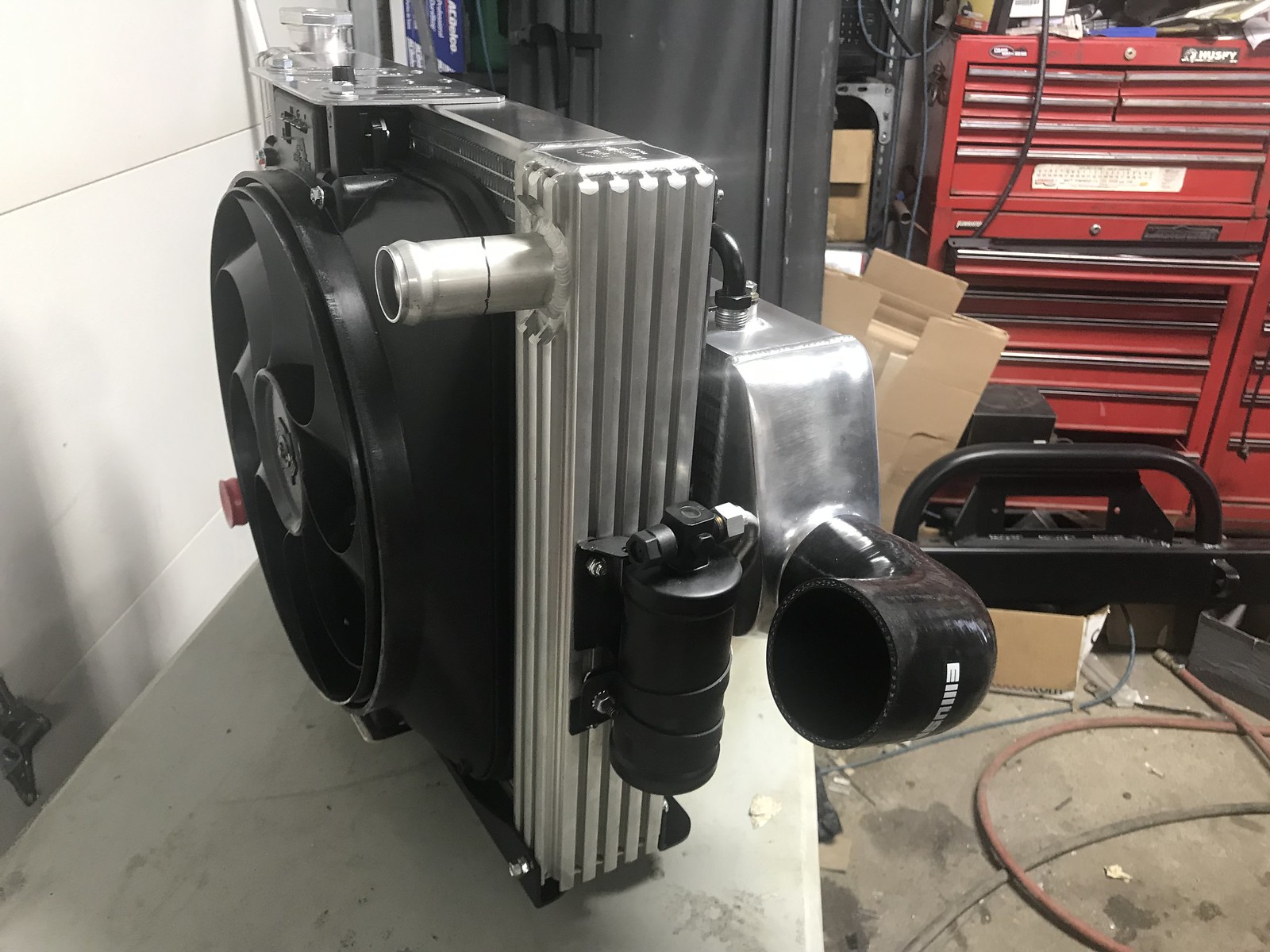

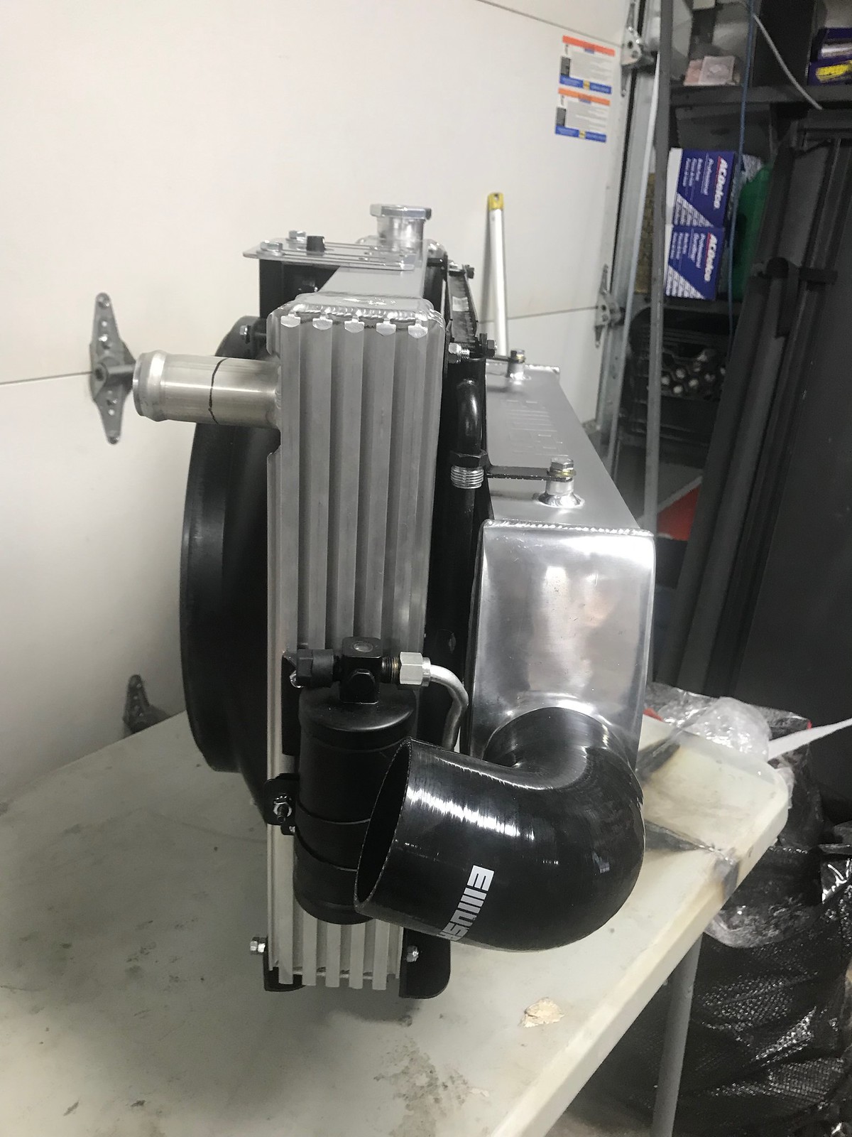

Ok guys, radiator setup is the Flex-a-Lite -51160R with the matching fully controllable fan
see pics below guys
Amico ... I am going to get back to you on those questions, some are extremely important and I want to talk to my mechanic to answer accurately
Arther ... I got the rear tank from Tojo products (Jim) , great tank but no internal pump. With the diesel R2.8 you do not require either an internal or external pump.
I went with the more expensive 80' series conversion ... again expensive but unbelievably good. I used the same system on my Grey 73' and it works so very well.
see pics below guys

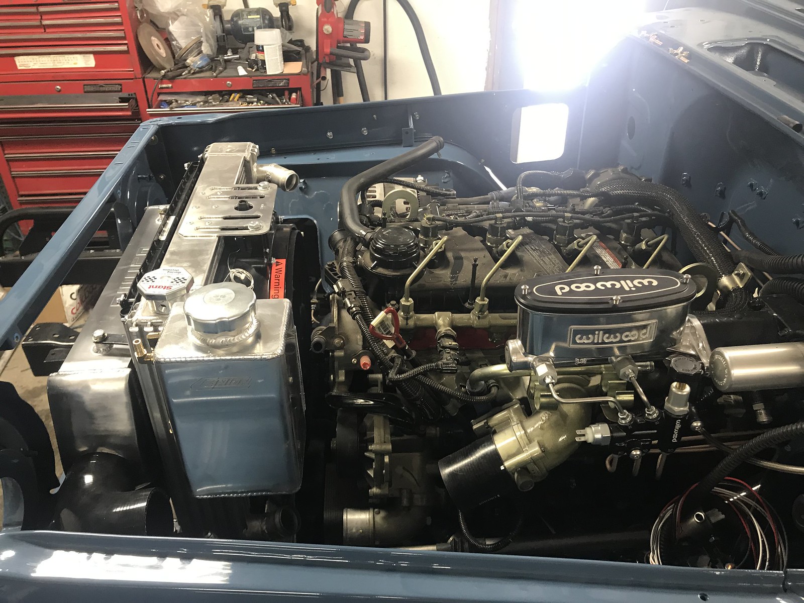

how deep is the radiator from the front of the intercooler to the fan engine side? any modifications needed to get it in behind the grille?
No, Frank the R2.8 is short enough to fit everything in, BUT you do need to fabricate a mounting plate that we attached to the original Rad mounting tabs because the assembly is pushed back beyond the length of those tabs.
