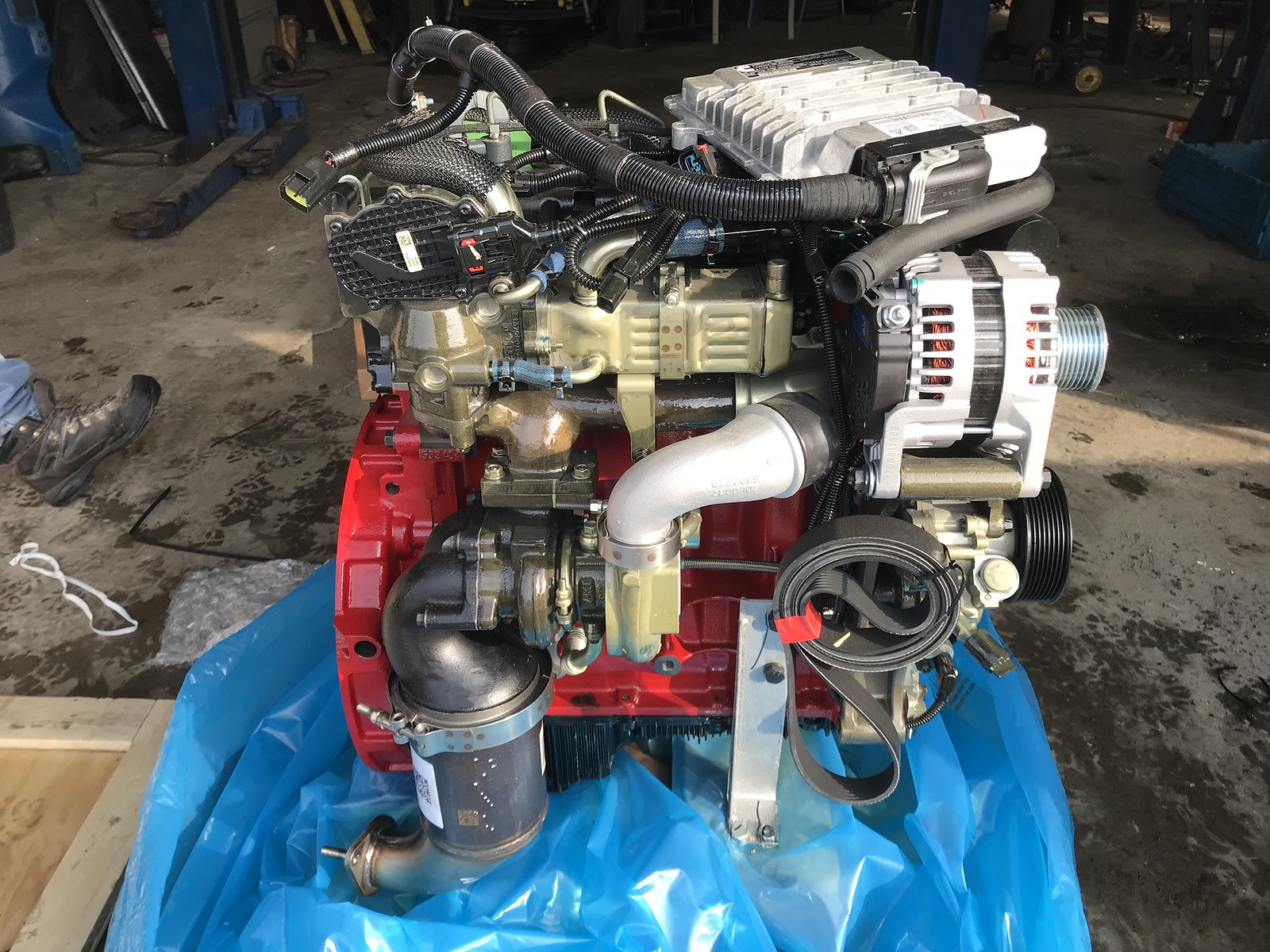

Crate Cummins R2.8 Diesel engine, GM NV4500 5 speed tranny, Toyota split case

Also interested in seeing you adapter setup for this combo, im on the fence between an R2.8 or a 4BT swap with an NV4500 behind it in the future
Beautiful work so far, looking forward to following this build.
How far back does the motor / trans and adapters put your transfer case?
Niagara Ontario here, thinking of a 2.8 swap down the road also.
Dont know quite yet but we will by early next month.
Guys I'll do my best to take lots of pictures and gather lots of details as I know a LOT of people are looking at this engine. Actually I've been exchanging emails with Tor over at TorBuilt and he's been fooling around with tuning this little beast of an engine and right now he claims he's putting down over 400 torque AT the rear wheels... thats seriously impressive
Stay tuned, If it can be done I'll find a way to do it LOL
Cheers
Steve
The 4BT is about 300 lbs more...not as smooth and quiet as the R2.8. But if you want a cheaper mechanical injection motor than its a choice.

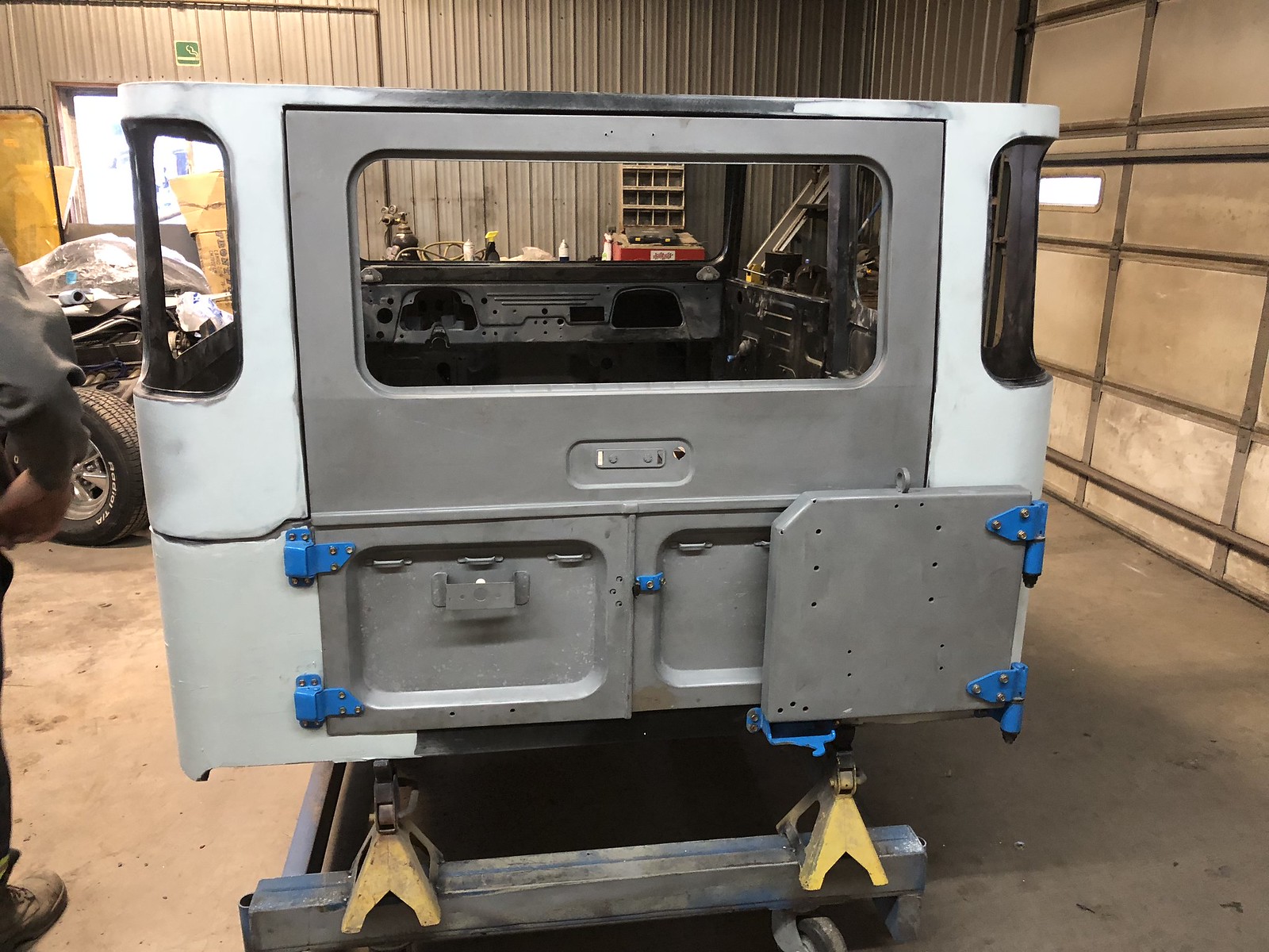

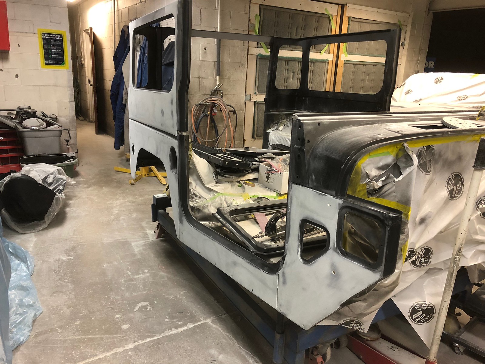

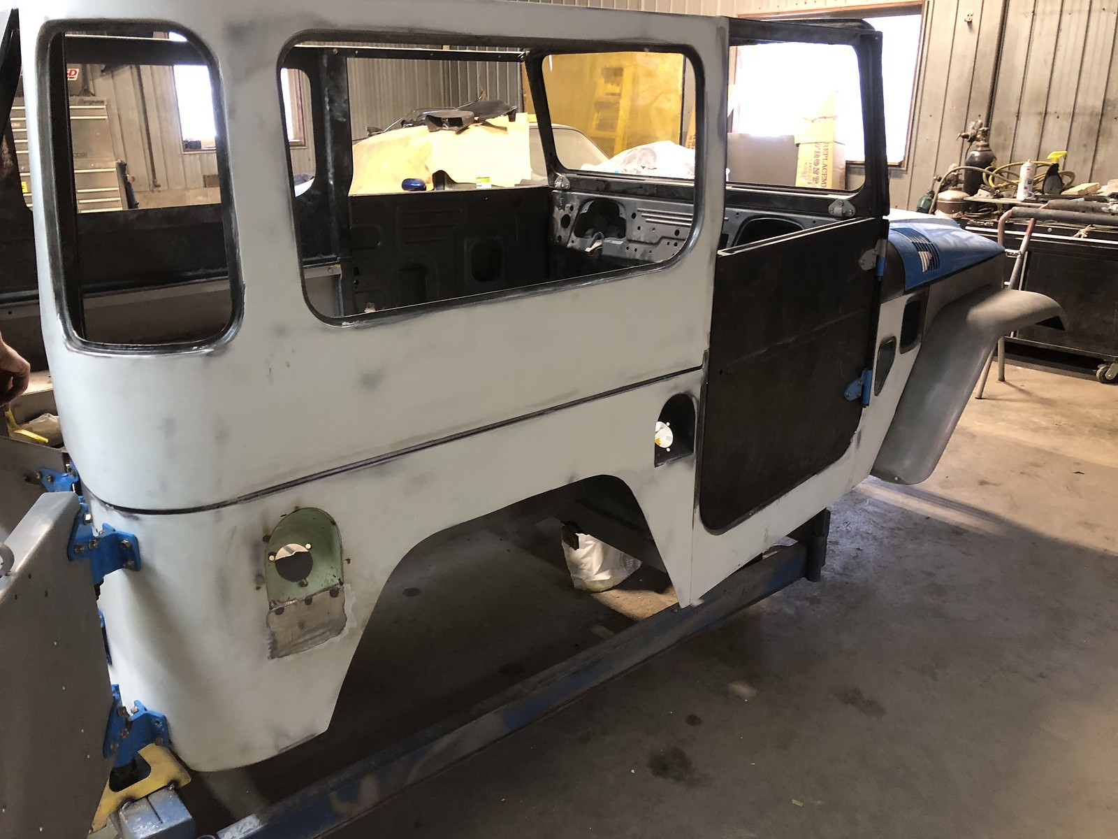

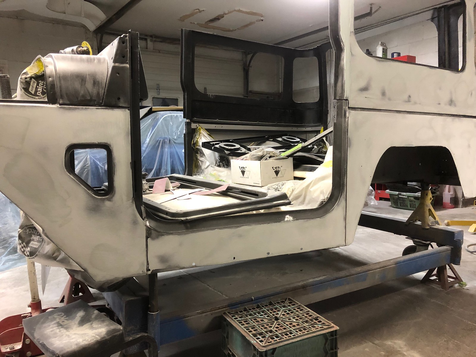

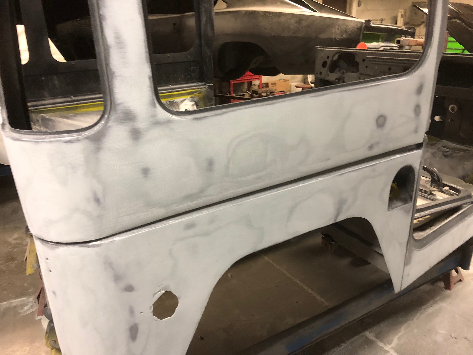

OK .. so we are moving ahead with the body, mocking up all the body panels and roof.

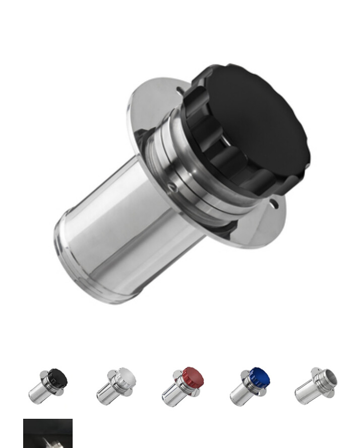

Again, BIG thanks to Riley for providing me with the correct filler panel pictured here below for the Aux tank. We were able to position it in at the same height as the front so it will look completely OE. This should be interesting with the 2 tank setup for the Diesel R2.8, we may be looking at getting 600 miles out of the dual setup. we'll see ..
Also, so people dont 'freak out', this is a completely original 66' and I WILL keep it that way visually on the exterior as even I believe that this is the proper way to build this truck. All body panels, glass etc. will remain original, everything else will be brand new.
Also, NEW custom wheels are finally on the way and I cant wait to show you guys. I worked with the guys at the Wheelsmith in California to build me a set of 16x8's with OEM hubcaps and I think they will be great !
IMG_0675 by Steve Heck, on Flickr
IMG_0676 by Steve Heck, on Flickr
