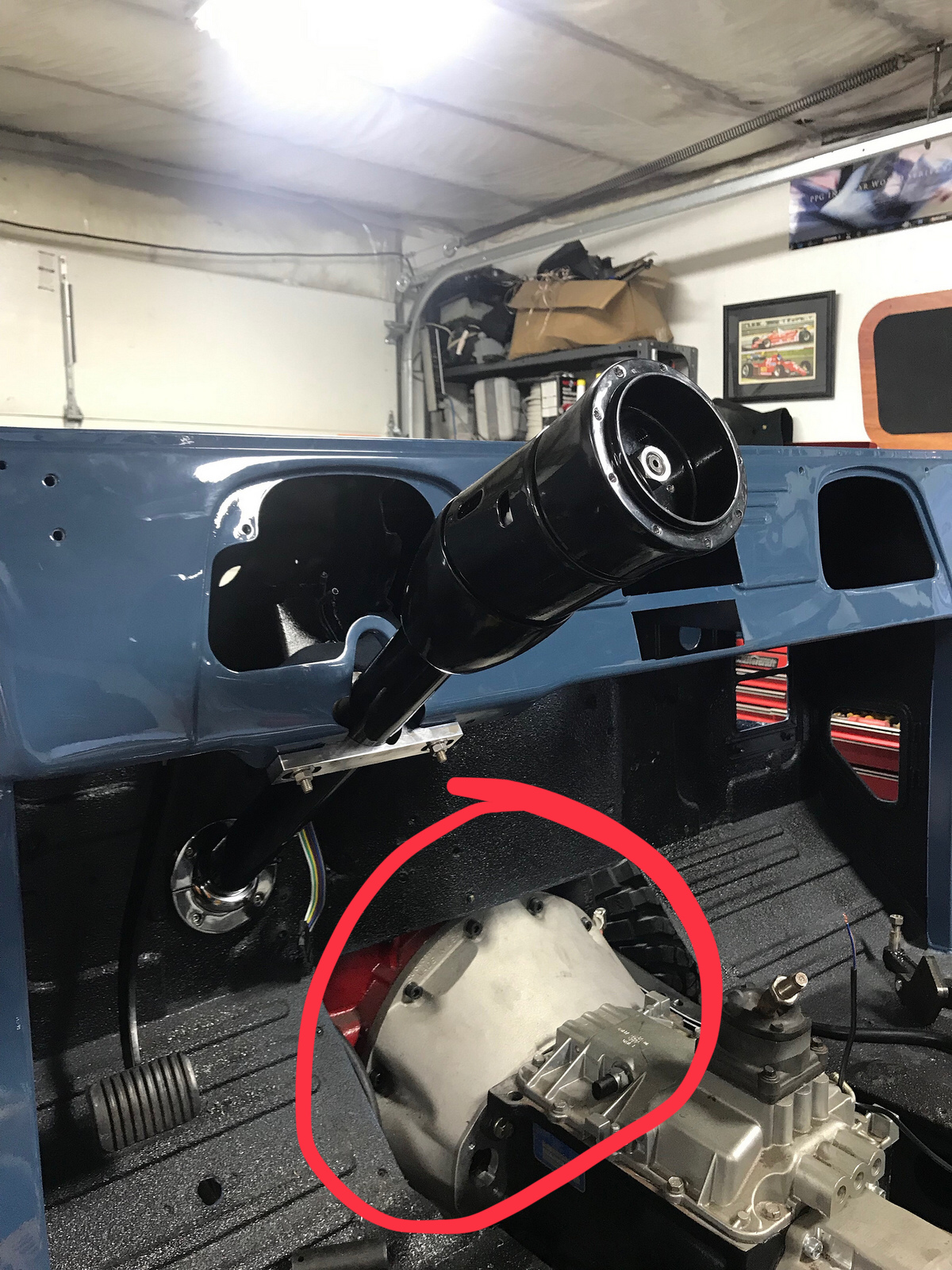

I'm underway on almost the exact same build for a customer, I'm going to get a thread going one of these days. Are you aware that there's a direct R2.8 to NV4500 bellhousing available from Quickdraw?
2.8 R to NV4500 ADAPTER KIT WITH MODIFIED FACTORY FLYWHEEL (Fits CUMMINS 2.8 ) | QuickDrawBrand.com
I just got all my parts in last week, picking up the transmission tomorrow and then the fitting begins.
Oh crap !! That would have been nice, im already in deep with Axis and Advance Adapters ... too late for me but for others this will make it less expensive and cleaner !
Thanks
Steve
Did you end up going with the QuickDraw bellhousing?
Are you satisfied with the overall length of the drivetrain package with the QD bellhousing, NV4500, AA extension, and split case?
