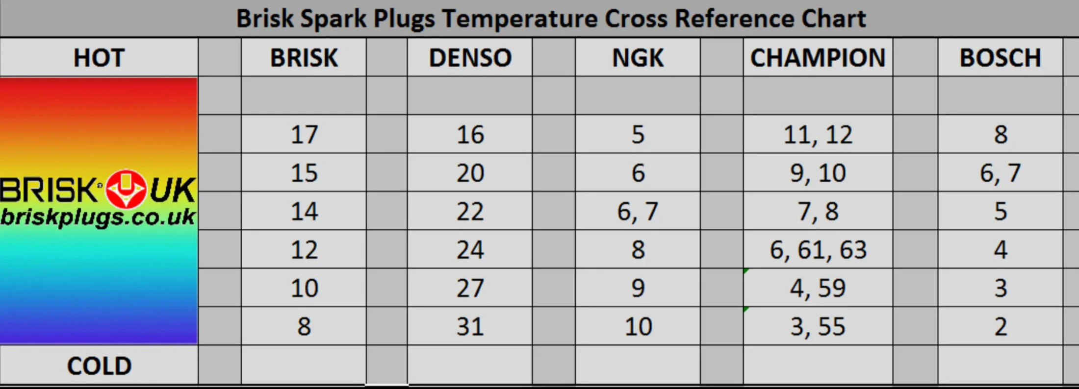

One thing, I installed new Denso 5303 plugs just before I noticed the problem. I thought it was the longest lasting OEM type because iridium but maybe I should’ve had done some research and not just rely on Rock Auto? I love that place and kind of blindly trust what they recommend for maintenance parts. It looks like it’s a hot running plug at a 16 rating.
Anyone else running the 5303?
