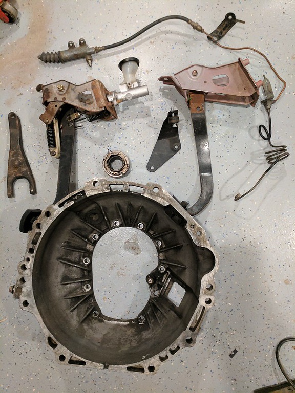

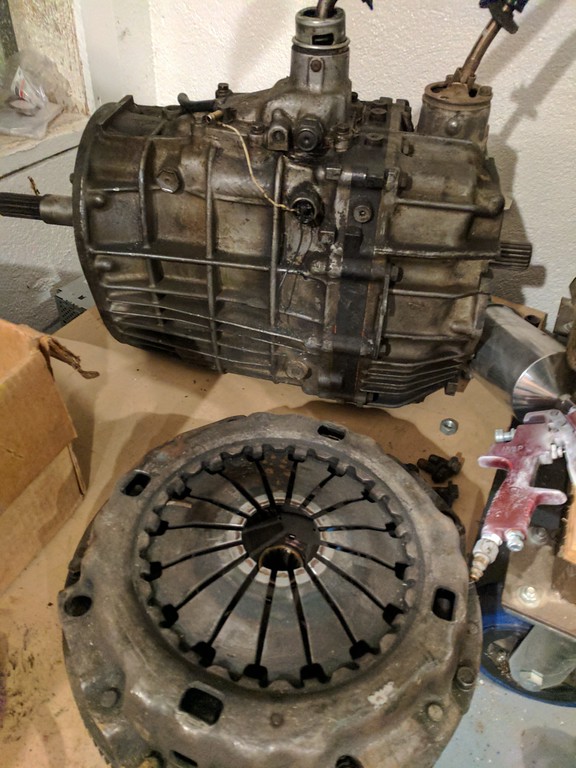

The first step, and possibly the most difficult part, acquiring the parts! Thanks to @FloridaFJ80 for bringing a beautiful, used H151F back from Columbia, bringing the pedals and accessories, and shipping it to San Diego for me! If you want pricing on that, ask him directly please! I've had it for a while now and am finally ready to get going on it.
The first order of business is to rebuild everything and collect any missing parts. I need to acquire rebuild kits for the master cylinder, slave cylinder and the H151F itself. I plan to rebuild it myself, I'll take lots of pictures.
I know I'm in need of at least the following:
  • Master cylinder o-rings
  • Slave cylinder o-rings
  • New release bearing
  • New friction disk
  • Clutch switch for electrical connections
  • Rebuild kit for H151F (bearings and synchros)
  • The pin and clip that attaches clutch pedal to slave cylinder

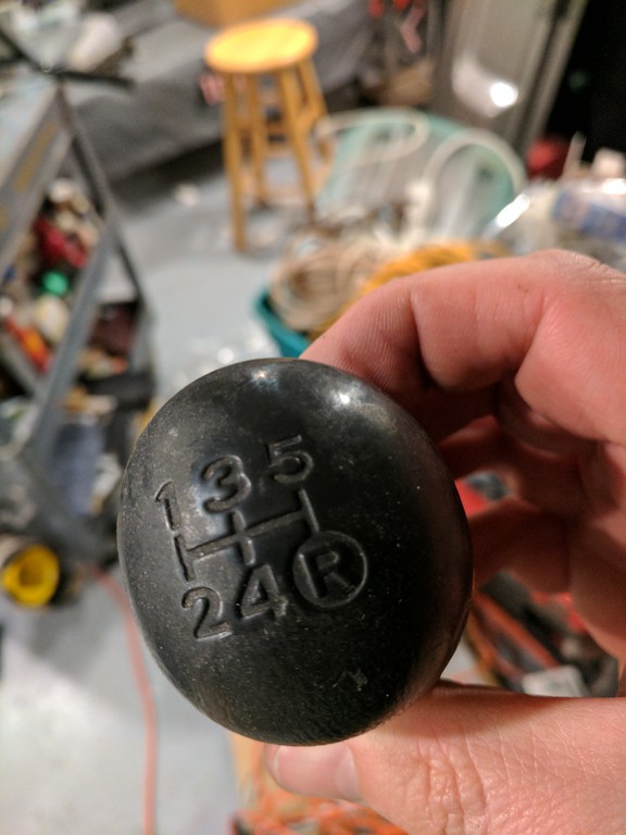

  • Shift boot(s) for tunnel
I also need to have two OEM shafts modified to the proper lengths, so a couple of used drive shafts to do this two are in order. Anyone in southern California have some drive shafts they would part with?

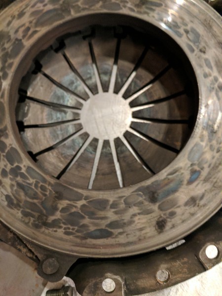

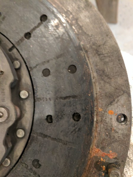

I will inspect the clutch components I have and may use them initially if they look good. the parts don't look very worn are very worn and I don't think this unit had a lot of miles on it.
<EDIT> Should look at parts before I think not worn!

Frankly I never would bother with a used clutch disc, and even the pressure plate is a wear item - so inadvertantly I think you got lucky.
Go in with new wear parts, you'll be $$$ ahead vs. going back in for a $100 disc & having to crack open the powertrain (but I'm somewhat lazy, I rather spend for new clutch parts so I have that peace of mind over time under the 80, or any vehicle really).
