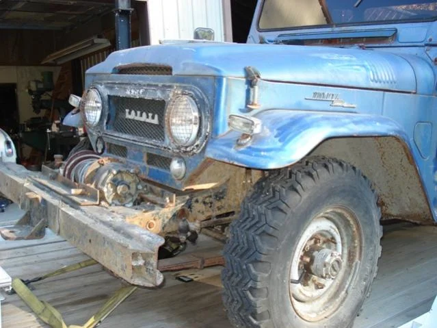

Show us some pics of your ride and the PTO in question!
Here's a pic the day I brought it home. I have it out of the truck now.
Would need a better picture of the winch to tell but it looks like it came off of a 62 or earlier cruiser. Those only had a single roller on the bottom. The later ones had four roller fairhead and support bars running to the back angle iron. The windshield in the truck is earlier than 66 also. Is there a round brass tag attached to the VIN plate? Pretty common to have a cruiser titled as a later year back in the early to mid sixties.
