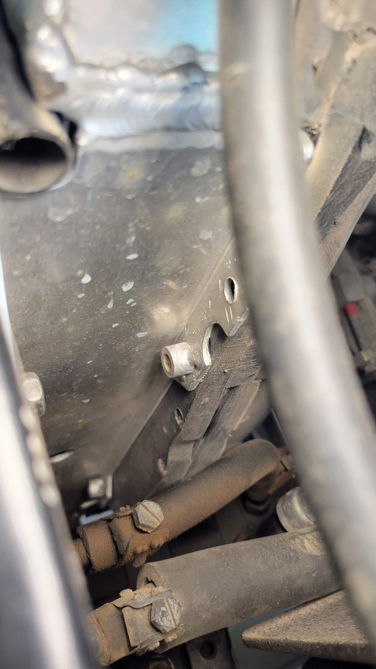

I purchased the radiator and the 2RZ shroud, would you have more pictures or info on the modifications you made to the fan shroud.
Sorry, life got in the way for a while there. It's hard to take good pics in there. I saw somewhere someone asked why I chose a 3.0 2wd over 4wd radiator. It was because it has a lower vertical height and doesn't hang down as far as the 4wd radiator therefore also better suited to the 2rz shroud. I used either 1/2 or 3/4 ABS black silicone and some rivets.
