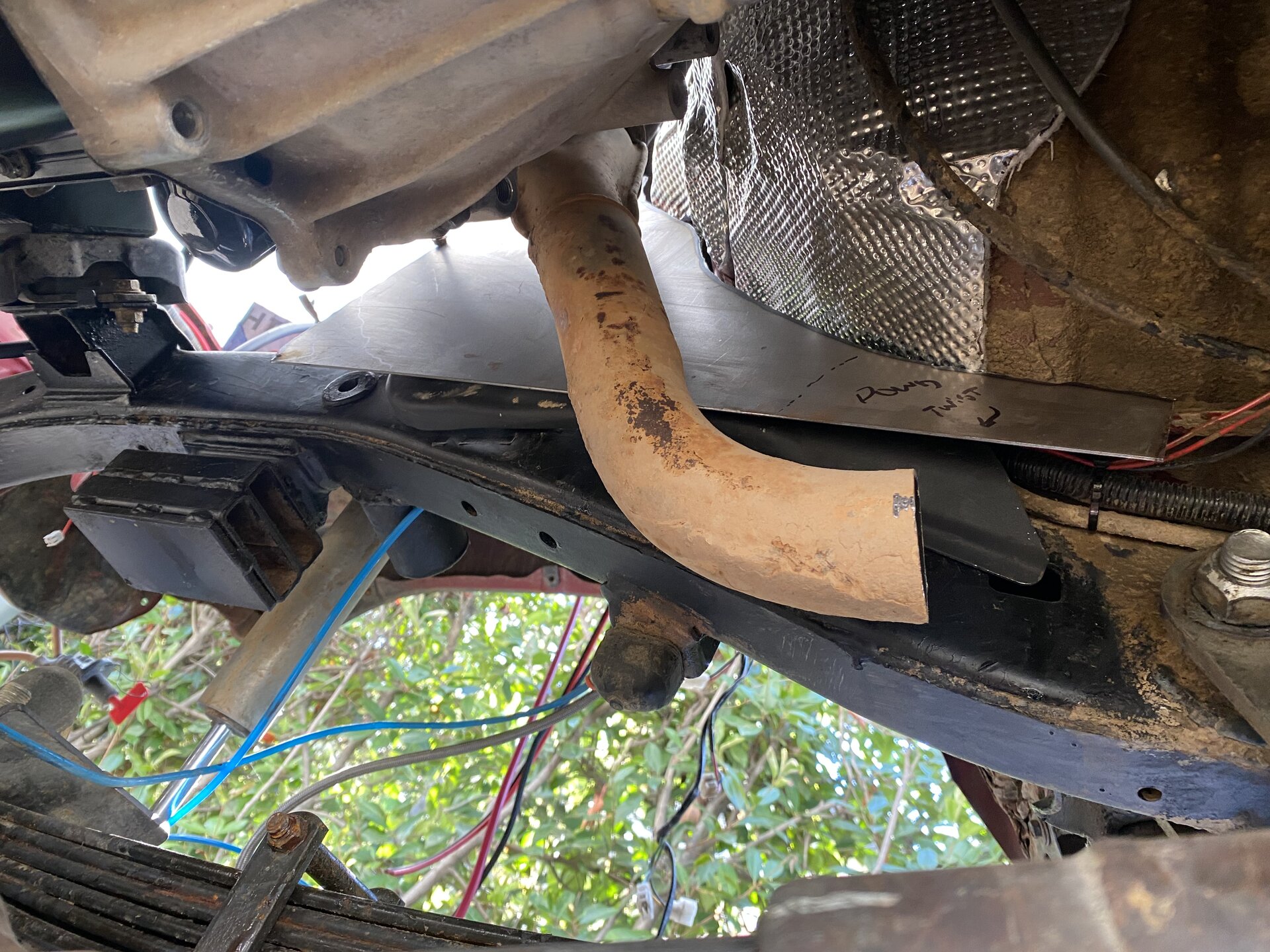

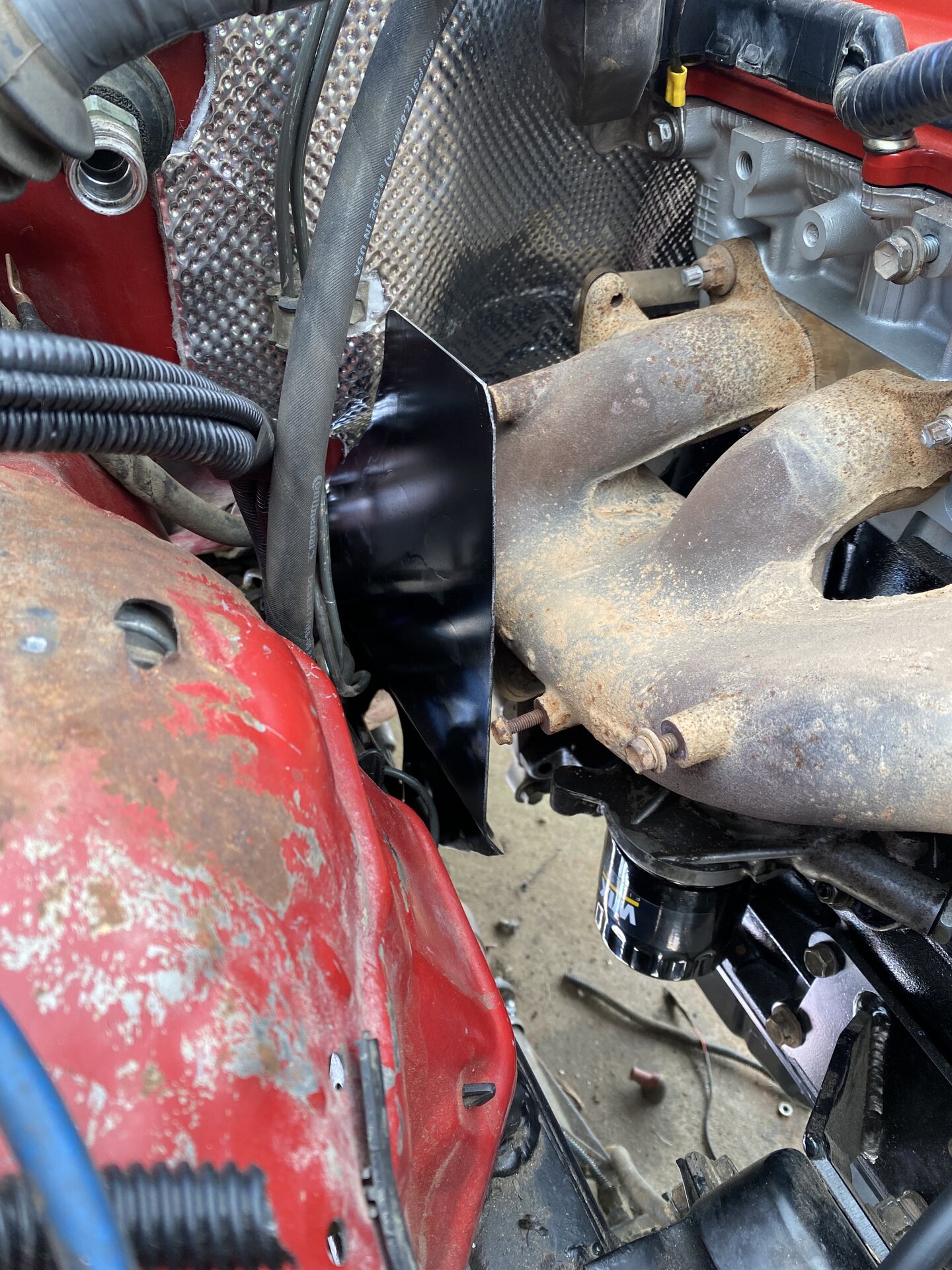

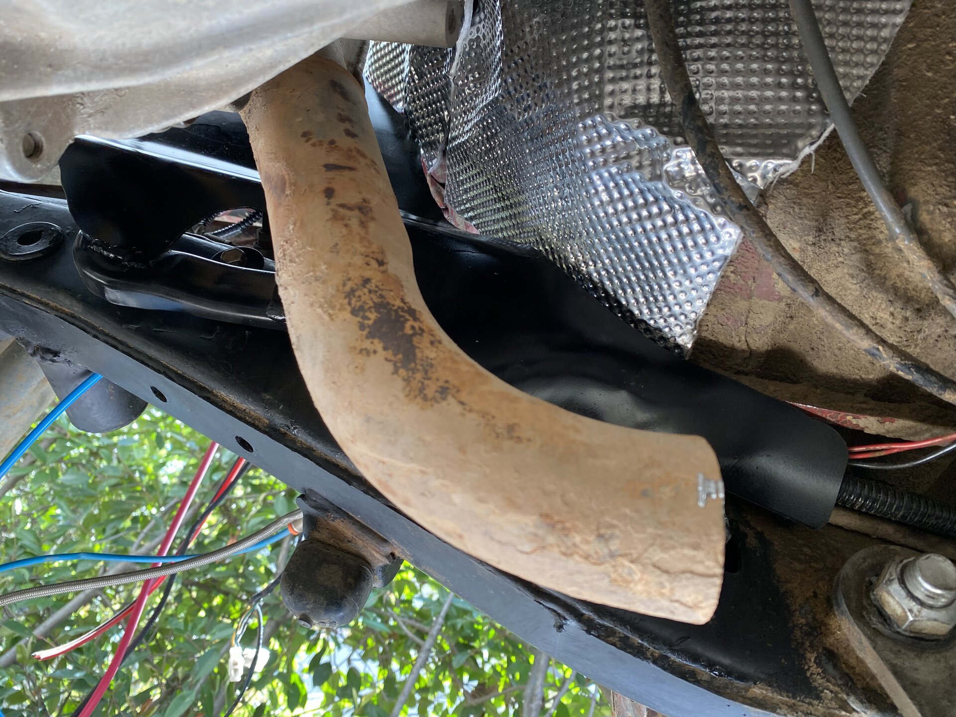

And fabbed a heat shield to protect the fuel line/brake lines/wiring harness running near exhaust.
Put a few bends in it and tacked it to that existing small heat shield that was bolted to frame.
Finished and painted
Looking at ideas for heat shielding, I’m debating between sheathing the lines or doing a heat shield out of aluminum. What thickness of metal did you use?
Sorry for the delay, I was on a road trip to Astoria. Damn I miss Oregon...
Anyways, I used 16 gauge for that shield because I had a lot of it laying around. Personally, I think the shield is good there over just sheathing. There are brake lines and depending how you run your fuel and electrical lines, those are present also. The ORS harness runs fuel pump wires down that way. Maybe some other wires I am forgetting. The shield gives a nice protected area. I haven't sheathed the speedo cable yet, but need to.
I did have a passenger along during my last snow run and there was pretty significant heat on the floor board he was feeling. I am thinking more heat shielding down there along the floor board would be nice. It's on my to do list.
I ended up copying what you and Liveoak did with the heat shield. I still have some extra stuff from the firewall to put on it to help as well, I appreciate it. I’m hoping to avoid heat issues in the passenger side as much as possible. If I have to I’ll add some heat insulation under the carpet to help out.

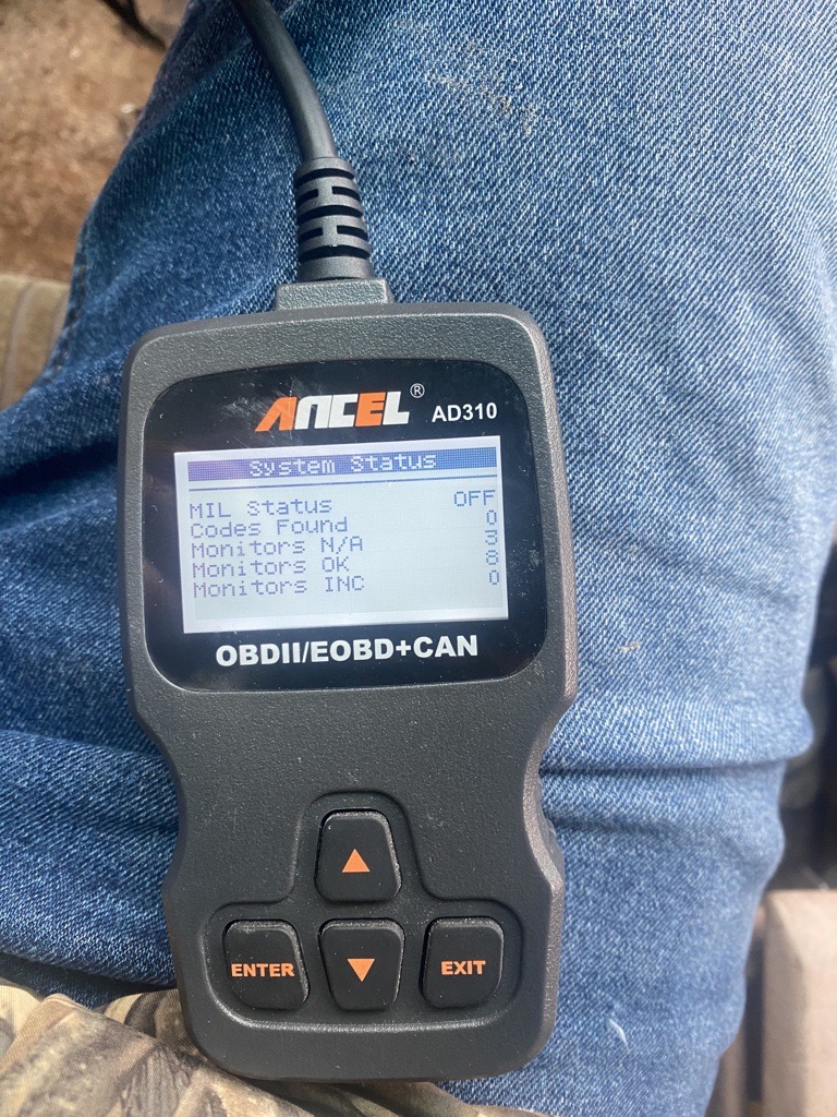

Good new is aside from that everything has been running well. I have been driving a bit here and there. Finally got the Evap Monitor to clear. That's all 8 without any codes! The smog referee wants to see pictures of this along with all the swap items as a prescreening before an appointment. So time to get cracking on that to get this thing stamped off as kosher.
