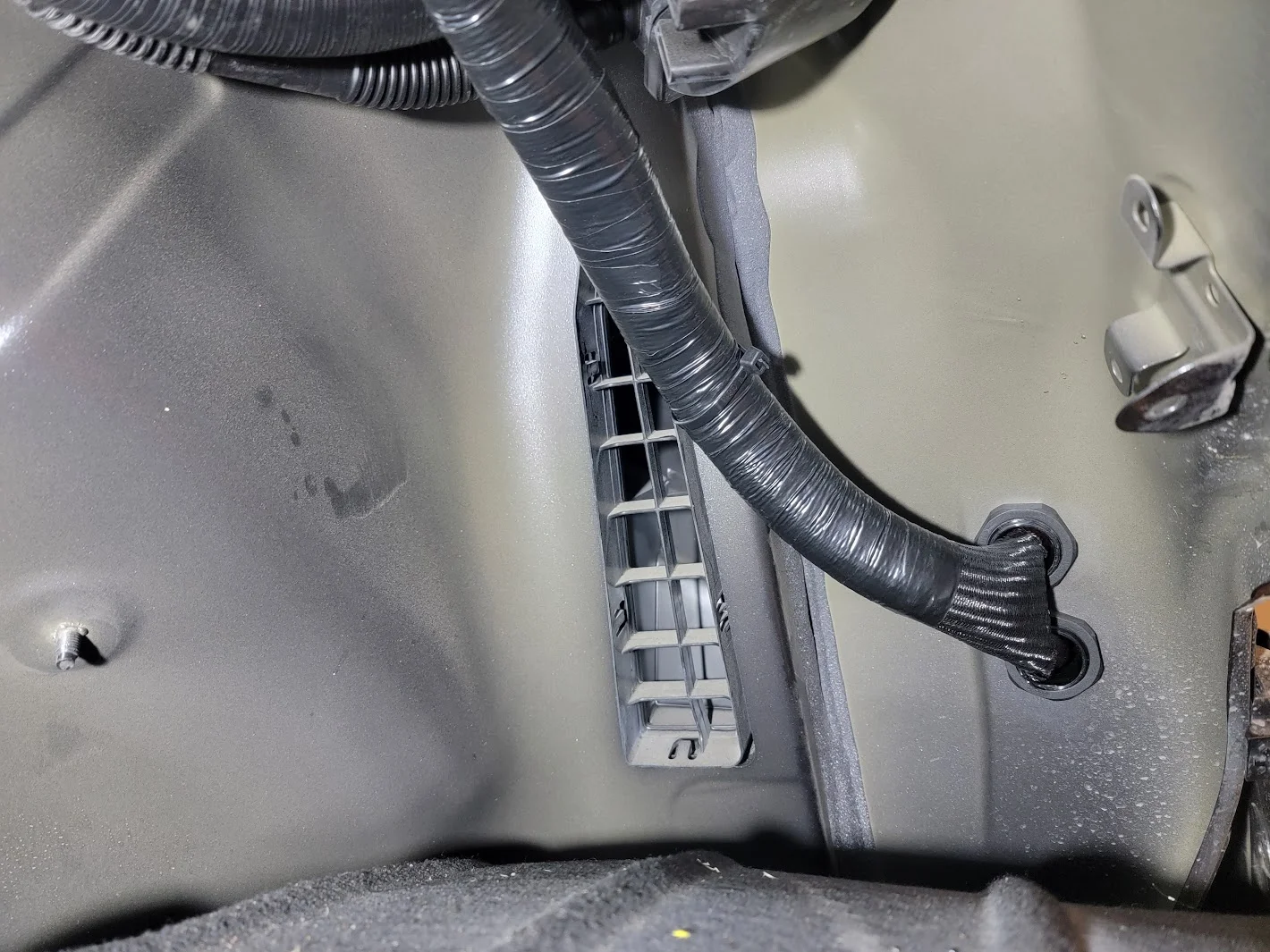

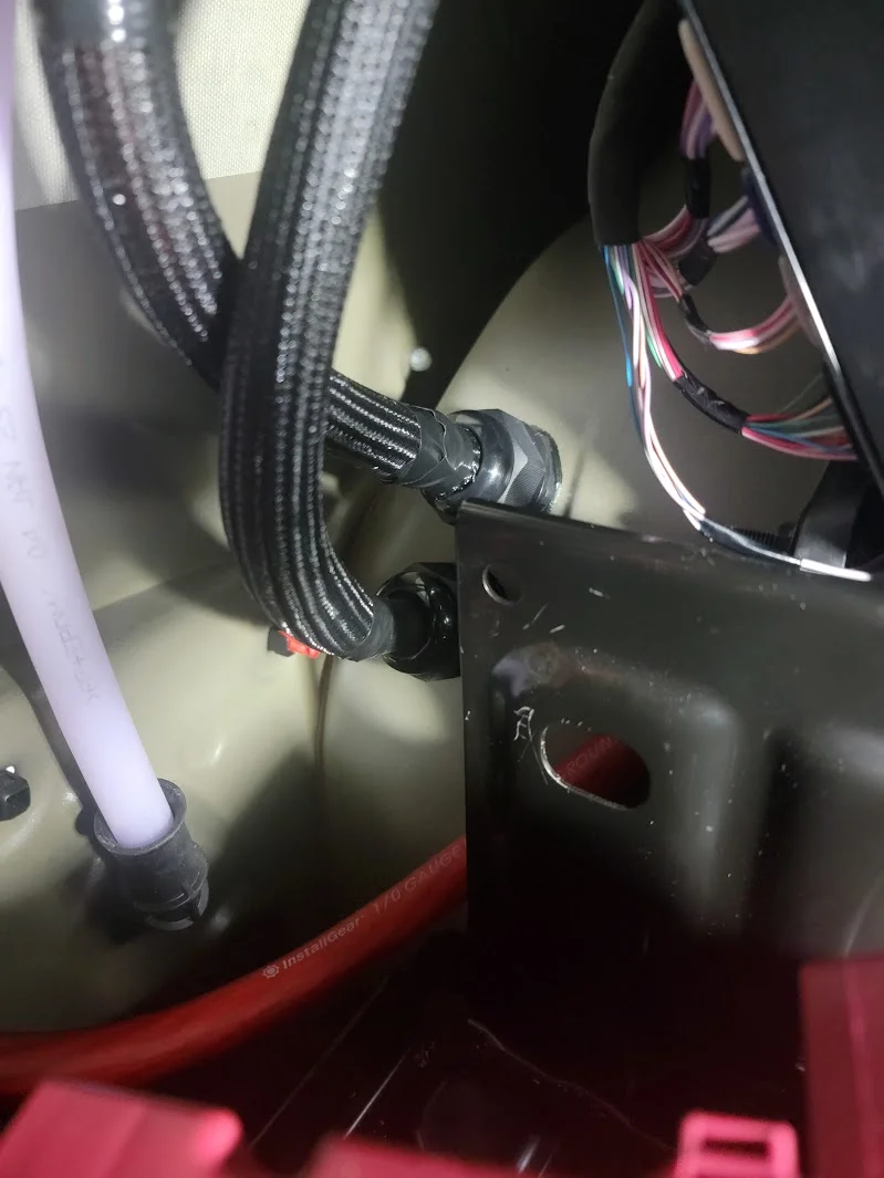

I drilled two holes for grommets in the driver side rear wheel well, between the battery and the rear of the well. They are large enough for 1/0 cables to pass through.
The outside of the wheel well here, showing the liner dropped, but there is a large amount of dead space when the liner is pinned in place.
In case you're curious, the cables then follow other cable tracks to the frame rail, follow the top of the frame rail under the body, then jump into the engine bay once the rail reaches the opening. I used this to connect a power system in the engine bay for winch and air to two 500Amp continuous duty solenoids on the main battery since the 3rd gens use current sensors between the negative terminal/ vehicle ground and positive terminal/vehicle positive and they would fail under heavy winch loads.
But more to your questions, this turned out to be a fairly clean way to pop from inside the cab to under the body. You could easily route it from the rail rear to the hitch area if you want an external connector, plenty of surface area to mount a solar in and power out.
