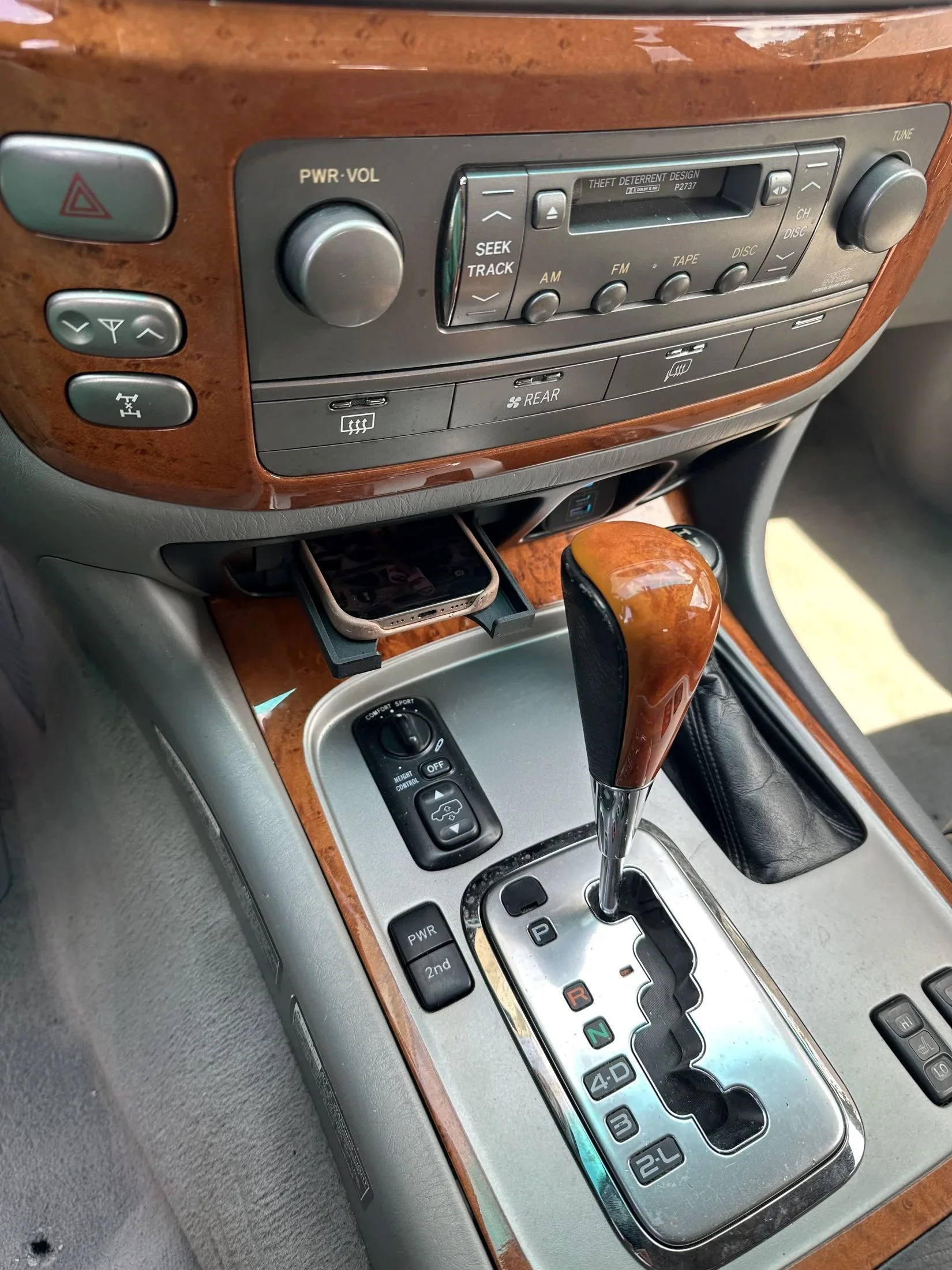

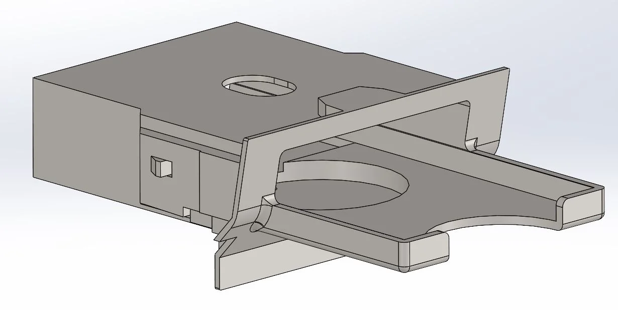

Looks like this:
Or, installed:

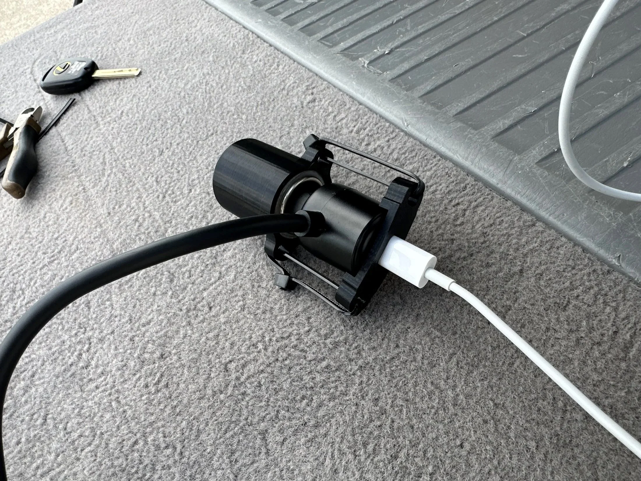

Removed the cigarette lighter from the dash, and came up with this contraption to keep it from loosening behind the dash and prevent any shorts

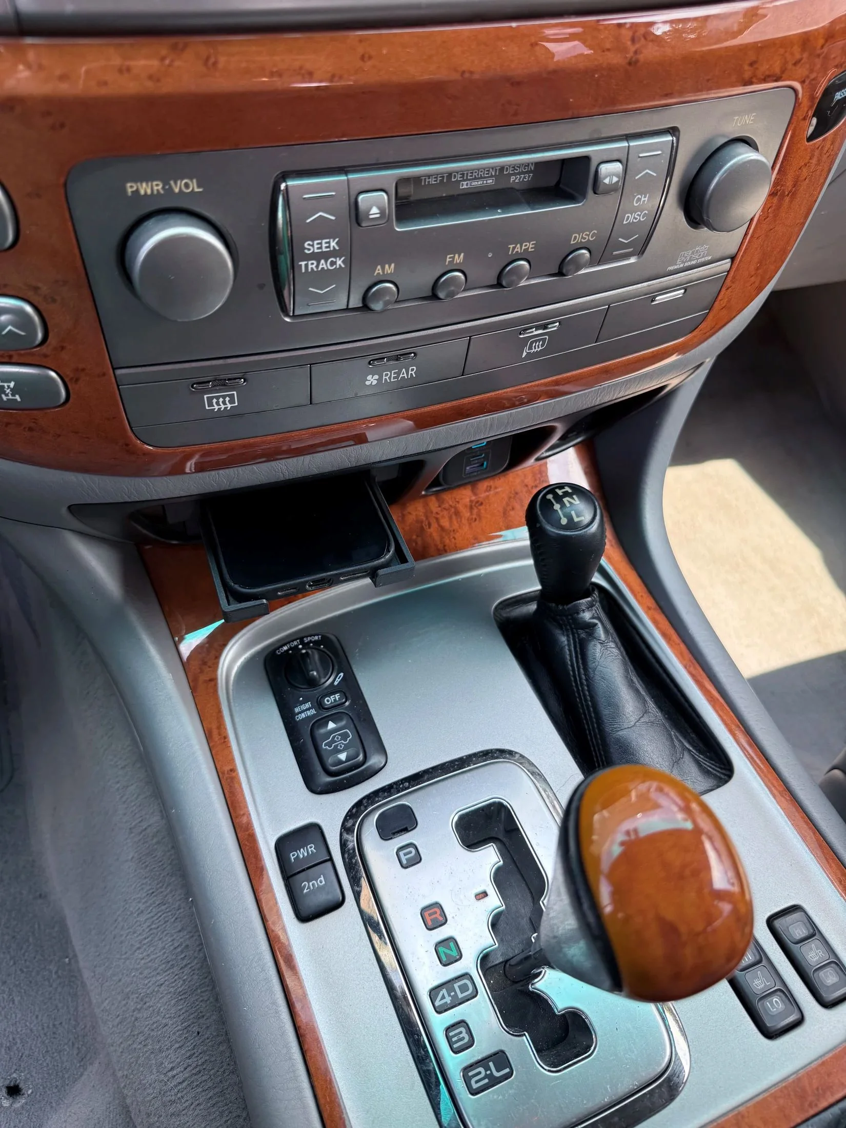

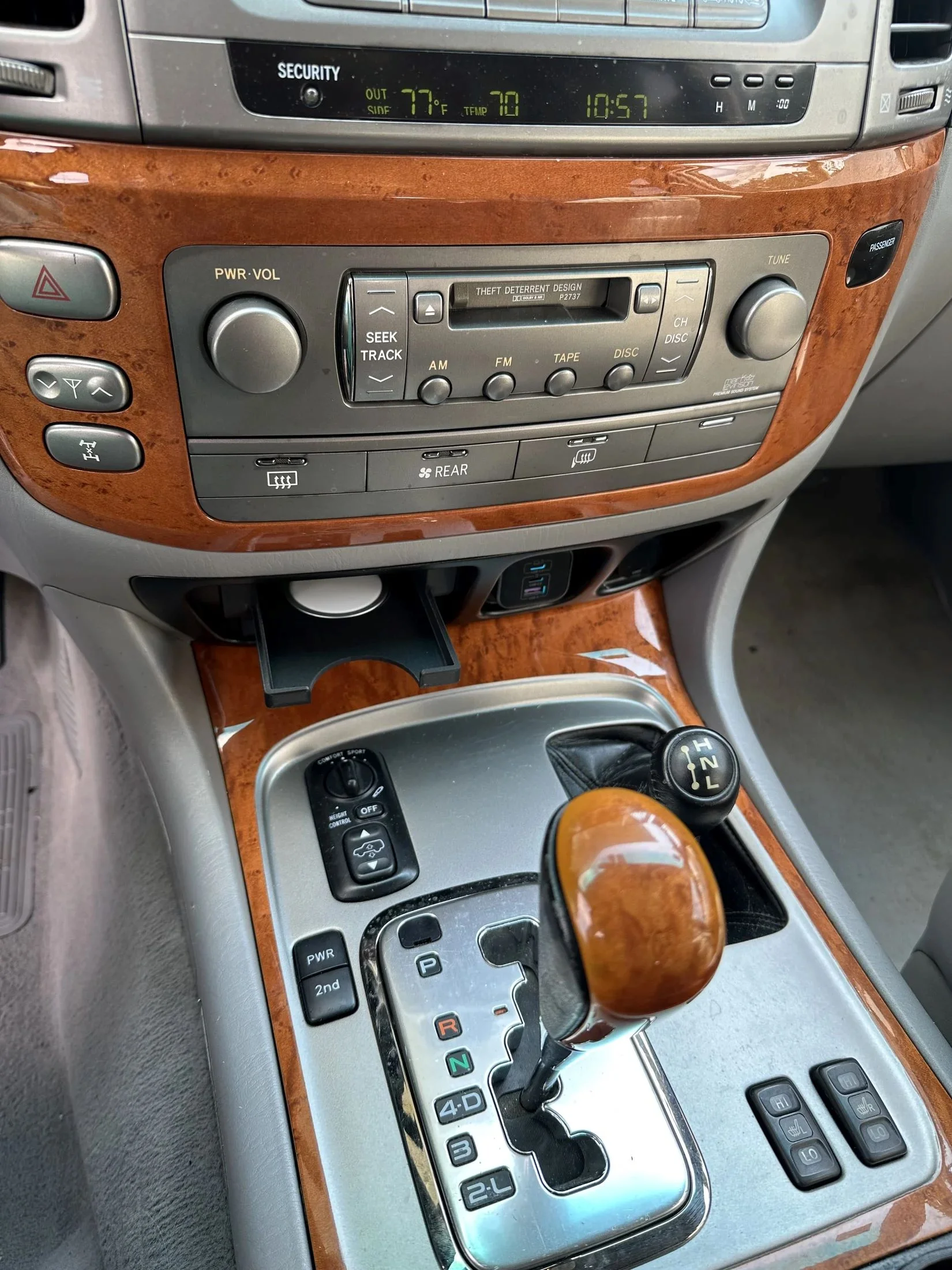

Tray with MagSafe puck

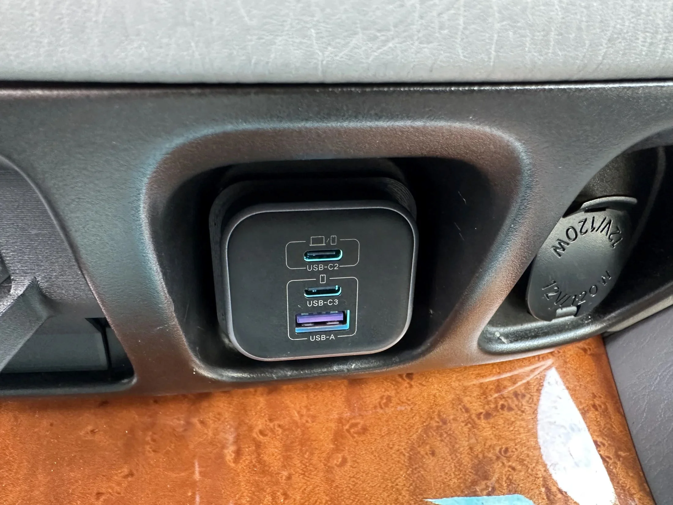

150W GAN charger that should be able to power ~anything to replace the cig lighter I removed
With my Pro Max sized iphone
With my wife's normal size iPhone.
All on ignition switched power, so it can't drain the car battery.
