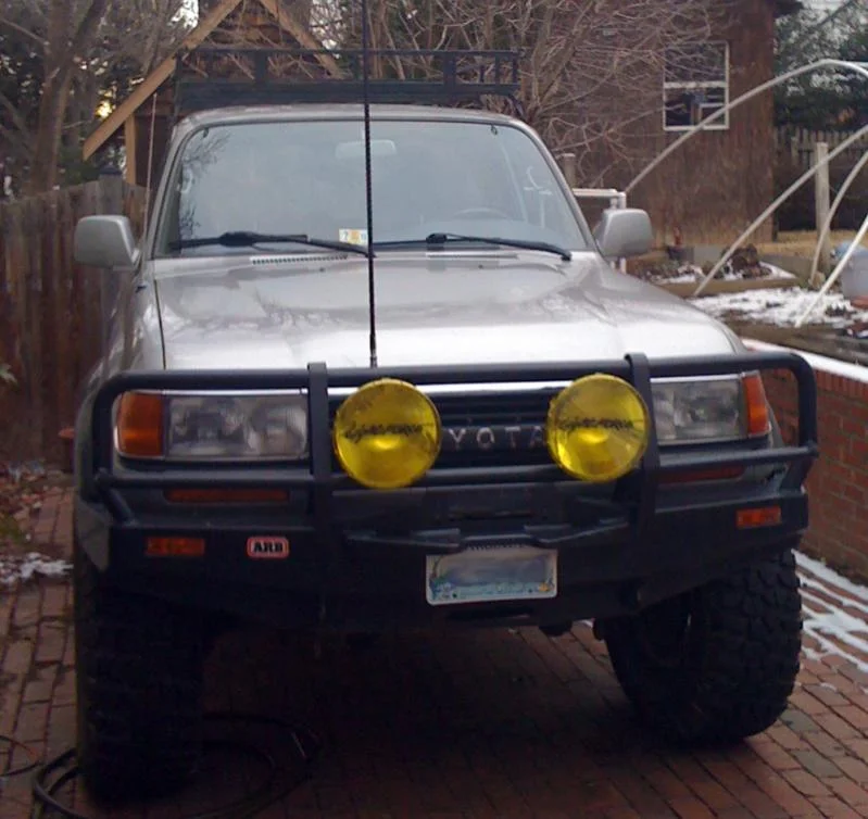

Post up some pics of your truck. I would like to see what you have. My tires (from the BFG site) are .4" smaller but 1" wider.
thanks for the link. I don't have any action shots - just a profile:
attachment.php
and head-on via this attachment. your 16" version definitely shows more sidewall area.
I'll go take some snaps in a bit, I drove it into the 'city' today, I don't usually do that.
