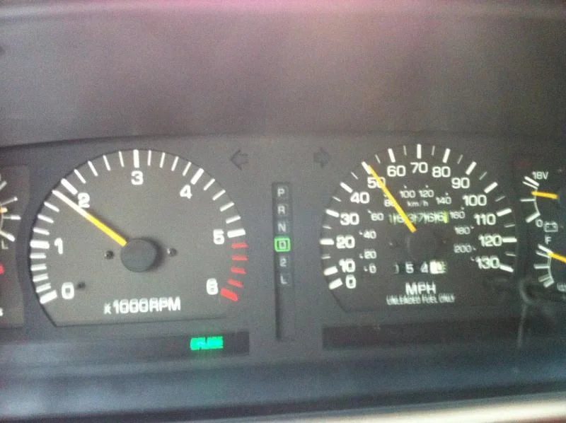

Here is is RPM wise on the road. Speedo shows 51mph, GPS shows 60 mph.
RPMs are 1800-1900. Pulls just fine without lugging in OD.
